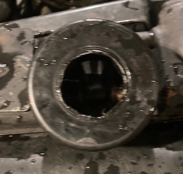

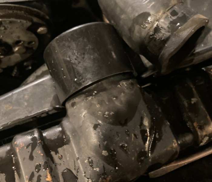

eaglescout526 Posted March 6 Author Share Posted March 6 I created a little tool to help me flush the radiator and I want to share the idea. I took a spray paint cap, used a soldering iron to cut the middle out which is the perfect diameter for a garden hose And the inner sleeve of the cap allows it to slide in to the rad fittings like this Then you can insert the garden hose to the hole you made on the cap and it should help make less of a mess and let more water force in the radiator to get a good guaranteed flush. Link to comment Share on other sites More sharing options...
