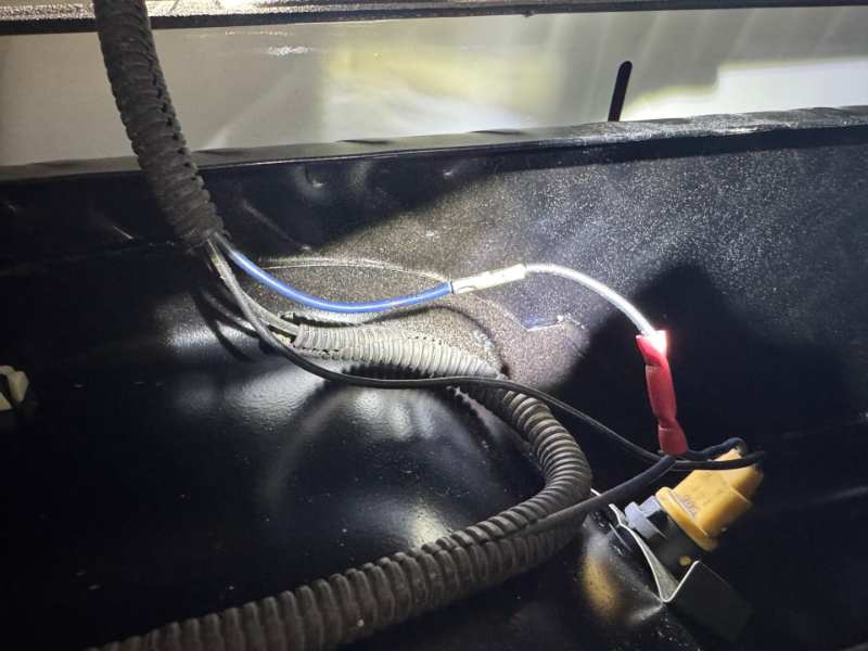

THANKS.... Getting closer. Unplugged C159 (my whole interior is out) and it didn't blow. Plugged back in and disconnected the blue wire (previous owner cut out C159 to add a trailer harness) and the fuse did not blow. Connected blue wires and it blew. So I think that narrows it down to the tail lamp harness. The harness looks to be in pretty good shape. Only think I found was the picture below where someone spliced it back for some reason. From what I can tell it's done correctly just not sure why. What would you suggest next???
Also.... the blue wire pictured above was wrapped up so it's not that shorting it out.....
Isn't there supposed to be 2 blue wires for the plate lights? I feel like one could be cut and shorting somewhere in the loom there.
I would say take that harness out and pull the wires out of the loom to see what's really going on if you can
There's one blue wire that runs to all taillamp bulbs. As @The86manche mentioned follow that blue wire. Make sure that RED butt splice isn't tied to GND. Check all bulbs, make sure they're 2 filaments bulbs, except license plate bulbs. I know single filament bulbs aren't supposed to fit, but people have a way of making them fit.

Thanks to all.... Ended up pulling the wiring harness and found a few odd things. Someone had done some wiring and had a ground and blue wire connected together. Had to pull it out of the harness to find it. THANKS
