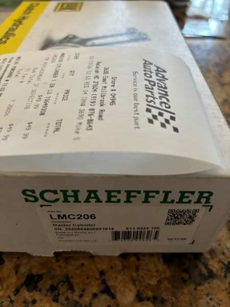

Tex06 Posted 5 hours ago Share Posted 5 hours ago I went thru this exercise with my 92 when I did the conversion....unfortunately I don't remember the final outcome. I think I made a new rod end for the master that threaded on but I'll have to dig and see what I can find. The LMC206 was what I ended up going with. Link to comment Share on other sites More sharing options...
Gojira94 Posted 2 hours ago Author Share Posted 2 hours ago Thanks for the confirmation. I found one locally for only $10 more than the cheapest price I saw on Amazon. It only has about .4-.5mm slack at the rod. I said screw messing with the parts house master, I'm returning it for a little more than I paid for the LuK master. Link to comment Share on other sites More sharing options...
