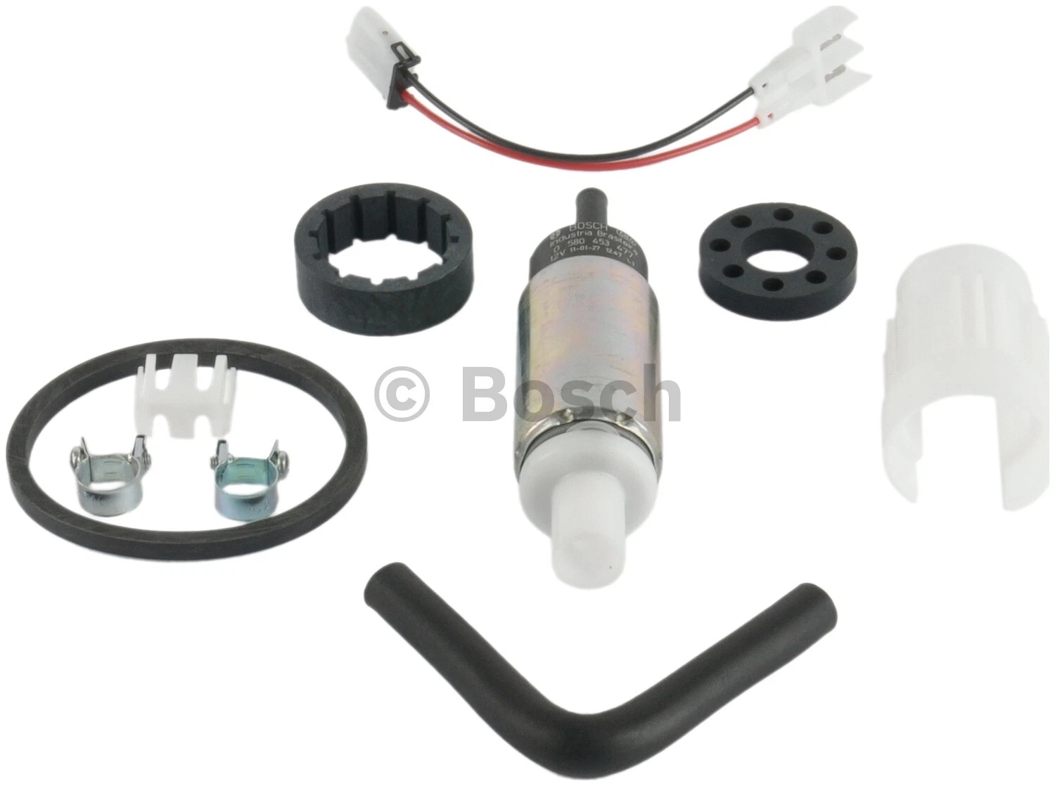

Eagle_SX4 Posted November 14 Share Posted November 14 9 minutes ago, hgeranium said: I found an even better deal on the Bosch. $40. Just make sure it comes with the adapters. The Bosch pump is smaller than the original and needs the adapters to fit properly on the sending unit. This pic has every thing that should be included with the fuel pump. 9 minutes ago, hgeranium said: Might be a good idea to throw in a new strainer while I'm at it, huh? Yeah, the rule of thumb is new pump new strainer. The good thing about the 69302 is that it uses the stock strainer which is much bigger than most of the newer ones. Link to comment Share on other sites More sharing options...
hgeranium Posted November 14 Author Share Posted November 14 4 minutes ago, Eagle_SX4 said: Just make sure it comes with the adapters. The Bosch pump is smaller than the original and needs the adapters to fit properly on the sending unit. This pic has every thing that should be included with the fuel pump. Yeah, the rule of thumb is new pump new strainer. The good thing about the 69302 is that it uses the stock strainer which is much bigger than most of the newer ones. this is the one I ordered. Good idea to cancel and order that other one? I don’t see a couple of things in the pic compared to the first one. It was about a $30 difference. Link to comment Share on other sites More sharing options...
Eagle_SX4 Posted November 14 Share Posted November 14 28 minutes ago, hgeranium said: this is the one I ordered. Good idea to cancel and order that other one? I don’t see a couple of things in the pic compared to the first one. It was about a $30 difference. Probably. You can make that one work but you will have some fabrication to do to get it to sit on the hanger. Link to comment Share on other sites More sharing options...
hgeranium Posted November 14 Author Share Posted November 14 Just now, Eagle_SX4 said: Probably. You can make that one work but you will have some fabrication to do to get it to sit on the hanger. It’s pretty wild that those adapters are comparatively worth an extra $30. But for peace of mind it’s worth it. Link to comment Share on other sites More sharing options...
