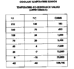

Ωhm Posted March 21 Share Posted March 21 During WARM-UP MODE OPEN LOOP, a faulty Coolant Temp Sensor (CTS) causes the ECU to look at the Manifold Air Temp Sensor (MATS). ECU will add ½°C for every 85 RPM's seen by the ECU. Takes time to figure this out. If you're holding onto a REM, you should know right away. Link to comment Share on other sites More sharing options...
hgeranium Posted March 21 Author Share Posted March 21 10 minutes ago, Ωhm said: During WARM-UP MODE OPEN LOOP, a faulty Coolant Temp Sensor (CTS) causes the ECU to look at the Manifold Air Temp Sensor (MATS). ECU will add ½°C for every 85 RPM's seen by the ECU. Takes time to figure this out. If you're holding onto a REM, you should know right away. No REM on hand but I do have a spare CTS that I have yet to install. The one that supplies the ECU specifically. I could throw it on for good measure since I already have one. I still have the issue even when it’s warmed up. Does that make the CTS any more or less likely? Link to comment Share on other sites More sharing options...
Ωhm Posted March 22 Share Posted March 22 CTS is a problem sensor to work with. Maybe not so, 38 yrs ago. It's a plug for coolant and it's threaded into the block. One mistake and your block's in trouble. If it does come out, make sure to rid the passage of all casting debris. Disconnect CTS connector (C222) and using a DVOM (don't use auto range) measure Ω's across the CTS (C222_A is GND side). Watch meter during cold start, warm up and then idle. Look for opens, shorts or maybe no movement at all. Link to comment Share on other sites More sharing options...
hgeranium Posted March 22 Author Share Posted March 22 3 hours ago, Ωhm said: CTS is a problem sensor to work with. Maybe not so, 38 yrs ago. It's a plug for coolant and it's threaded into the block. One mistake and your block's in trouble. If it does come out, make sure to rid the passage of all casting debris. Disconnect CTS connector (C222) and using a DVOM (don't use auto range) measure Ω's across the CTS (C222_A is GND side). Watch meter during cold start, warm up and then idle. Look for opens, shorts or maybe no movement at all. This is a very dumb question, but are you recommending I should unplug the sensor and probe the connectors with the engine running all the way through cold start to warm idle? Or are you saying to check the resistances at varying temperatures with the engine off (like check it when it's cold, let it warm up then turn it off and check it etc.)? I just would be worried about running the engine for an extended period of time with the thing unplugged. As you can probably tell, electrical diagnostics are not my strong suit, so what may seem obvious to most people is certainly not for me. Link to comment Share on other sites More sharing options...
Ωhm Posted March 22 Share Posted March 22 No. Good question. Either way should work. Myself I'd disconnect the CTS, connect DVOM on CTS pigtail (not the harness) and watch the Ω's. Keep in mind the ECU will default to using the MATS for CTS values and adjust the temperature accordingly (simulated Engine Warm-Up). Link to comment Share on other sites More sharing options...
