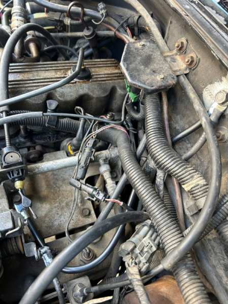

hgeranium Posted November 7, 2025 Author Share Posted November 7, 2025 Great progress has been made! I will submit more pictures when I’m home from class. new IACV installed and so far running GREAT. The starts are so smooth and consistent. We will see how it lasts. Upgraded the engine-to-chassis ground with an extra ground cable from the chassis to a fuel rail bolt. Also cleaned up and correctly routed all of the cruise control and HVAC vacuum lines. Old worn out headlight bezels have been quickly rattle canned to freshen them up and they look great (from more than 5 feet away). I was messing with the dipstick ground but that stud kept spinning and I ran out of time. Eventually I’ll get that ground freshened up. next on the list is re-doing the blower motor and fuel pump grounds while I’m in a groundy mood Link to comment Share on other sites More sharing options...
Eagle_SX4 Posted November 7, 2025 Share Posted November 7, 2025 11 minutes ago, hgeranium said: It appears like your transmission kickdown cable is disconnected. Link to comment Share on other sites More sharing options...
hgeranium Posted November 7, 2025 Author Share Posted November 7, 2025 33 minutes ago, Eagle_SX4 said: It appears like your transmission kickdown cable is disconnected. Yeah don’t worry I put that back on after the picture was taken. I took it off for easier access to that fuel rail bolt. Link to comment Share on other sites More sharing options...

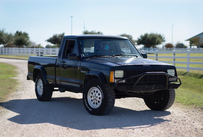

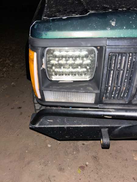

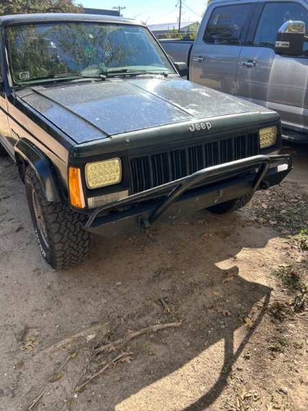

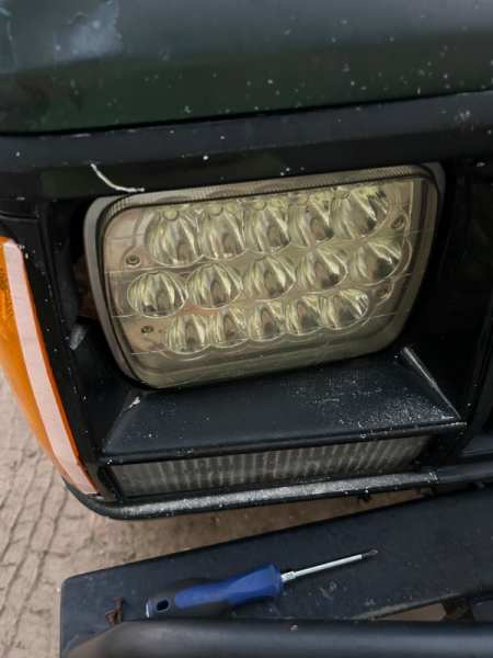

hgeranium Posted November 7, 2025 Author Share Posted November 7, 2025 This was the condition of the worse of the two bezels originally. At some point the entire front end (fenders, header panel, bezels, and grille) was replaced and painted black (maybe an accident? But clean title) and this bezel did not hold up. That’s why you can see my eliminator decal stop at the fender and a pretty horrid paint mismatch. You could see the original paint starting to show on the bezel and it was killing me for years. I took this last night. The flash makes it look way worse than it actually is but you can see the difference. Also you can see that upper lip with the jeep logo is from a green XJ lol. I wish I knew what happened to the front end for all the parts to be cobbled together from different XJs. There’s 3 different paint colors that I can find in the front end other than black. Link to comment Share on other sites More sharing options...
hgeranium Posted November 8, 2025 Author Share Posted November 8, 2025 this is a much better picture. I may have to do the grille sooner than later because it makes it look bad in comparison. Also I’m not too well-versed on auto body paint, but could repainting the front bulbar be as simple as stripping the paint, sanding it, primer, and then black? Link to comment Share on other sites More sharing options...
89 MJ Posted November 8, 2025 Share Posted November 8, 2025 55 minutes ago, hgeranium said: Also I’m not too well-versed on auto body paint, but could repainting the front bulbar be as simple as stripping the paint, sanding it, primer, and then black? Depending on the color you want to go with and condition, you could just sand it and paint it. But your method would leave the best and longest lasting finish. Link to comment Share on other sites More sharing options...

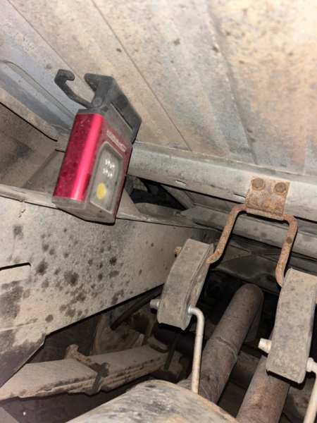

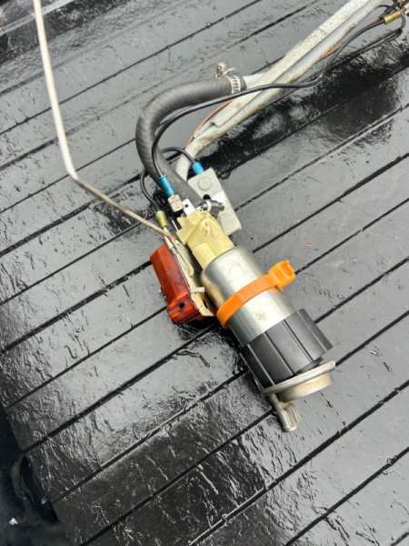

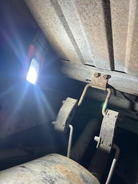

hgeranium Posted November 23, 2025 Author Share Posted November 23, 2025 Check this out! I was looking at my fuel pump before I got started on replacing it and noticed a strange red box on the undercarriage Its a magnetic bending LED light! AND IT WORKS! I have owned this truck for three years and I’ve never noticed it, who knows how long it’s just been sitting under there waiting for me to do the fuel pump. This definitely means that it’s been replaced before and whoever did it forgot to take their light. I’ll be curious to see what brand was put in there. Link to comment Share on other sites More sharing options...

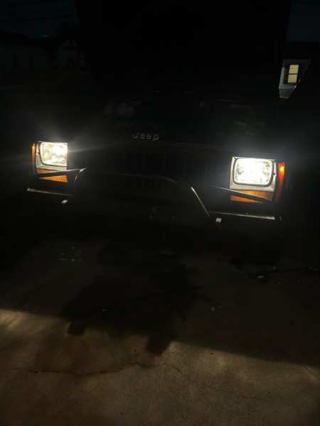

hgeranium Posted November 23, 2025 Author Share Posted November 23, 2025 Two things that I got done last night from my laundry list of parts. H6054 housing and H4 halogen bulb swap. They’re brighter than those ancient LEDs I had lol. It was a $40 glass housing set from Amazon. I’m sure it’ll last me a good year or two and then I’ll just buy hella housings. They seem to be of decent quality though. No point in adding a picture but I also replaced the PCV grommet. I had no idea how well it was supposed to fit. My old one had so much play and gappage but after getting the new one in it’s real tight. No wonder I was getting blow by on the back of the valve cover. On the agenda for when the sun comes up: fuel pump, strainer, fuel filter, CPS, spark plugs, valve cover gasket, and washer fluid pump. In that order Link to comment Share on other sites More sharing options...

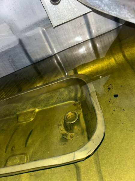

hgeranium Posted November 23, 2025 Author Share Posted November 23, 2025 I already kind of spoiled my progress in another thread but I’ll add it here just to keep track. Removing the pump was incredibly easy. This is the first fuel pump job I’ve ever done, and it took me like 15 minutes. The previous owner indeed changed the fuel pump with a Delphi unit, but he either forgot or neglected to put on a strainer, which I’m sure didn’t help its lifespan. (PO’s “installation” above) Getting everything back in was another story. It was an absolute nightmare because I removed and reinstalled the pump four times because one of the quick connects for the pump would come loose getting the lock ring on. Not to mention I was stubborn and decided to forgo removing the driveshaft, which made my maneuvering and angles quite interesting, but it wasn’t that bad overall. I got significantly faster every attempt. I went from about an hour for my first installation failure to my final installation success taking about 15 minutes. So far it’s running great. I’ll be curious to see the gas mileage. It’s true test will be tonight when it has to make a 180 mile road trip back home. I can’t attest as to whether or not it’s running better because it was running just as great up until my previous road trip where it broke down, but it’s at least equal. Link to comment Share on other sites More sharing options...
