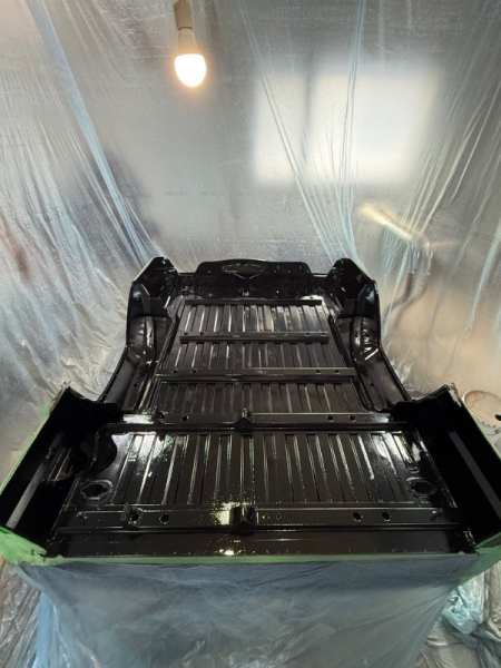

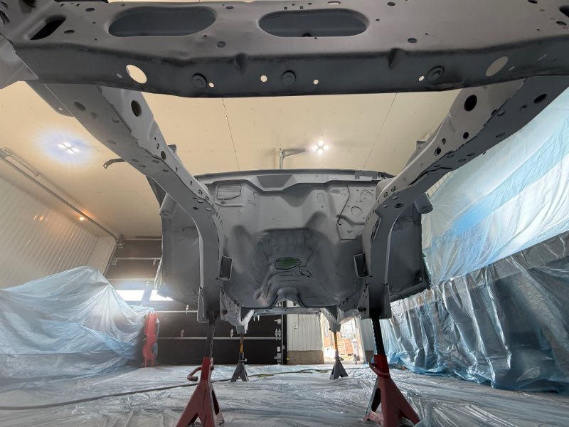

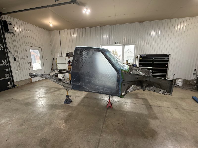

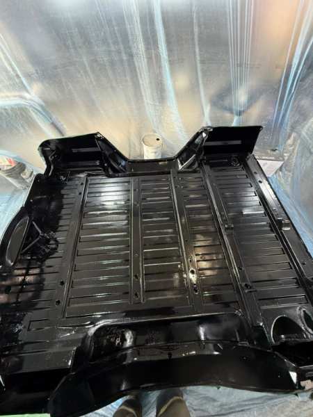

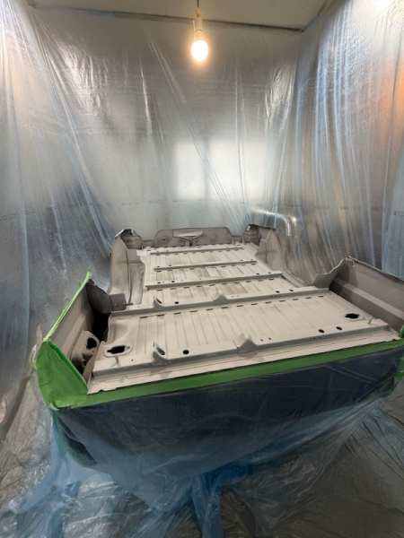

Sp88mj Posted February 9 Author Share Posted February 9 Epoxy primer done last week Just finished to apply 2 coat of eurethane paint And after 2 month my floor pans are finally home Link to comment Share on other sites More sharing options...

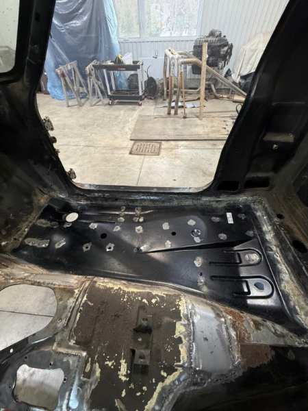

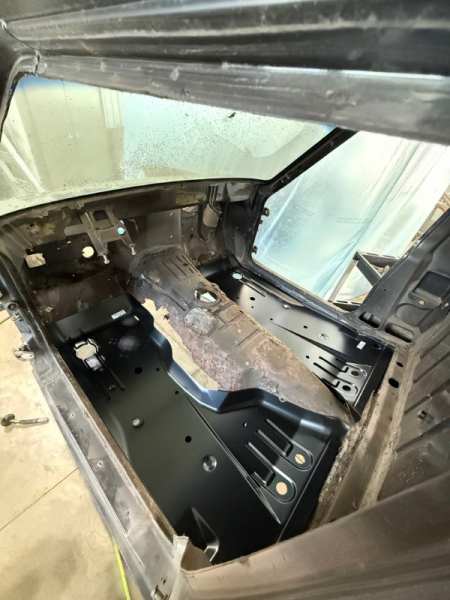

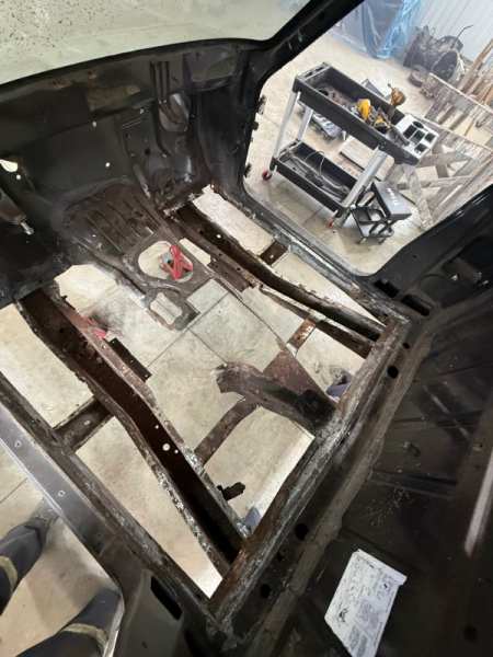

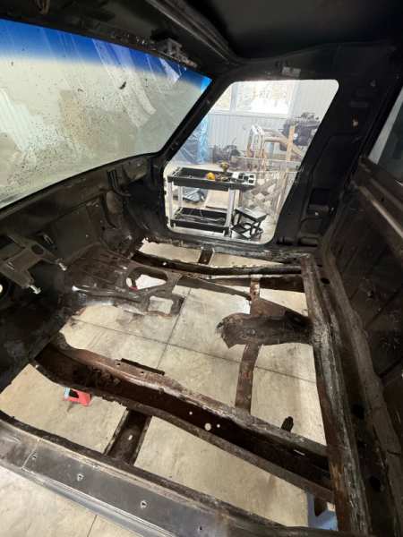

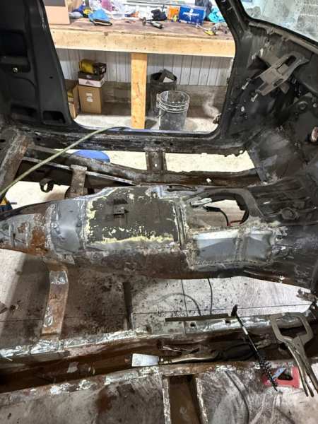

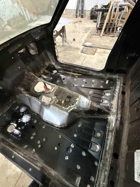

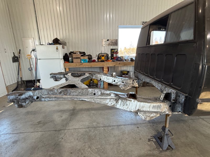

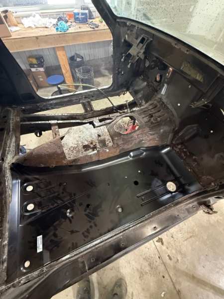

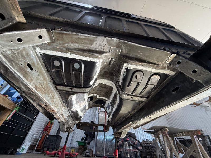

Sp88mj Posted February 11 Author Share Posted February 11 Some trimming done today to recive the floor pans! The fit on those key part floorpan is near perfection, would recomand to every one planning to do this job! No big deal, just cut where is the rust Also started to weld the top part tunnel from my 87 donnor Link to comment Share on other sites More sharing options...
Sp88mj Posted February 13 Author Share Posted February 13 Top and passenger side of the tunnel done! Link to comment Share on other sites More sharing options...
Sp88mj Posted February 18 Author Share Posted February 18 Passenger side done! Still waiting for my floor support to show up. Back to work tomorow so driver side will wait another 2 weeks Link to comment Share on other sites More sharing options...

Sp88mj Posted February 18 Author Share Posted February 18 11 hours ago, ratrapp said: looking good.i wish when i done mine they had made the mj pans.i used xj pans and trimmed and cut and got them in. They fit so well! No trimming needed just some love tap with a small hammer some place to get the pan pefectly lined with the tunnel and rocker Link to comment Share on other sites More sharing options...

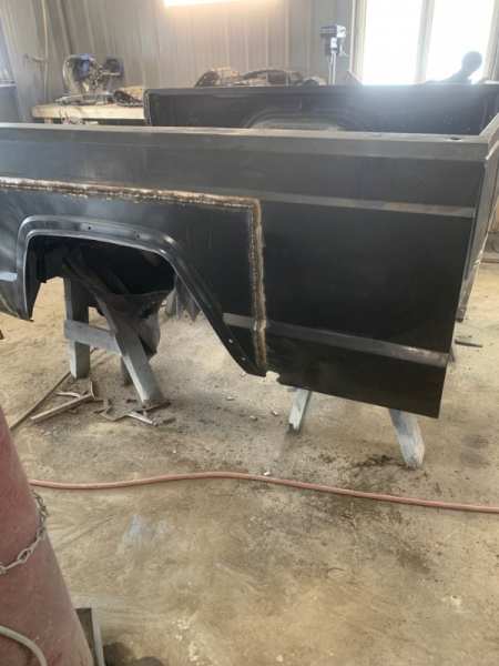

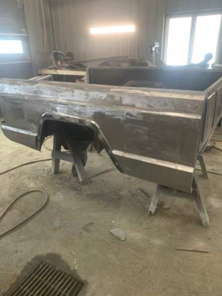

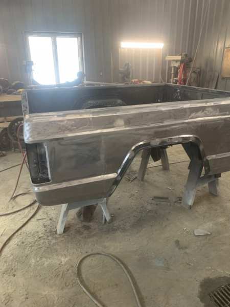

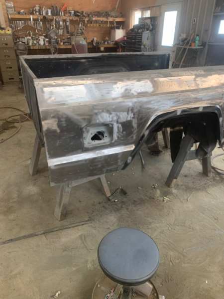

Sp88mj Posted March 7 Author Share Posted March 7 Dropped the bed at the body shop yesterday! I chose chrysler stone white (Pw1) for color, you can find it on newer xj’s and many more chrysler model. can't wait to see the result next week! Link to comment Share on other sites More sharing options...

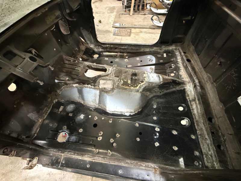

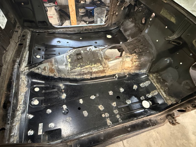

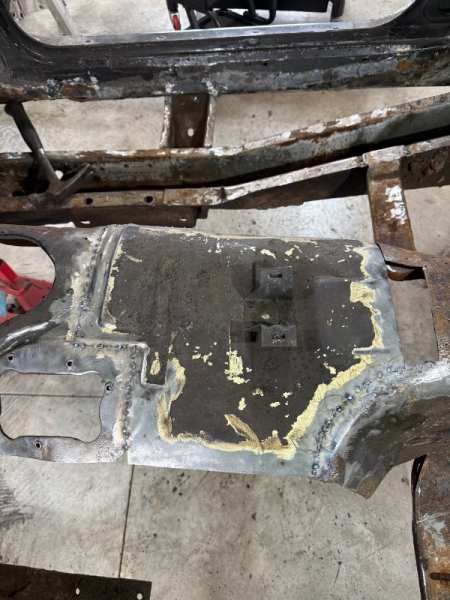

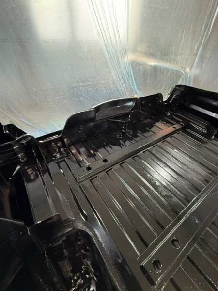

Sp88mj Posted March 11 Author Share Posted March 11 Finally floor are done! still need to weld the floor suport that i recive last week Link to comment Share on other sites More sharing options...

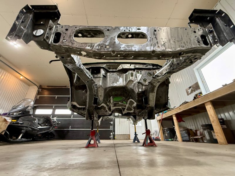

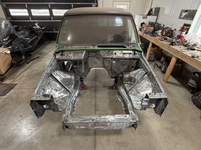

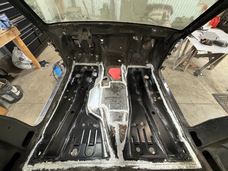

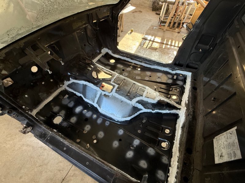

Sp88mj Posted March 14 Author Share Posted March 14 Take some time yesterday to clean underneath the comanche. Today i prepared the welds and applied some seam sealer on both side Link to comment Share on other sites More sharing options...

ratrapp Posted March 14 Share Posted March 14 i used some sound deadener off of amazon called siless that was pretty inexpensive.it really takes alot of road noise out of the cab.i even put it in the roof under the headliner. Link to comment Share on other sites More sharing options...
Sp88mj Posted March 14 Author Share Posted March 14 1 hour ago, ratrapp said: i used some sound deadener off of amazon called siless that was pretty inexpensive.it really takes alot of road noise out of the cab.i even put it in the roof under the headliner. i will take a look at this brand! Thanks Link to comment Share on other sites More sharing options...

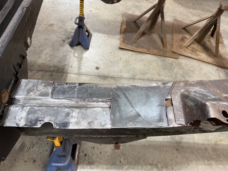

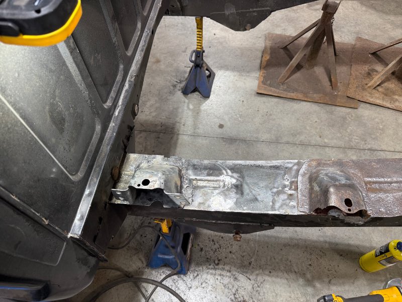

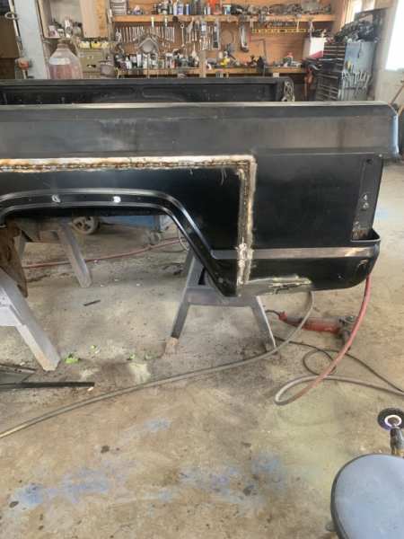

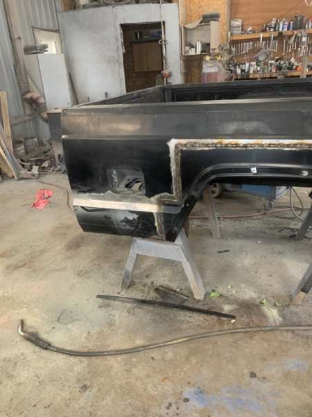

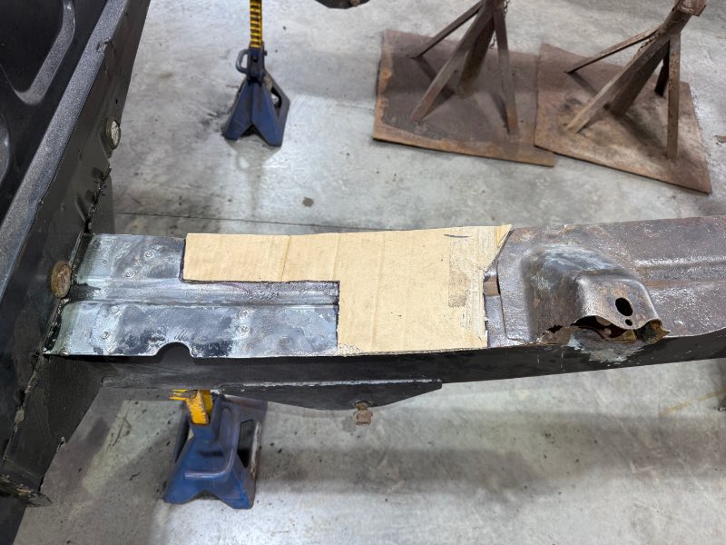

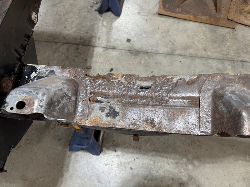

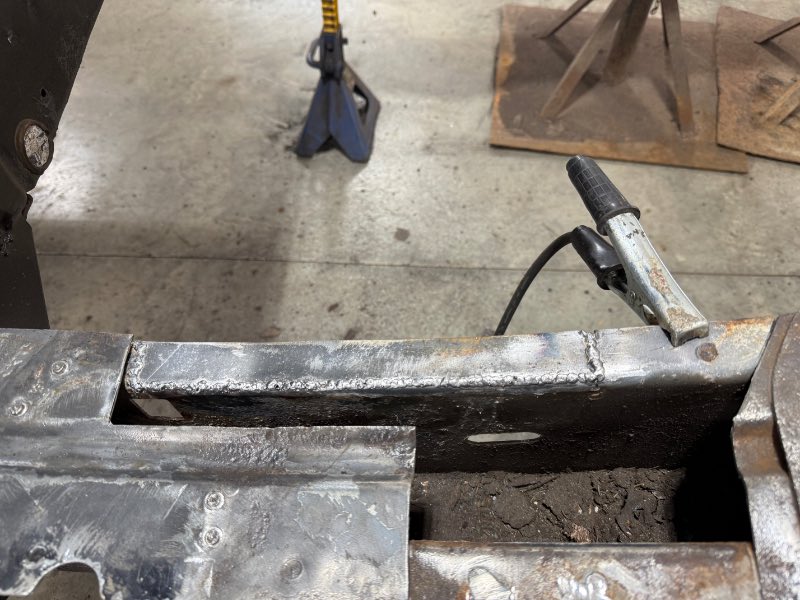

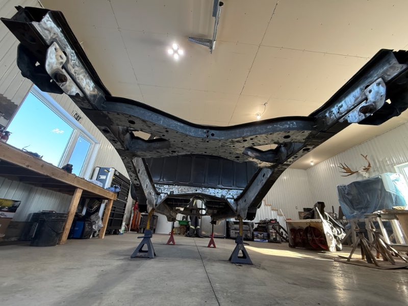

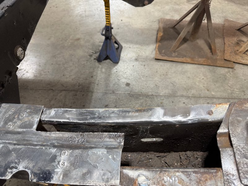

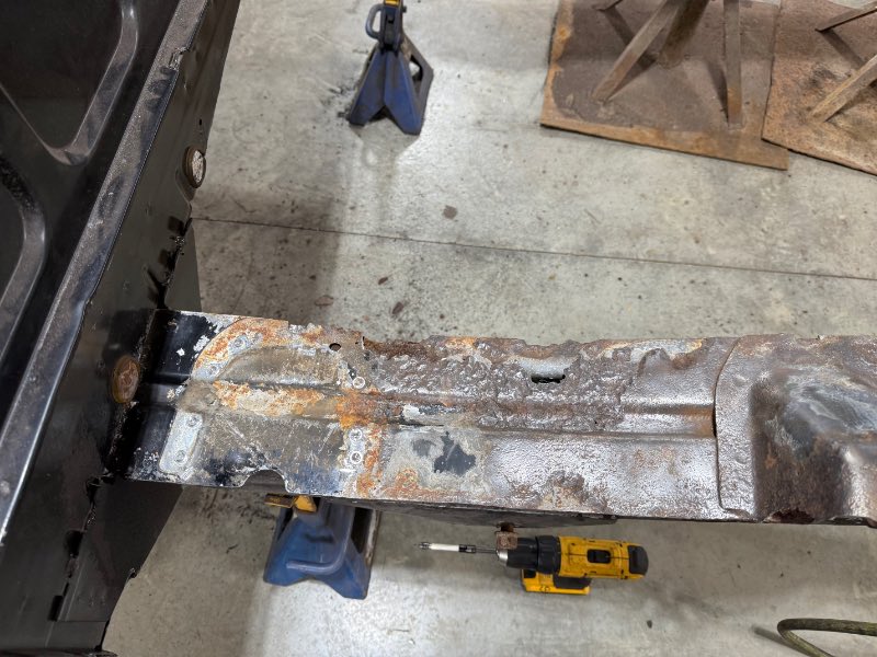

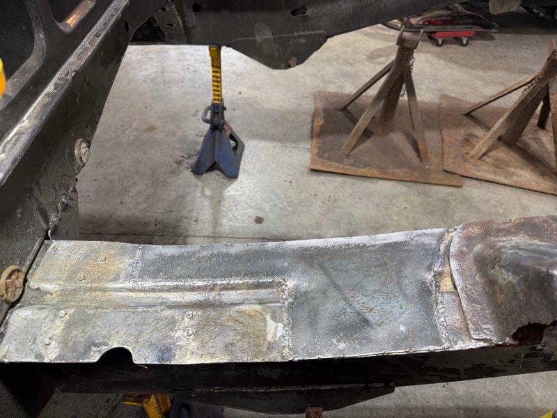

Sp88mj Posted March 16 Author Share Posted March 16 Some rust in between my 2 bed support on driver side, a pile of mud wash chilling there when i pull the bed off, its a pretty hard to get place when washing underneat the truck. So i took the support out and trying to keep most of the good metal with my spot weld on so i can replace it at the exact same spot! repair the lip on the frame Good ole cardbord trick has never failed me That was the last place to repair! Still need to weld my floor support tomorow before going back to work. On my next time off in 2 weeks ill be ready to start painting the floor, frame and engine bay. can't wait to be done with this step and starting to reasemble the manche Link to comment Share on other sites More sharing options...
Sp88mj Posted March 17 Author Share Posted March 17 Floor support are installed Link to comment Share on other sites More sharing options...

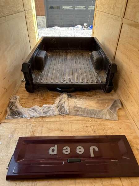

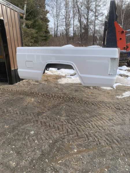

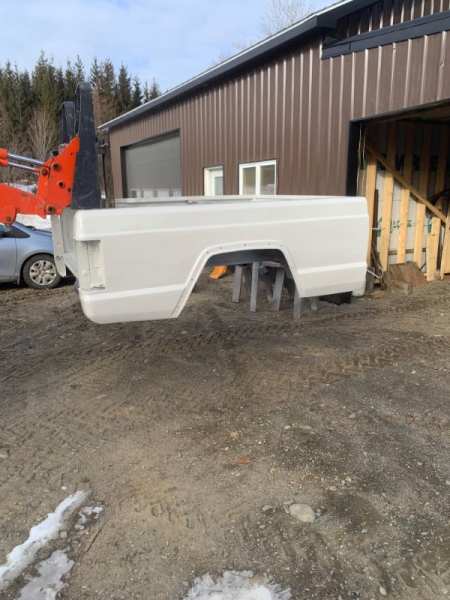

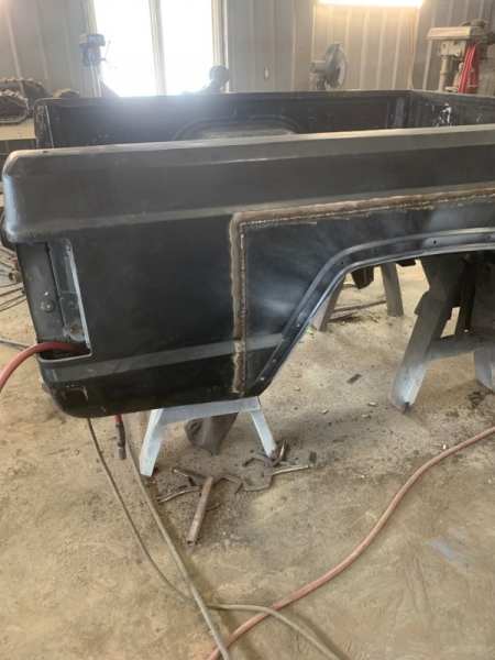

Sp88mj Posted 20 hours ago Author Share Posted 20 hours ago Pickup my bed at my friend garage tonight. Really happy how it turn out! And here is the final product! Link to comment Share on other sites More sharing options...
