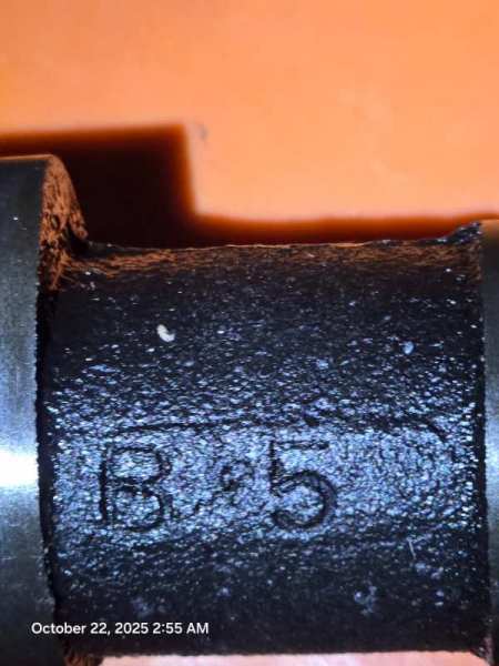

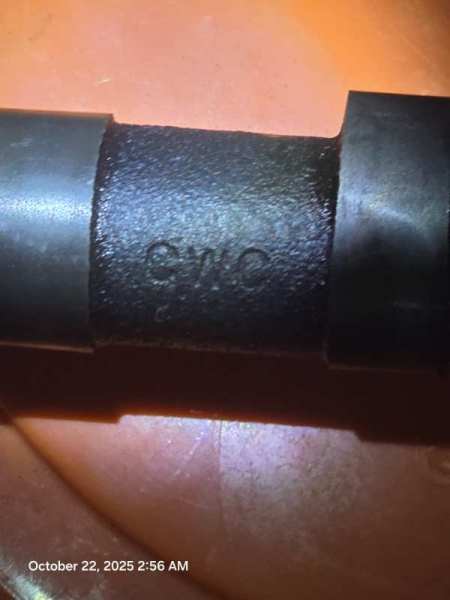

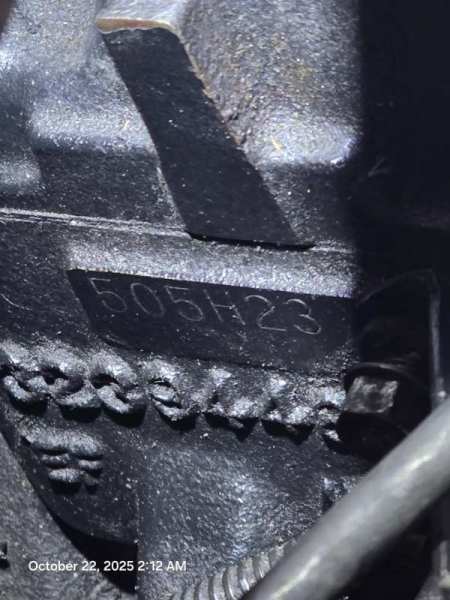

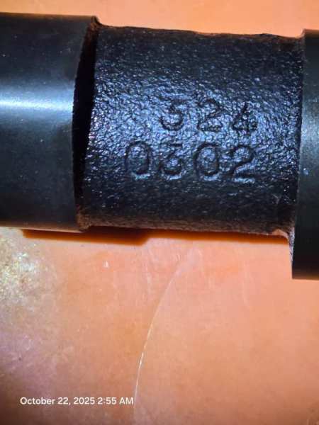

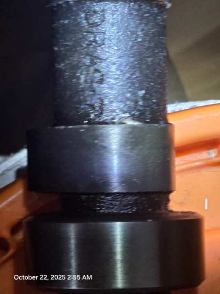

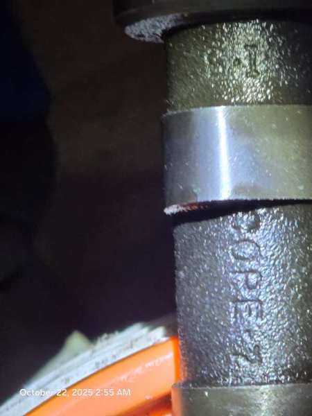

I got ahold of the guy i bought it froms daughter she said she isn't forsure but he took the motor out of a jeep wrangler amd put in the  Comanche ive got the engine number well both numbers on the engine i will add a pic of it but when I use the other dowel it makes complete turns and stays in time but soon as I put it back in the original dowel hole ut doesn't line back up I should have taken Pic of that I'm taking the cam to a machine shop that does head amd cam work the going to fix the other dowel hole so it will line up fully and I have pictures of the cam ive got it out now
No. Just something like this does take time for one to wrap their head around. It’s odd that an engine swap was done and suddenly timing issues. Makes me wonder if the original owner was sold an engine that wasn’t working right to begin with.
Have you tried looking up the casting info on the cam itself?
This engine block is a 2.5 liter and was made on May 23, 1995. So it is defiantly newer than your Comanche.
That doesn't help with your timing issue but thought if you knew what year it was, it might help narrow things down if any internals changed between 86 and 95.

I don’t recall much changing when I last had access to the digital catalog but I could very much be wrong. I know an 84-85 block is the same as well. I thought maybe my 84 2.5L had more pep since the TBI swap and had to check the cam. Cam is the same until 90. Actually, thinking about it. Maybe the HO is a little off on timing and perhaps the cam was changed and why it could be getting off on time as the lifter duration and timing could be different there. I wonder what the previous owner really did to that block. But I imagine there would be a lot more issues if this was the case like back firing.
Also after reading on the internal differences the camshaft it tells you got to switch camshaft or switch dowel hole but I'm picking up tools them going to see how she does under a load update soon

As far as I know the 95 engine had MPFI (multi port fuel injection). The 86 had TBI (throttle body injection). If you still have throttle body injection it is likely that only the engine was changed and all of the original engine accessories were retained. Including manifolds and fuel and timing systems.
Some more pics of the intake manifold and throttle body would be very helpful in determining what was changed or not.
Also I realized I was wrong on the year of the engine. It is a 1985 engine which would mean it is likely original to the truck. The engine block casting number underneath the date code and kind of hard to see in the picture is 3239443 which was made between 83 and 88. That along with the date stamp leads to a 1985 engine block.
I am very sorry for the confusion. The date code along is not enough info to correctly date an engine and I should have known that before I posted earlier.
