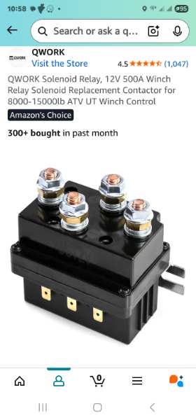

Limeyjeeper Posted September 27, 2025 Share Posted September 27, 2025 Just get one of these they work fine, $24 Probably made in the same plant as the Warn one without the name. Link to comment Share on other sites More sharing options...

Big_Mark Posted September 27, 2025 Share Posted September 27, 2025 This topic came at a great time, my buddies Warn 8000 lb winch "died" so he bought a new one and gave me the dead one. Symptoms were winch reels out fine but not in. totally a relay problem but he bought the new winch before digging into it, anyway bummer for him, yeah for me. If I use one of the replacement relays as shown how does the controller connect to it? Link to comment Share on other sites More sharing options...
derf Posted September 27, 2025 Share Posted September 27, 2025 2 hours ago, Big_Mark said: This topic came at a great time, my buddies Warn 8000 lb winch "died" so he bought a new one and gave me the dead one. Symptoms were winch reels out fine but not in. totally a relay problem but he bought the new winch before digging into it, anyway bummer for him, yeah for me. If I use one of the replacement relays as shown how does the controller connect to it? I'd bet that the 3 pins from the controller attach to the spade connectors sticking down in the front. You'd probably want to fabricate a sheet metal bracket to mount the plug. Link to comment Share on other sites More sharing options...

Limeyjeeper Posted September 27, 2025 Share Posted September 27, 2025 Yes I have one on my Comanche. Seems to work fine. For what it costs you can have 2 spares for tbe cost of the Warn one!! Link to comment Share on other sites More sharing options...
Big_Mark Posted September 29, 2025 Share Posted September 29, 2025 On 9/27/2025 at 3:20 PM, Limeyjeeper said: Yes I have one on my Comanche. Seems to work fine. For what it costs you can have 2 spares for tbe cost of the Warn one!! How did you connect the controller cable to the relay assembly? Pics please and thank you! Link to comment Share on other sites More sharing options...
Limeyjeeper Posted October 2, 2025 Share Posted October 2, 2025 The Solenoid has 3 pins. Ground, in, out then you take power from the power stud on the solenoid. I will need to dig out the diagram. There are plenty of wiring diagrams if you google it. Link to comment Share on other sites More sharing options...
