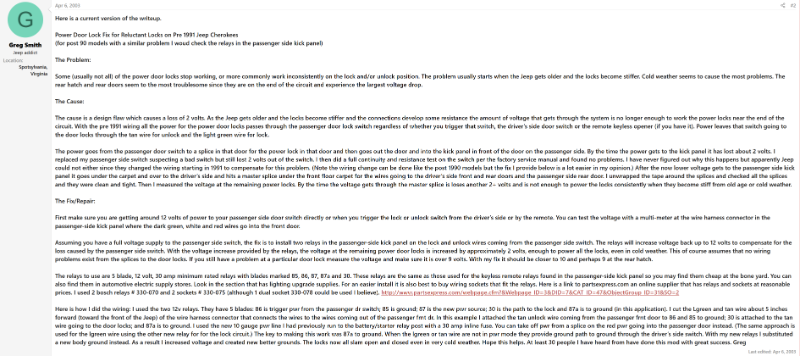

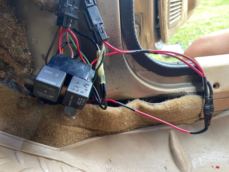

87MJTIM Posted August 24, 2025 Share Posted August 24, 2025 If you have power locks and find that the driver's door just will not lock or unlock when you hit the switch, you should do this upgrade/fix to your wiring. I found this write up on both JeepForum and NAXJA.org. I will paste a link to the NAXJA since it is a little more concise in the write up. https://naxja.org/threads/greg-smith-power-door-locks-writeup-pre-1991.1874/ I followed Greg's instructions except for the power source. I spliced into the main power coming over from the driver's side and used a splitter from NAPA (part #784473). I cut the light green and tan wires and crimped on spade female connectors. These went directly to the relay terminals. I should have added more wire so the connections aren't as stretched. I did add wire to the power feed, as the photo shows. It isn't pretty, but you cannot see it with the kick panel in place. Verdict: DO IT! I now have working door locks from the driver's side. Link to comment Share on other sites More sharing options...
