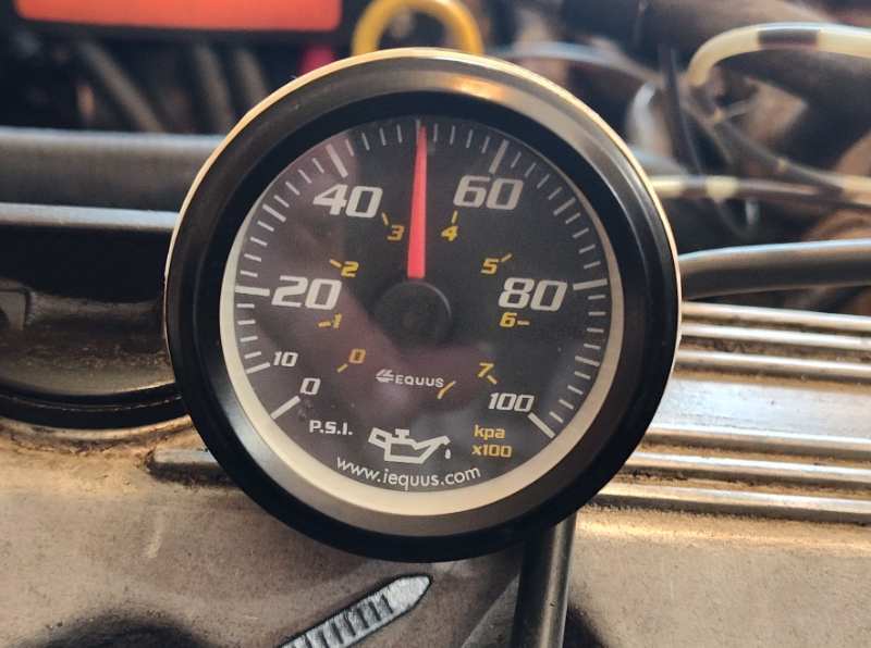

Eagle_SX4 Posted August 4, 2025 Author Share Posted August 4, 2025 This all started because of a failed cam gear and still not sure why it failed. Just checked my oil pressure with a mechanical gauge and during cold idle it is at 50 psi. Link to comment Share on other sites More sharing options...
