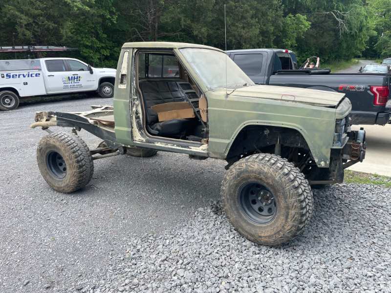

AreWeThereYet Posted July 10, 2025 Posted July 10, 2025 A buddy of mine rescued this Comanche with some cool ideas in mind, but ended up pursuing other projects. After I started casually browsing rock crawlers, several hints were dropped that the MJ would be a great candidate, and I couldn't resist. From what I've been told and am able to find out, it's a 1987 base model short bed that came with a 4.0 and a 5 speed manual. Currently it has a 4.0 out of an 88, automatic AW4, NP231, and a low pinion D30 from a YJ on leaf springs up front. It runs well, shifts, and the 4x4 engages, but it's still a project. VIN Decoding.
89 MJ Posted July 10, 2025 Posted July 10, 2025 Looks like a good project. What do you have planned for it?

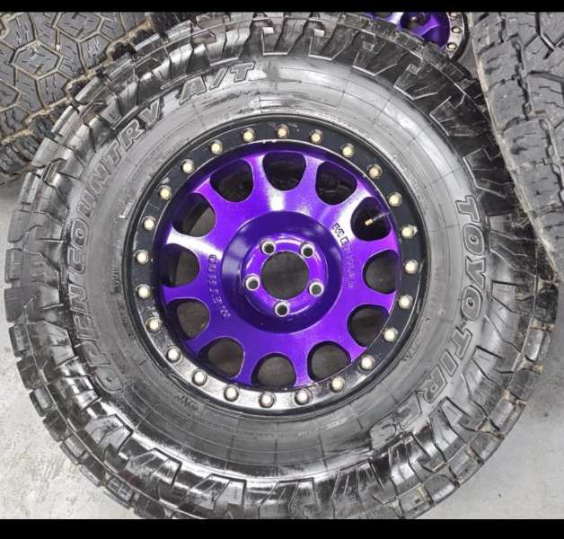

AreWeThereYet Posted July 10, 2025 Author Posted July 10, 2025 I got to drive it a bit last week after I found a deal on some Method MR 105 beadlocks with decent tires. 2936291304904052732.MP4

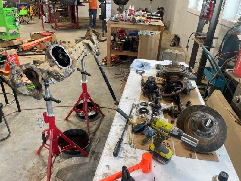

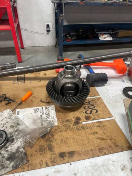

AreWeThereYet Posted July 22, 2025 Author Posted July 22, 2025 Made a little progress and got the locker swapped to the new carrier and put the new ring gear on.

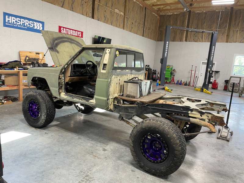

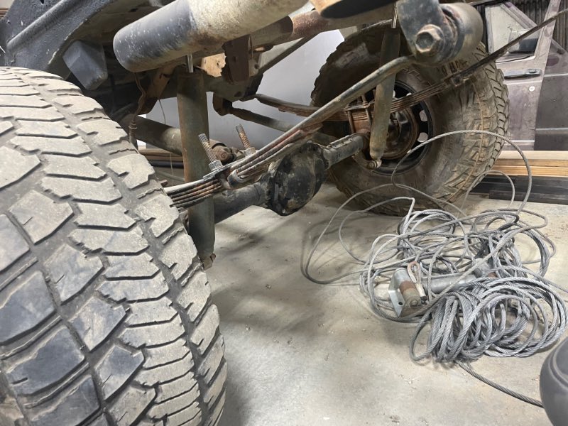

ThatJeepGuy Posted July 24, 2025 Posted July 24, 2025 The traction bars on the rear (or what's visible of them atleast) is intriguing. Looks like a great start regardless the missing bits
AreWeThereYet Posted July 24, 2025 Author Posted July 24, 2025 6 hours ago, ThatJeepGuy said: The traction bars on the rear (or what's visible of them atleast) is intriguing. Looks like a great start regardless the missing bits Thanks. The rear bars are Definitely intriguing, but a lot about this truck is. For now they’ll stay, and I’ll find a way to mount them to the 8.25 that’s going in the rear.
89 MJ Posted July 24, 2025 Posted July 24, 2025 Seeing that pic of the rear suspension has me thinking there probably was a bad axle wrap problem. Those spring perches are awfully tall, but good for a little bit more lift.

AreWeThereYet Posted December 23, 2025 Author Posted December 23, 2025 After a busy few months, some setbacks, and my ability to overthink and underthink everything, I now have the front Dana 30 regeared to 5.13 with a Spartan locker. Here's where my pattern ended up. Might be a tad deep, but I don't mind. It definitely feels good to make real progress, and on one of the "more challenging" parts of the project. I did the final assembly, and now it will sit until I regear the Chrysler 8.25 for the rear. It will also be a big undertaking to get the axle under the front. Someone in this MJ's history cut up and welded on a bunch of mess to the front to add leaf springs. Most of it will be cut out, and I'll fab up simple spring towers, but the whole front bumper area may take some creative fab work. On a side note, if you order from Revolution Gear, be wary of their master install kits for the D30. I ended up not having all the parts needed, and they didn't carry the missing baffle and oil slinger. To their credit, the customer service was great and responsive, but didn't have a resolution for me, and basically said because they don't pack their own install kits, they have no control over it. The ring and pinion were great, it was just disappointing to order a kit that was described as having everything needed, then finding out it doesn't with no resolution other than to order missing parts from another vendor.

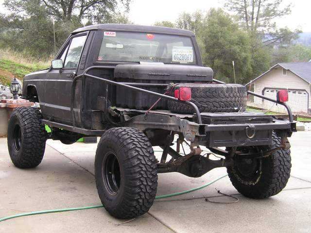

Big_Mark Posted December 30, 2025 Posted December 30, 2025 You should keep some kind of track bar in the rear, if only to control axle wrap, as 89 MJ pointed out, they were likely installed to control that very thing. Don't think "traction", think of it as "Control". When I went SOA on my CJ8 I went through 2 sets of rear leafs, they turn into "S" shapes or break, or both LOL. Once I added a track bar that problem went away. The condition where this happens is when you get your front end "up" (on a ledge, log, whatever) and you start bumping to get the rear end up, it puts all the weight and torque on the rear axle, making it wrap. Additionally, you can break a driveline U-joint which is a different level of suck. Anyways this is my free advice YMMV HAMMER DOWN

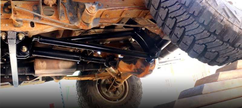

Big_Mark Posted December 30, 2025 Posted December 30, 2025 This is more or less what I had, one anti-wrap ladder and my woes went away. I had Dana 60s 6:12 gears and 42" Iroks and the problem never happened again
AreWeThereYet Posted December 31, 2025 Author Posted December 31, 2025 13 hours ago, Big_Mark said: You should keep some kind of track bar in the rear, if only to control axle wrap, as 89 MJ pointed out, they were likely installed to control that very thing. Don't think "traction", think of it as "Control". When I went SOA on my CJ8 I went through 2 sets of rear leafs, they turn into "S" shapes or break, or both LOL. Once I added a track bar that problem went away. The condition where this happens is when you get your front end "up" (on a ledge, log, whatever) and you start bumping to get the rear end up, it puts all the weight and torque on the rear axle, making it wrap. Additionally, you can break a driveline U-joint which is a different level of suck. Anyways this is my free advice YMMV HAMMER DOWN I appreciate the input; it's definitely something to consider. I'll have to figure out if these are worth keeping when I'm ready to start swapping the axles. I also don't trust (or understand) a lot of the previous fab work on this truck, even though I'm sure mine won't be much better. Sounds like you had a pretty nice setup, especially running 42s.
Big_Mark Posted December 31, 2025 Posted December 31, 2025 Controlling axle wrap helps get the traction to the ground, otherwise you start wrapping and bouncing, when you start bouncing, ya start breaking sh*t FYI I'd run those, as long as the frame mount has some kind of additional plating to spread the load of the tourque on them. Otherwise you'll end up breaking the frame. So back in the day I was "the Scrambler Guy" in my group. One of my wheeling buddies "Jeepmauler" was the Cherokee guy. he swore by attaching a plate of steel to the unibody (in his case) by sandwiching the body between the 1/4" plates he custom cut to fit. Places like the floorboard where the A and B pillars connected to for instance, and later various versions of antiwrap bars, rods etc. He finally nailed it all when he scratch built a tube buggy thing lol. Anyways like I said this is free advise from an old timer, hopefully it helps! Enjoy brother!
JoeLAW Posted January 4 Posted January 4 On 12/30/2025 at 4:25 PM, Big_Mark said: This is more or less what I had, one anti-wrap ladder and my woes went away. I had Dana 60s 6:12 gears and 42" Iroks and the problem never happened again How was your frame side mount on this? Was it solid, or more like a shcakle type?
Big_Mark Posted January 5 Posted January 5 On 1/3/2026 at 6:28 PM, JoeLAW said: How was your frame side mount on this? Was it solid, or more like a shcakle type? I welded a plate to the inside of my driver side frame rail, it was about 10" long and the height of the frame. to that I mounted a shackle/bracket to it, then from that shackle a HEIM joint, and two HEIM joins at the axle bracket. I think I might have some photos but will need to dig deep to find them, lol

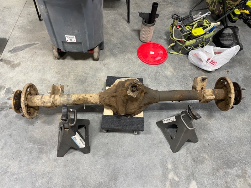

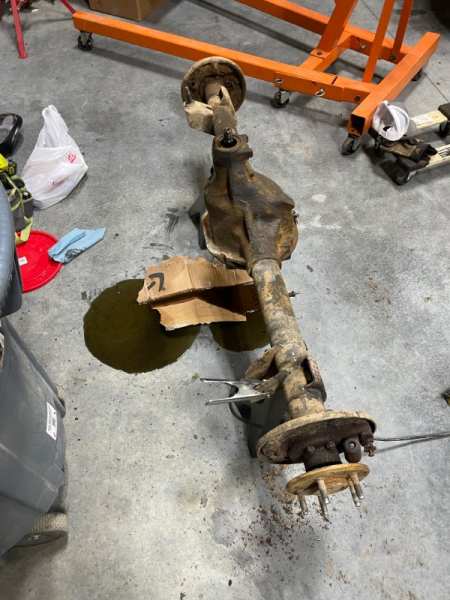

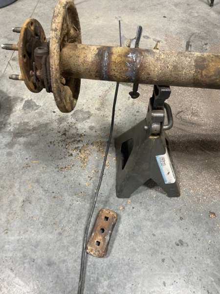

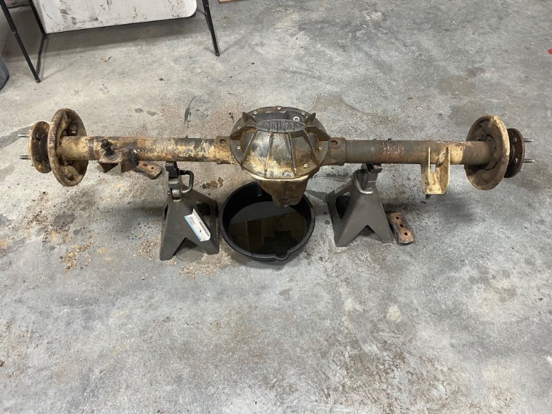

AreWeThereYet Posted January 11 Author Posted January 11 Made some progress today, drained and cleaned out the fuel cell, then put in a few gallons of ethanol free with some fuel treatment. It wasn’t too bad with only a little bit of old gelled gas and barely any sediment. I noticed a new sticker was added to my truck, and I am not fat. After that I pulled the 8.25 rear out and started cleaning it up. Managed to pop the yoke off the pinion when I was knocking one of the perches off and drained half the diff onto the floor. By the time I wrapped up I’d cut off the old leaf perches, started on one of the shock mounts, and had a raging headache from the nasty fuel fumes from earlier.

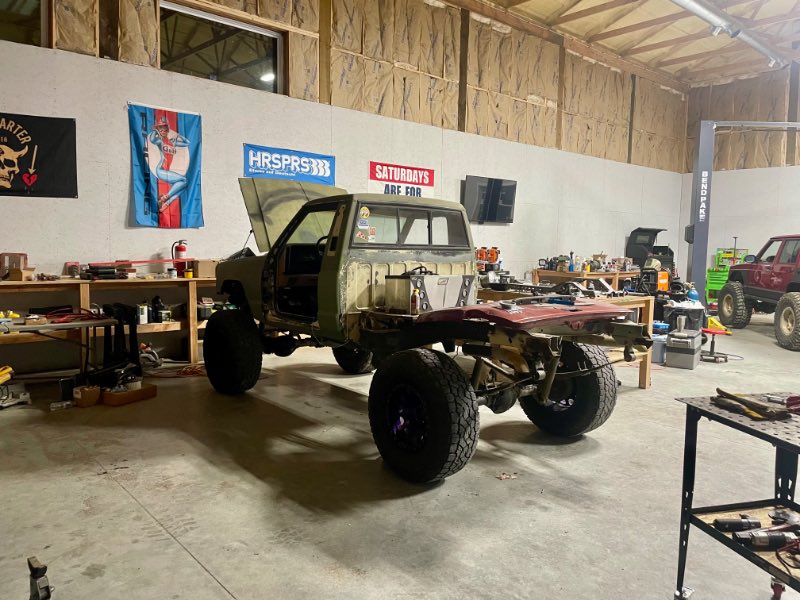

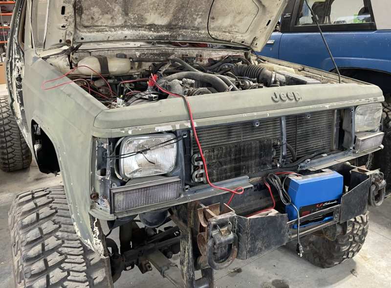

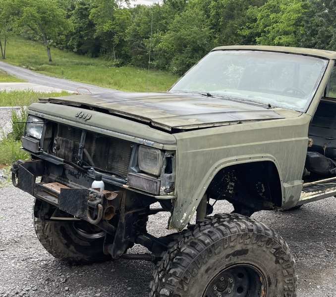

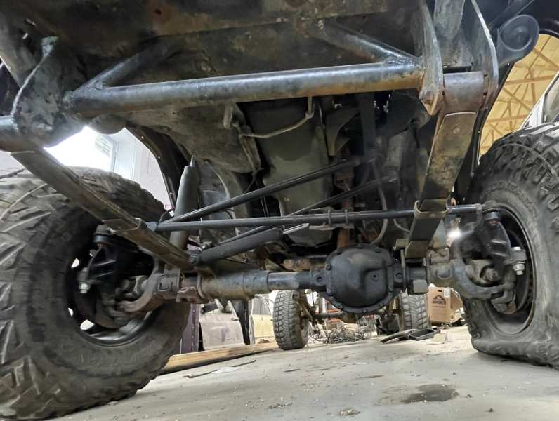

AreWeThereYet Posted January 16 Author Posted January 16 Took a couple of videos using a plasma cutter for the first time, if you look closely, you can see my smiley Comanche in the background. This will definitely be nice to have access to when it comes time to start cutting up the front end. Here's a couple of shots of the front for a better perspective
ThatJeepGuy Posted January 26 Posted January 26 To resolve your coil tower placement you could get a set of acos coil spring mounts. Its rather convenient how they chopped the spring post flush and then re utilized the space for a shock mount.
AreWeThereYet Posted January 26 Author Posted January 26 1 hour ago, ThatJeepGuy said: To resolve your coil tower placement you could get a set of acos coil spring mounts. Its rather convenient how they chopped the spring post flush and then re utilized the space for a shock mount. Thanks, I'll have to check those out, could definitely be a good option, and they're not too hard on the wallet either. Right now everything is iced over, so it may be another week or two before I get to mess with it again.
