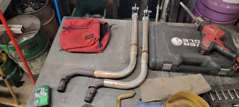

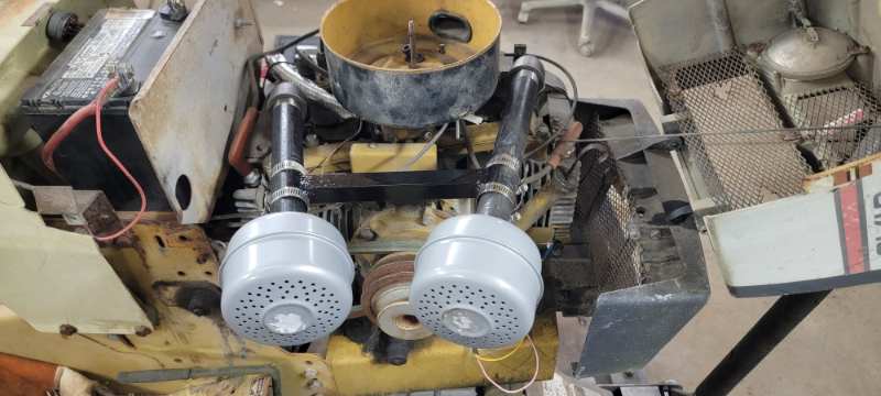

Got a bit of the work done this weekend. We'll start with exhaust - this unit was straight piped to some flappy covers, while fun its also deafening to operate.

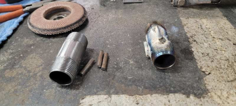

Fortunately the 1" black pipe threads came out relatively simple after chopping the majority of the exhaust away and giving them some nudges with a nice pair of channel locks.
Considering the factory muffler are all used on ebay and a few hundred dollars at that - it was time to embrace the old school black pipe setup!
These are 3" long sections with some 1/4" steel rod welded to them for leverage assistance in the rather congested space of the engine.
Getting a pipe wrench big enough in the space to handle these isnt ideal, these tabs sure make it easier though for pliers.

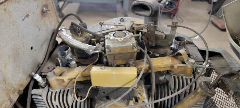

From there i topped them both with street 90°s and then played with varying straight lengths unitl I was able to set 2 of these mufflers outside the hood
Then I made a little spreader piece to keep them tied together and from potentially vibrating themselves free.
It's now much more tolerable to run and operate. Spending around $60 for all the pieces to make it happen.

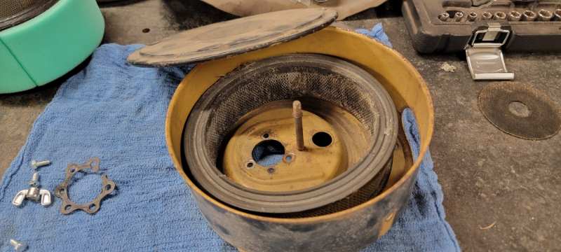

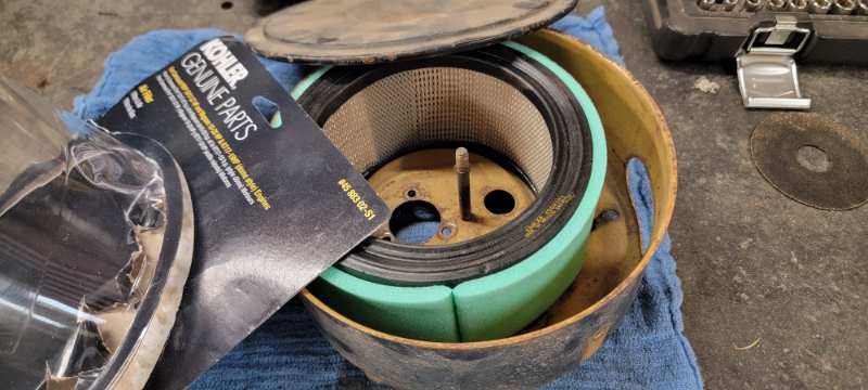

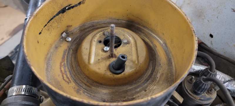

Airbox not only had the wrong filter but was also barely holding on with the 2/3 screws.20250702_112705.jpg.ed41b56bfe359797fc9b5f0cac748ffb.jpg
This filter should do the job a little better

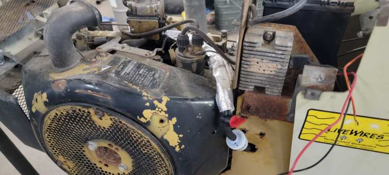

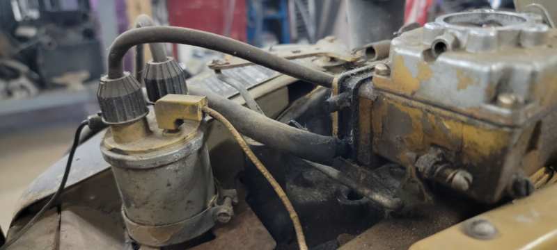

Dirty fuel filter

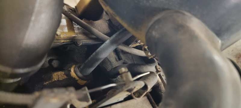

This honestly shocked me... the fuel line was - in a way - just floating on the very edge of the fuel pickup barb on the carb. This tractor does run but barely and you had to keep the choke on the entire time
Simple fix though, new filter and I always have a fuel shutoff in line on my tractors. I had a length of this heat shield and with the prior routing to the left of the coil, I didn't like the bends soo this more relaxed routing near the exhaust warranted the heat shielding in my opinion

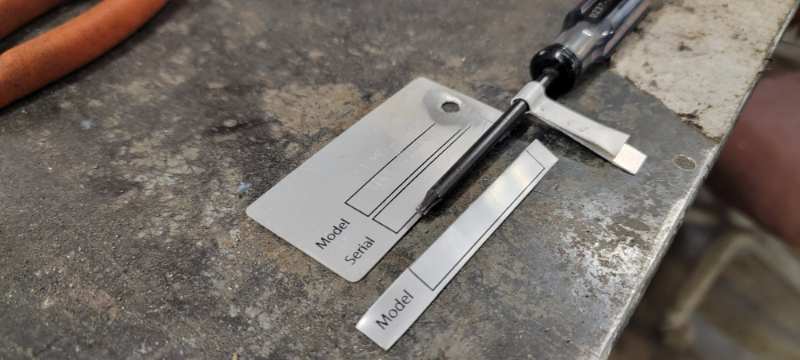

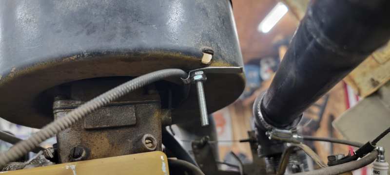

Throttle cable prior to this was just zip tied in place here, as you would guess it dramatically affected the power control of the engine.  My creative solution was to take a small strip of aluminum tag, form it around a small diameter torx driver and then fasten it to the bottom of the airbox. Very simple and much more effective than the ziptie

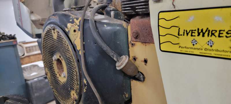

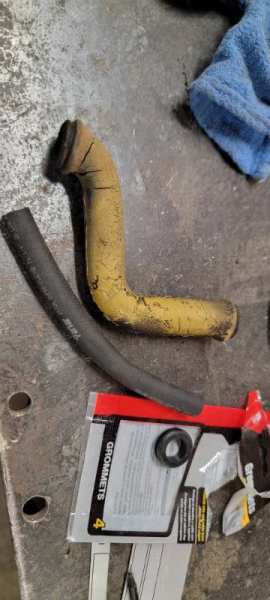

The last little thing was this vent tube from case to airbox. Very much dry rotted and without bothering for a factory replacement I nabbed some  grommets and a small length of extra fuel line to connect the two.

Running much smoother now!

Out of curiosity, did it have a fuel shutoff at the tank? I know all of my garden tractors (and my fullsize tractor) have had one. Of course, adding a secondary one is never a bad idea, especially if the original one was hard to get to.
No fuel shutoff anywhere on this one. I had the fenders off for some work and removed the tank to inspect the underside fuel line - zero shutoff. I would have the shutoff closer to the tank but the pickup tube is no surprise under the tank and into the chassis soo there isnt convenient access until you see the exposed filter.

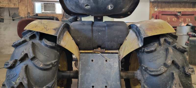

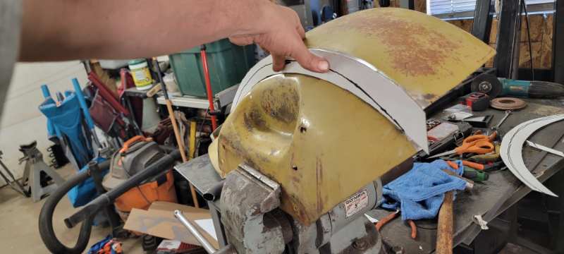

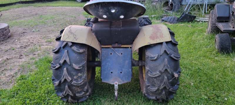

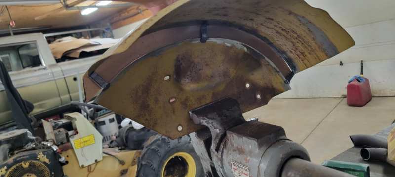

Fenders and tires clearance...
These hog rear tires contact the fenders and while there is no suspension id rather have a little room to lessen the risk of a pinch point

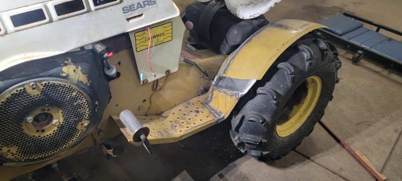

Soo i pulled the fenders off and mocked them up for a 1" lift
This was tricky but turned out well enough.

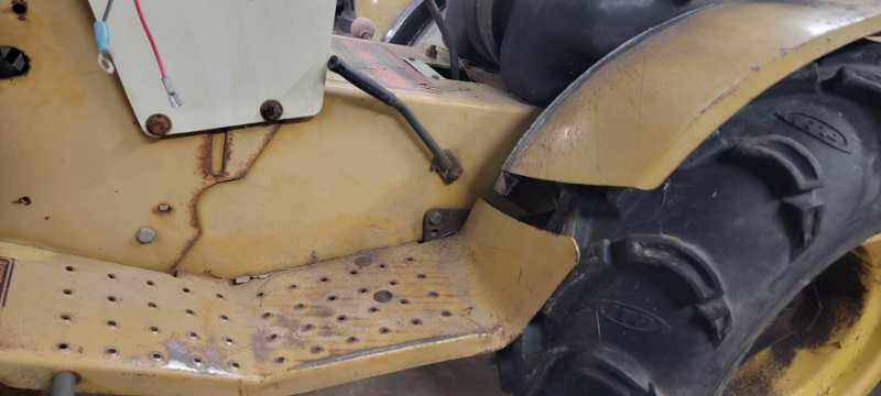

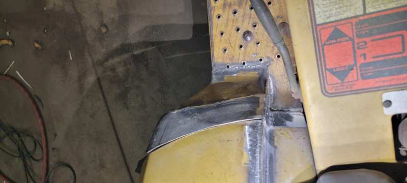

Next a bridged the gap between the footwells and fenders
