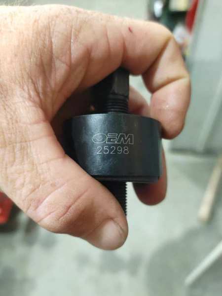

watchamakalit Posted June 27, 2025 Share Posted June 27, 2025 This is the tool you need to remove the pulley. It is pressed on. HTH. Link to comment Share on other sites More sharing options...

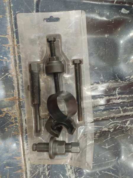

pizzaman09 Posted June 28, 2025 Share Posted June 28, 2025 I rented the tool from advance auto, works very well for both removal and install if the pulley. Link to comment Share on other sites More sharing options...
garyweb3 Posted June 28, 2025 Author Share Posted June 28, 2025 19 hours ago, pizzaman09 said: I rented the tool from advance auto, works very well for both removal and install if the pulley. What do they call it? Link to comment Share on other sites More sharing options...
pizzaman09 Posted June 28, 2025 Share Posted June 28, 2025 1 minute ago, garyweb3 said: What do they call it? Power steering pulley puller. https://shop.advanceautoparts.com/p/powerbuilt-tools-loaner-tool-power-steering-alternator-pulley-puller-kit-648605/9150040-p?product_channel=local&store=6268&adtype=pla&product_channel=local&store_code=6268&&&&&gclsrc=aw.ds&gad_source=1&gad_campaignid=16404424460&gclid=Cj0KCQjwpf7CBhCfARIsANIETVof0o1hqtzNs5K-PC2T4hKau0svRFETh8eeWjxUIJxF71JRq_LFQmkaAnsDEALw_wcB Link to comment Share on other sites More sharing options...
garyweb3 Posted July 4, 2025 Author Share Posted July 4, 2025 On 6/27/2025 at 7:46 PM, pizzaman09 said: I rented the tool from advance auto, works very well for both removal and install if the pulley. Mission accomplished. Link to comment Share on other sites More sharing options...
