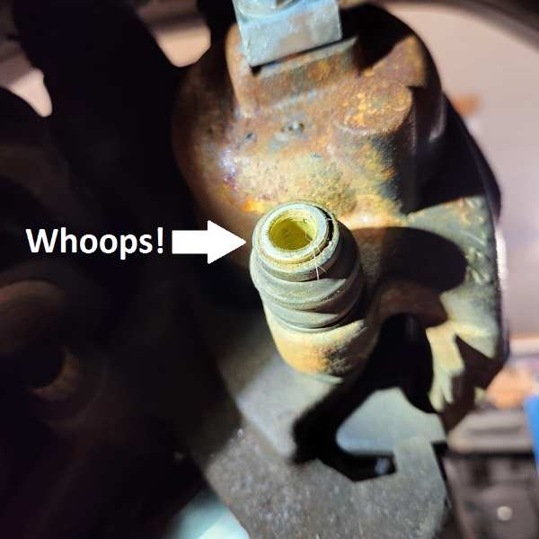

jeff351 Posted May 7, 2025 Author Share Posted May 7, 2025 Ha! Thanks for the advice...I went to pull the passengers side caliper off and noticed a missing bolt. That explains why it made such a racket... Link to comment Share on other sites More sharing options...

jeff351 Posted May 7, 2025 Author Share Posted May 7, 2025 i'm guessing the grinding noise is just severe pad vibration/oscillation from only having 1 bolt. Didnt notice it during my initial crawl-under yesterday. New bolt arrives tomorrow. Link to comment Share on other sites More sharing options...
jeff351 Posted May 10, 2025 Author Share Posted May 10, 2025 Put the new bolt in, and took for a test drive. Can confirm that was the problem. Probably the easiest fix I have had in a long time. Link to comment Share on other sites More sharing options...
