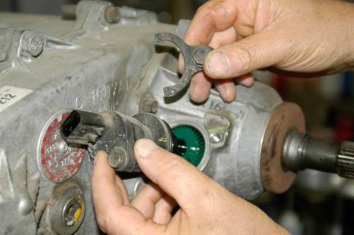

Flexj Posted April 22, 2025 Share Posted April 22, 2025 Any chance your getting bad search results from it being confused with the toyota version of the AW4? Toyota used it in the second and maybe third gen 4runners also... Might be why its showing a speed sensor you don't have. With that being said ive only had manual jeeps never an AW4 but ive never seen the speed sensor anywhere except the t case near the output on any 90s and older jeep... Correct me if I'm wrong but id need a picture of your t case and then id be very surprised if it indeed didnt have any speed pickup sensor there. Picture attached is a google search of the part I am referring to. Link to comment Share on other sites More sharing options...
coolwind57 Posted April 27, 2025 Author Share Posted April 27, 2025 Removed my NSS Neutral Safety Switch, which was only a few years old. Took it apart and it looks fairly new inside. Swapped out with a new one that i got for like $35 and tested my transmission. Shifted normally. PROBLEM FIXED. I thought the NSS was a long shot. Again, internals looks good so I suppose a wiring/connector/harness issue maybe I don't know. Just glad I'm back on the road. Missed my truck. On 4/22/2025 at 1:03 PM, Flexj said: Any chance your getting bad search results from it being confused with the toyota version of the AW4? Toyota used it in the second and maybe third gen 4runners also... Might be why its showing a speed sensor you don't have. With that being said ive only had manual jeeps never an AW4 but ive never seen the speed sensor anywhere except the t case near the output on any 90s and older jeep... Correct me if I'm wrong but id need a picture of your t case and then id be very surprised if it indeed didnt have any speed pickup sensor there. Picture attached is a google search of the part I am referring to. I've confirmed that the SC29 is not on this transmission or transfer case. Even though it shows it fits my 89, it does not. Appreciate your response. On 4/22/2025 at 1:03 PM, Flexj said: Any chance your getting bad search results from it being confused with the toyota version of the AW4? Toyota used it in the second and maybe third gen 4runners also... Might be why its showing a speed sensor you don't have. With that being said ive only had manual jeeps never an AW4 but ive never seen the speed sensor anywhere except the t case near the output on any 90s and older jeep... Correct me if I'm wrong but id need a picture of your t case and then id be very surprised if it indeed didnt have any speed pickup sensor there. Picture attached is a google search of the part I am referring to. On 4/20/2025 at 12:01 PM, llhat said: believe i linked info on testing your sensor above.... This was my next step after the NSS repladement. Glad I didn't have to bother. Thanks for the response. Link to comment Share on other sites More sharing options...
Flexj Posted April 27, 2025 Share Posted April 27, 2025 39 minutes ago, coolwind57 said: Removed my NSS Neutral Safety Switch, which was only a few years old. Took it apart and it looks fairly new inside. Swapped out with a new one that i got for like $35 and tested my transmission. Shifted normally. PROBLEM FIXED. I thought the NSS was a long shot. Again, internals looks good so I suppose a wiring/connector/harness issue maybe I don't know. Just glad I'm back on the road. Missed my truck. I've confirmed that the SC29 is not on this transmission or transfer case. Even though it shows it fits my 89, it does not. Appreciate your response. This was my next step after the NSS repladement. Glad I didn't have to bother. Thanks for the response. Glad you got it fixed! Happy Jeeping! Link to comment Share on other sites More sharing options...
