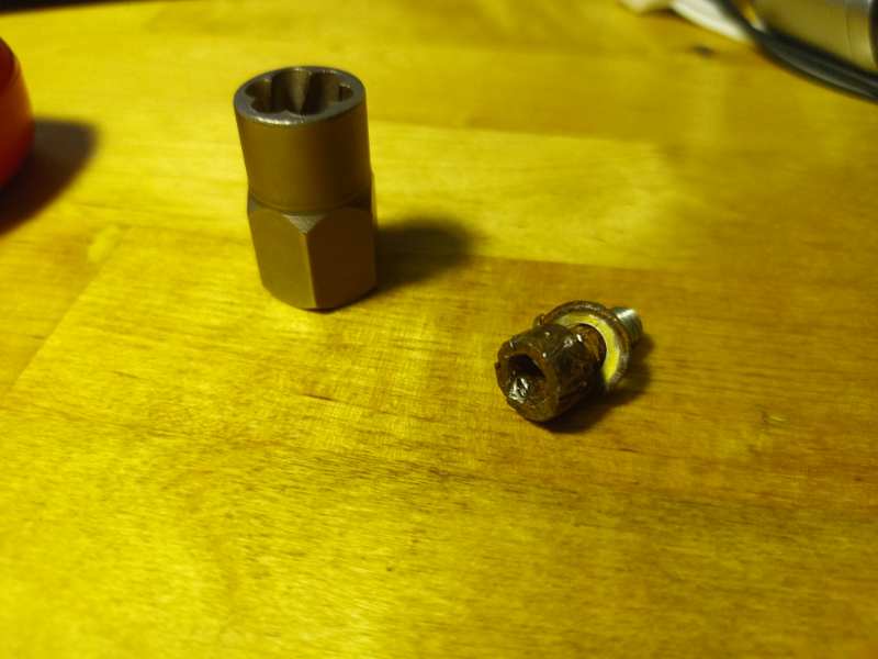

Pete M Posted April 14, 2025 Share Posted April 14, 2025 after removing the rotted exhaust and drilling a 2" access hole in the side of my CRD Liberty's wheel well, I was able to use a Kobalt 3/8" bolt extractor to remove the rusty metric bolt that holds the CPS in. tomorrow I'll try replacing the CPS and then work on the new exhaust. Link to comment Share on other sites More sharing options...
eaglescout526 Posted April 14, 2025 Share Posted April 14, 2025 Those arent special like the Renix CPS bolts are they? Link to comment Share on other sites More sharing options...
Pete M Posted April 14, 2025 Author Share Posted April 14, 2025 looks like a standard torx bolt. it spent a decade in the salt and had nothing left of the splines. I intend to take it to lowes and see what exists in a stainless variety. Link to comment Share on other sites More sharing options...
eaglescout526 Posted April 14, 2025 Share Posted April 14, 2025 Sounds like a good plan! Link to comment Share on other sites More sharing options...
pizzaman09 Posted April 14, 2025 Share Posted April 14, 2025 Congratulations on getting the stubborn bold out. With torx, I have found that sometimes you can pound a 1 size larger torx bit into the hole and use it to drive out the bolt. Link to comment Share on other sites More sharing options...
