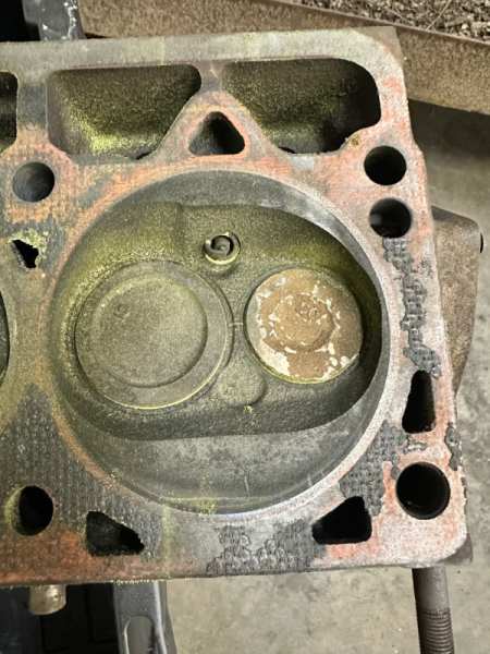

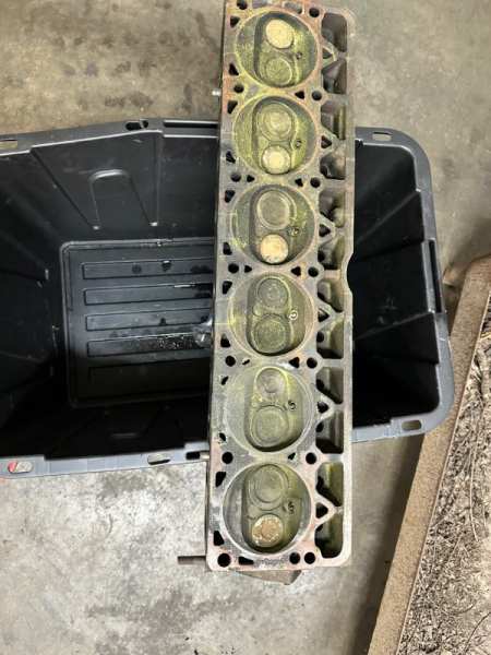

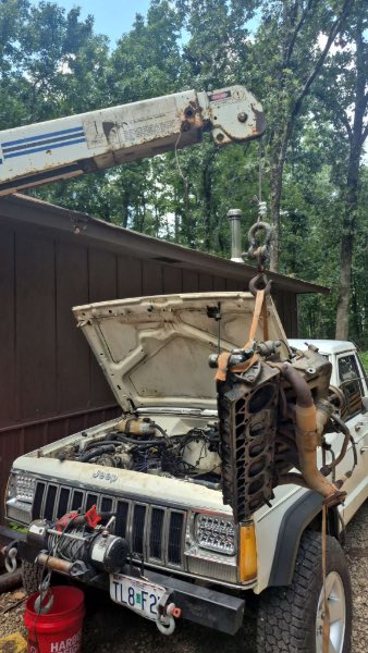

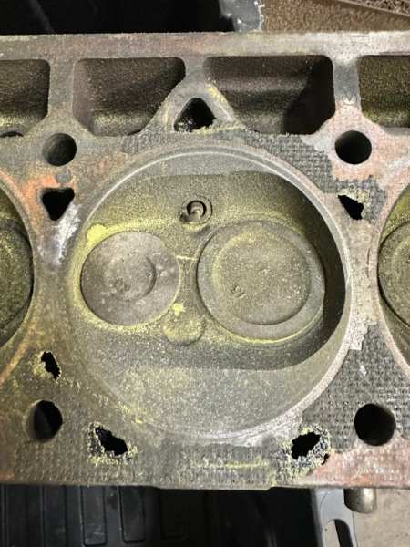

HuntinHopin Posted August 7, 2025 Author Share Posted August 7, 2025 Finally got the lift completed but unfortunately, on the way home from the shop, it overheated and left us stranded on the side of the highway. $100 tow bill later we got it home and started diagnosing. Figured out it was either a blown head gasket or a cracked/warped head. Tore apart and dropped it of at the head shop which revealed two cracks. Currently looking for a used head so we can get this thing back together and get him back on the road. Hoping to have it finished up before school starts on the 20th so he can drive the coolest truck on campus on day one. Link to comment Share on other sites More sharing options...
