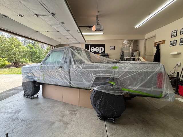

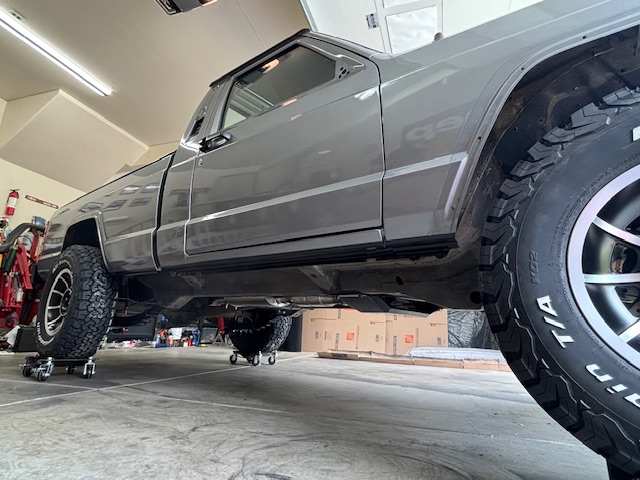

MJ was wrapped like a burrito before I matte black sprayed the rocker areas cab and bed sides.
And… done. Will see if I can get to laying the graphics on Sunday. Should be an adventure.

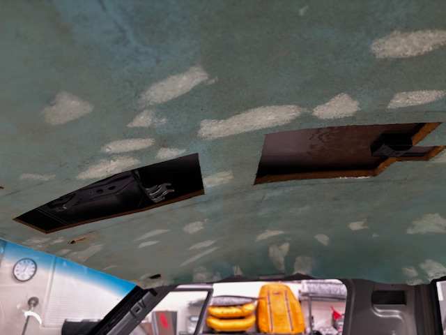

Some early morning progress attaching the overhead console rear-most mounting bracket to the MJ’s roof, and test fitting with the headliner board in place. Success.

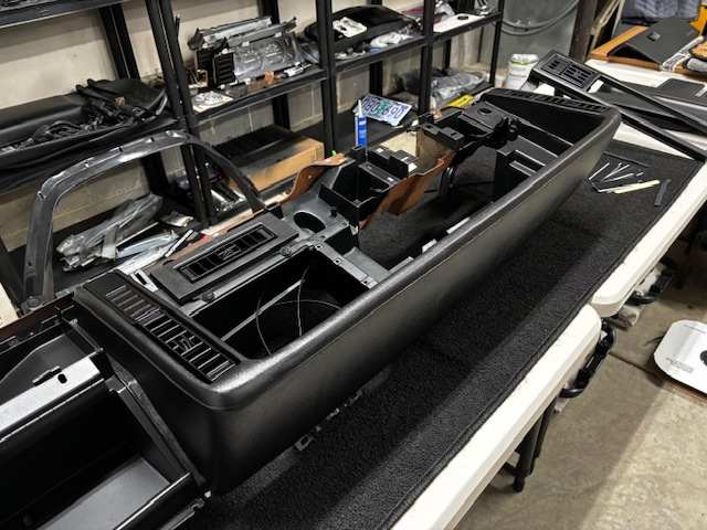

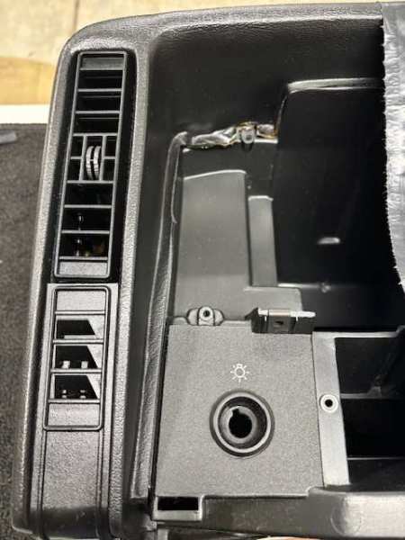

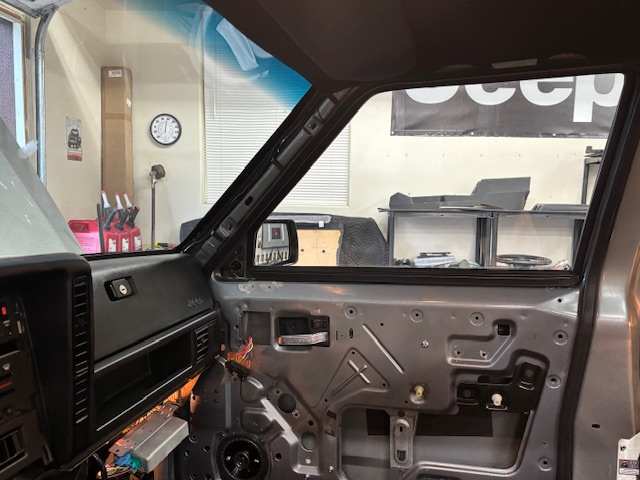

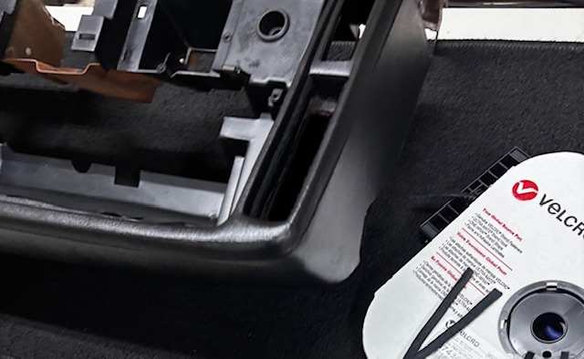

Details… I replaced the old felt surrounding the rectangular HVAC vents dashboard side with adhesive-backed Velcro 1/4” strips. Also replaced the small bit of felt bottom side of those rectangular HVAC grille/vent inserts, and top and bottom on the passenger side square grille/vent just below the glove box. Last important detail for the “new” dashboard is the old ’91 VIN plate. Can’t exist without that.

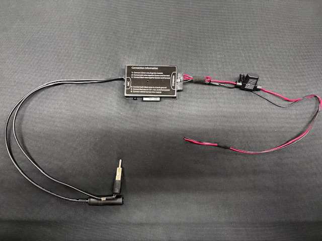

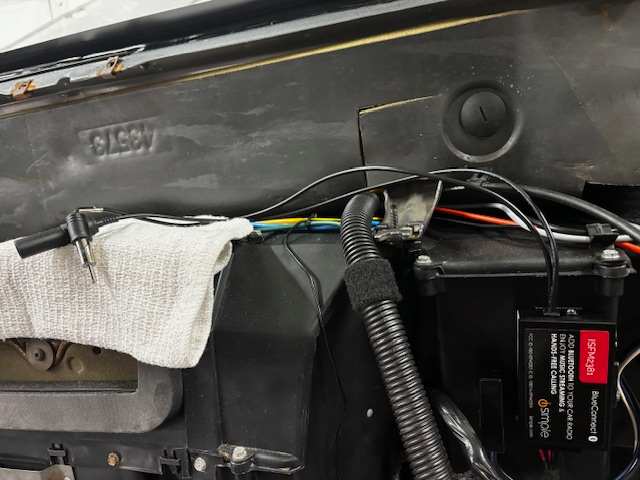

As with my other MJ, I’m using a factory NOS ’87 AM/FM radio with add-on BlueTooth. The BT vendor I went with prior (Redi-Rad) that tailored his business to classic car owners has since retired, so using a new solution – iSimple. It has phone capability included if the head unit had an aux port but mine does not, so I removed the extra wires. Now it’s just antenna coaxial connections, power, and ground.

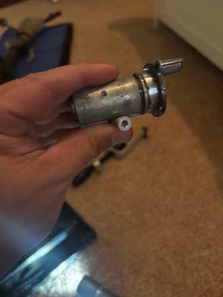

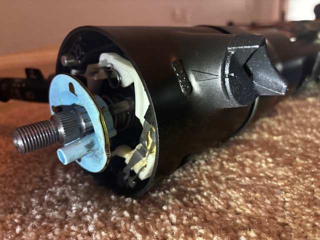

Got the vents cleaned up and clipped into place. Also, dug into the NOS AW4 steering column to swap out the ignition cylinder (for single key setup) and add cruise control stalk. I’ve taken many XJ/MJ columns apart and this was the first to have a slotted ignition cylinder retained by a torx bolt. Had me stumped for a bit, as was trying to figure out where the retaining clip went. Column had a manufacture date of 2/89. Found a NOS horn cam that is on its way, complete with the spring and horn plunger.

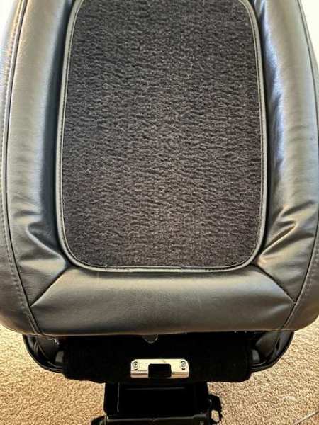

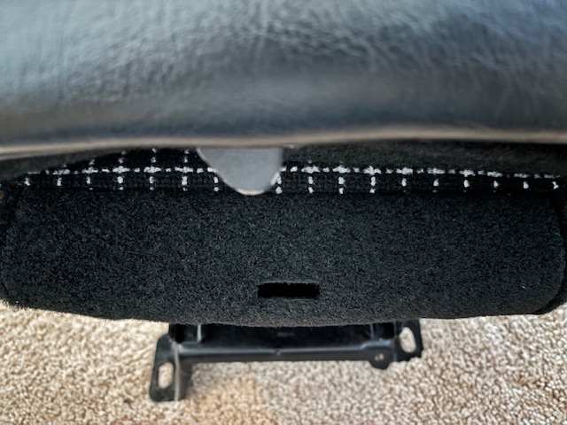

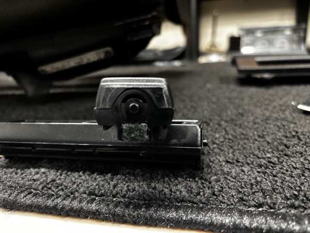

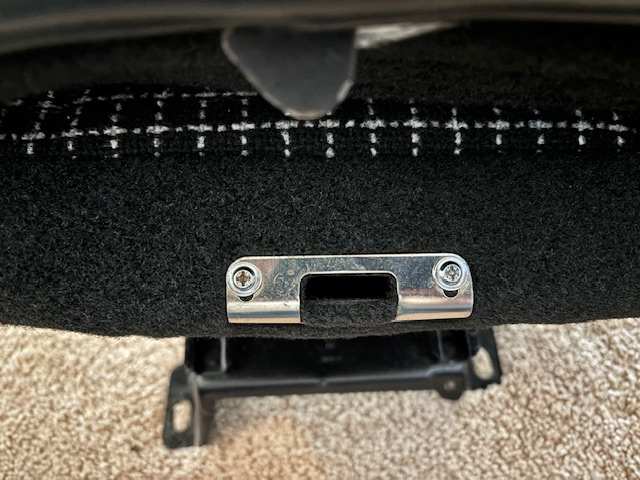

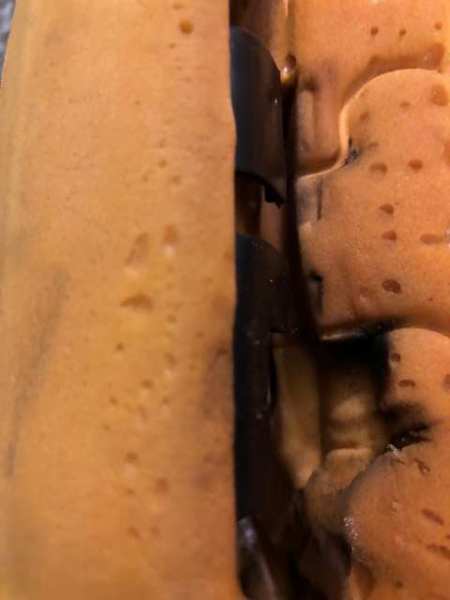

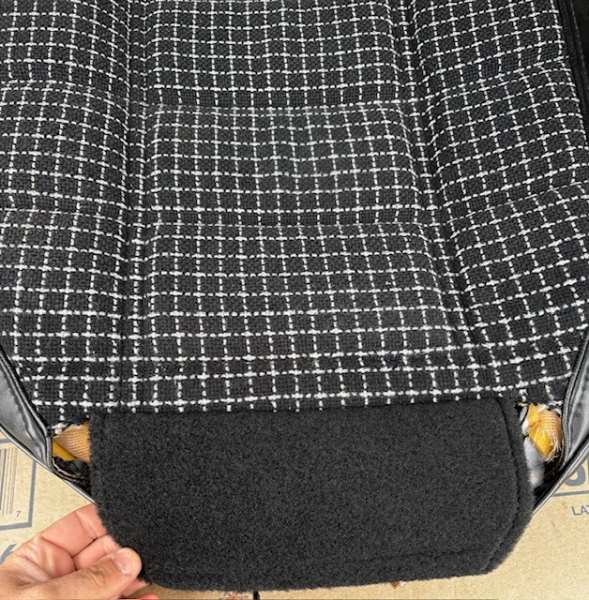

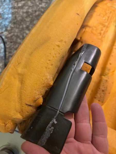

One thing that’s not fun moving to a new area is finding trusted specialty shops – for upholstery, powder coating, etc. Being only a year into our place, I set out a few weeks back to find a local upholstery shop. I talked to several large shops that didn’t quite feel right. Then I found a one-man 30 year shop that listened to what I was asking for and was clear on attention to detail. Perfect. My black Mesa seats were near flawless; except for the vinyl flap bottom side of the seat that takes a beating from the tumble latch, chrome trim bezel screws, and no longer existing seat ‘bumpers’ that are long worn off, leaving an exposed bolt head to tear things up. I’ve always liked the look and resilience of the MJ backwall carpet material. It’s perfect for this spot – provides cushion and does not tear. I'll cut the needed holes once the seat bottom is in-place on the seat frame so no mistakes.

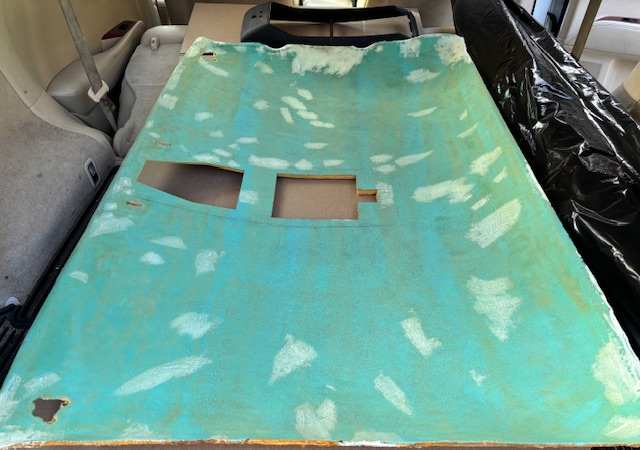

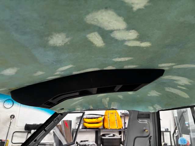

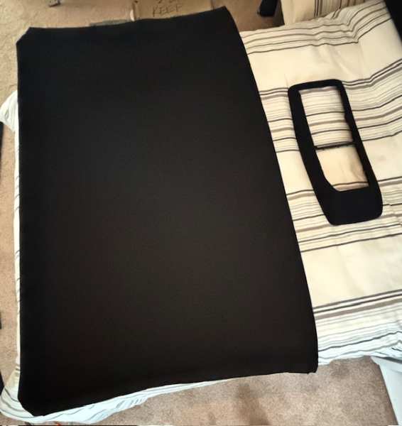

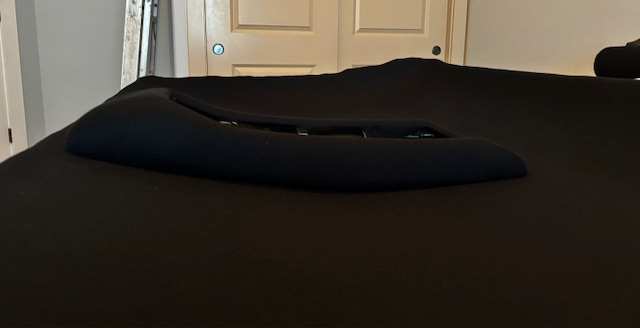

Just dropped off my headliner and overhead console today to get recovered in black by the same shop. I’ll handle the visors as I’m retrofitting black Ford vanity mirrors in as I did for my ‘Son of Stink’ MJ project. These were one year only visors used when Jeep reduced the size of the MJ/XJ sun visors in 1990. 1991+ saw another style vanity mirror. The 1990 year is the only year offered in black – by Ford, but on a 2003 full size Crown Vic, Mercury and Lincoln auto – and it’s identical to what Jeep had used in ’90. Crazy I know, got to have a molded black vanity mirror…

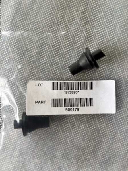

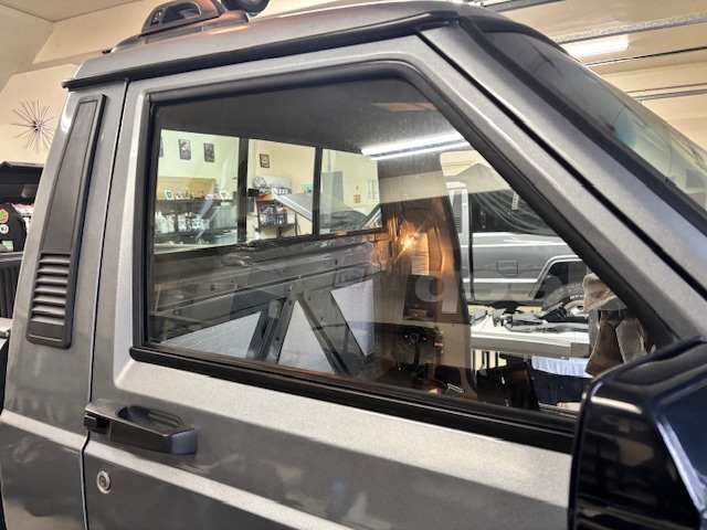

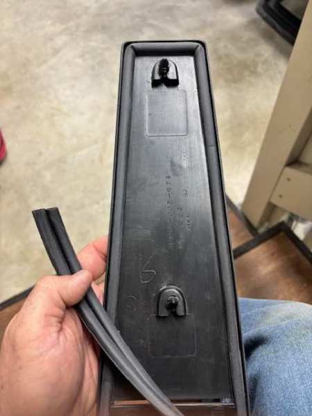

Got some little things done – The exterior B-pillar vents got new weatherstrip backside, my original single key glovebox lock is in place, and the ’86 dashboard headlight icon bezel has been replaced (fog light-like design) to the ’87-’96 style light icon.

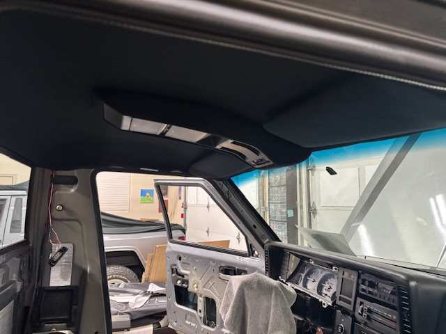

Headliner overhead console related cuts made, and test fit looks good.

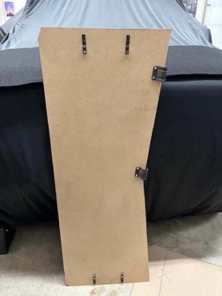

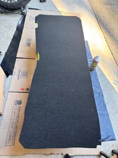

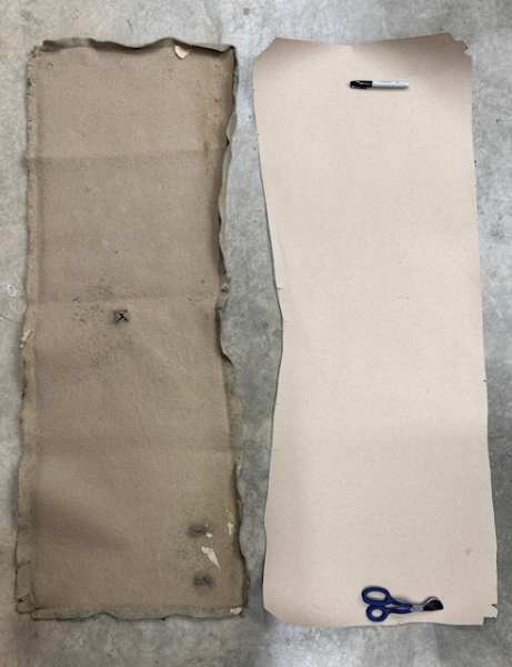

The cab carpet board was ready, so I cut a paper template off the original and transferred it over to the black roll and laid it out. This is a new board without holes as I’ve moved all spare jack-related equipment under the hood. DEI Spray Adhesive has become my go-to over 3M, as it doesn’t come out as ‘wet’. The board is currently drying, then I will wrap all material around as needed and call it done.

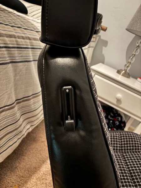

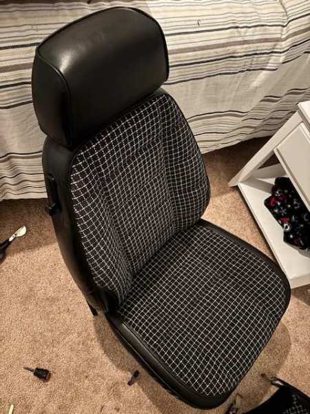

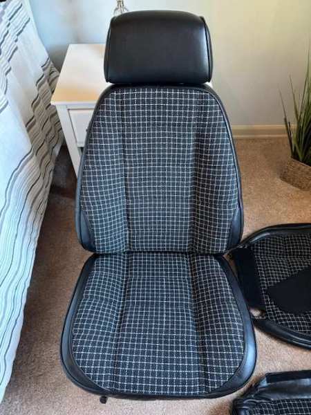

Passenger seat is 98% done – just need to install the tumble and recline trim. I’ll Zymol vinyl condition these as it will be a couple months before I’m ready to install them. I forgot how much fun this style seat is when it comes to installing upholstery. I used .7 ml plastic help with the slide, but it wasn’t much help. The bigger bolster Laredo/Limited seats are much easier to navigate the install.
Got the seat bottom flap into place then cut so it is centered and neat. The only way to go. Driver seat is up next.

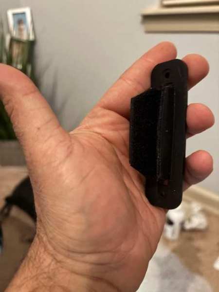

Amazing how much you can bleed from upholstery installation. The passenger seat is done… Final details to do was to add the soft side of sticky-back Velcro to line the inner portions of the tumble bezel. The Velcro hides the ugly yellow foam, vinyl threading, etc. Looks more finished.
I need to pause a day on the driver side seat assembly as I forgot to re-affix the plastic clips that are glued from the factory to the foam inner backside wings. Glue takes 24hrs to dry. These clips attach the seatback foam to the seat frame on the lower backside. I’m sure with would be fine without but prefer to have it as the factory did.

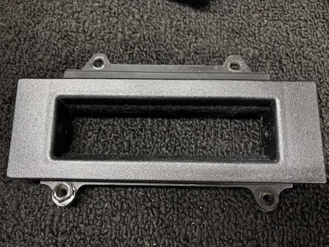

Polished the instrument cluster lens and painted the gauge cluster surround black. I’ve never been a fan of the charcoal, especially in a black interior. Cleaned and re-glued the light panel to the left as the double-sided tape was shot. The original owner had swapped out the instrument cluster for one with a full gauge (originally this was a column shift MJ) and selected a ’96 XJ donor as it has a ‘GEN’ light that no other first gen truck did. I tossed that overlay and put the true to the year OBD1 lens on.

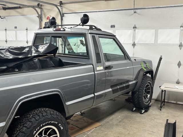

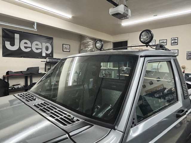

I wanted lights up top, so decided to go with a fixed MJ light bar using XJ roof rack. There will only be 1” of rail showing either side of crossbar slide. Rails still need to be trimmed down. All wiring will be run inside the crossbar and out drivers side corner under rail. Will hardly see it. Nice and pretty. This MJ is my beater/ runner and will sport a camper shell when needed, so I opted away from the factory rollbar. The graphics sported are not for this truck — this one will be a ‘Comanche Chief’ clone. 90’s repop Ford 3rd brake/ cargo light combo in place but not screwed into place just yet.
That would be neat. I'll look into it. Even at 18ga, would probably only be able to get one wire down per bolt. Currently I trust a wire grommet best (again, hidden under the roof rack rails). I found this one on Summit:

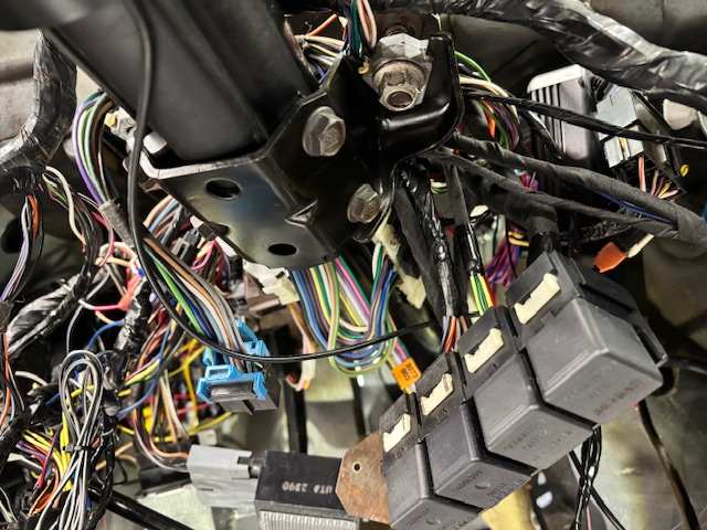

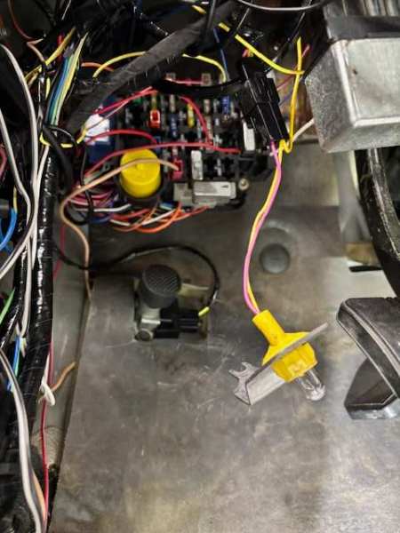

Got the dash wiring back to near ship-shape. Took the better part of a day as I had the fuse box pulled apart, having added all sorts of things to the MJ’s electrical over the past many months. I’m aiming to tackle HVAC charging/ testing this week so I can move forward on the interior assembly. High hopes!
