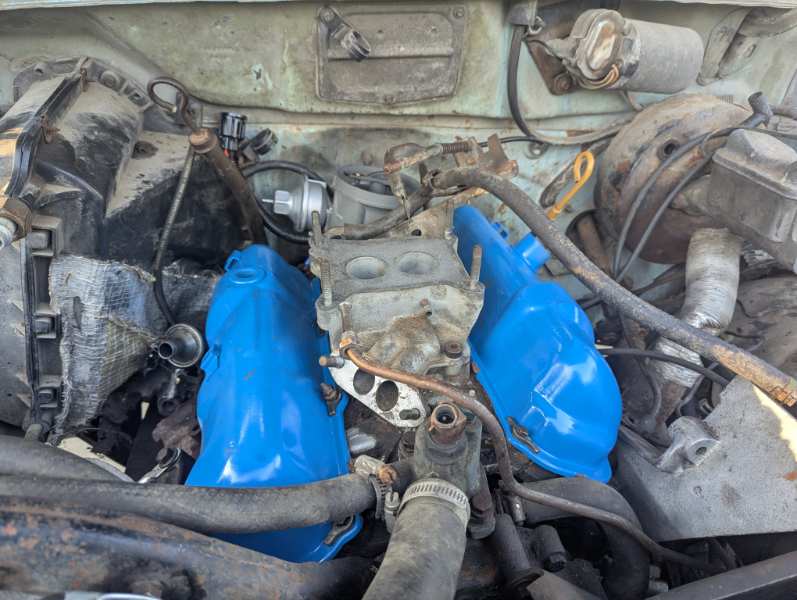

Spinnakerblue89 Posted July 16, 2025 Author Share Posted July 16, 2025 16 July, 2025 Update: It ain't a project til ya paint the valve covers!! I don't have other rocks going on but basically, it runs and it doesn't run. I did the Duraspark Conversion that surprise-surprise- some Jeep owners do as well. Before I did the conversion, it would start, but had a gas leak at the carb. Not only that, the valve covers were leaking and the valve lash likely needed set anyways. So because of the perfect storm, I decided instead of rebuilding the old feedback 2150 Motorcraft carburetor, I'll just start the conversion process. Now, this is mostly for the Full-Size Jeep crowd, as I understand it. A lot of older, really end-of Malaise Era Fords up to about 1985, have a lot of government intrusion under the hood and a lot of that- including the computer- can be done away with if you set up a Duraspark or similar ignition systems. My knowledge is fairly limited on the subject, but I believe that similar-era Jeeps that utilize Motorcraft carburetors can be Durasparked as well. The benefit is debatable, but noticeable. Meaning, whether you get improved fuel economy or power is hit or miss, I think. But what is noticeable is the cold starts are improved, engine idle and performance in general is improved. Reliability is improved. There are less sensors that get in the way. Really, an expert can tell you more. The really way to make the new ignition system shine is by utilizing a GM HEI ignition module, which simplifies and improved reliability, as well as spark output. So truly, it's a hybrid ignition system. Lots of wires, a computer, and relays were removed. Link to comment Share on other sites More sharing options...
eaglescout526 Posted July 16, 2025 Share Posted July 16, 2025 That engine bay will make anyone appreciate the XJ/MJ 4.0Ls lack of room. Link to comment Share on other sites More sharing options...
89 MJ Posted July 16, 2025 Share Posted July 16, 2025 This very much reminds me of my Eagle. I ripped off the computer controlled garbage and slapped a 2150 and HEI dizzy in its place. Felt like it doubled the horsepower of that car. Link to comment Share on other sites More sharing options...
Spinnakerblue89 Posted July 17, 2025 Author Share Posted July 17, 2025 18 hours ago, eaglescout526 said: That engine bay will make anyone appreciate the XJ/MJ 4.0Ls lack of room. Funny you should say that. The picture doesn't do justice at all. But hear me out: There actually is plenty of room to do just about everything. It actually has more room than my 4.0 MJ and certainly my 4.0 ZJ. However there is one supremely serious flaw to this layout. Equipped with AC from the factory, spark plug #3 is extremely difficult to replace. On the left side of the picture, you'll notice a large black box mounted to the firewall, and a disconnected silver tube sticking out kinda below it... Yeah, that's all in the way of cylinder 3. This is one of those things that make me say "sometimes those Chevy guys do get the last laugh." 17 hours ago, 89 MJ said: This very much reminds me of my Eagle. I ripped off the computer controlled garbage and slapped a 2150 and HEI dizzy in its place. Felt like it doubled the horsepower of that car. I was not aware the Eagle shared that mod with its Jeep cousins. How was the idle? How were the MPGs? Link to comment Share on other sites More sharing options...
