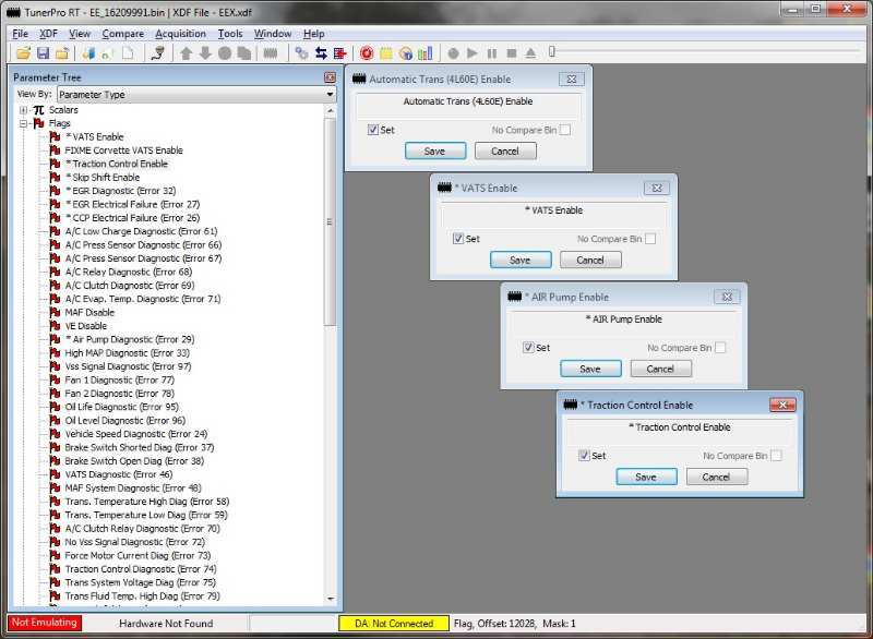

Gojira94 Posted September 16 Posted September 16 (edited) On 9/12/2026 at 2:14 AM, FigurativeGarbage said: the PCM I ordered years ago was actually for a 94-95 automatic, not a manual. Unclear if that matters You said you'd rather avoid tuning if possible, but there is a flag in the V8 and V6 F-Body calibrations that enables or disables all configured parameters for auto trans. This screen shot is from TunerPro RT, showing a factory calibration for a '94 LT1/ auto. With TunerPro, the L32 V6 datastream definitions (.adx) for logging are easy to find, but the .bin definition files (.xdf) are a bit harder to come by. TunerCat is a good product, I wouldn't hesitate to recommend it if you decided to pursue some edits in your PCM calibration to solve some issues. Point being you can do things that would remove some headaches. Edited September 22 by Gojira94 edited for clarification

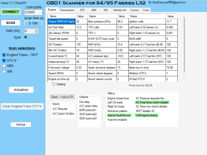

FigurativeGarbage Posted September 22 Author Posted September 22 Thanks, Gojira. I have some things to work with just from an initial scan tonight. I don't see a VATS issue if I am reading the data correctly. But I do see low battery voltage while cranking (7V to 8.5V per a multimeter and the computer). I'll have O'Reilly's check and charge the battery, then I'll check again. It could be the starter is pulling too much power (misaligned?). There is an injector fault indicator, which might be wiring. I see a MAPS error, but I think that causes the PMC to use a default number and it would still fire. The MAPS connector is damaged, so I'm not very surprised. I have a spare MAPS if it's not the connector.
coheed Posted September 22 Posted September 22 If there's an issue with VATS you would have an error show up in the DTC tab that's titled something to do with Passkey. If no DTC, then your VATS bypass is working fine. But, if there is a VATS issue it will also throw an injector fault on that main screen.
