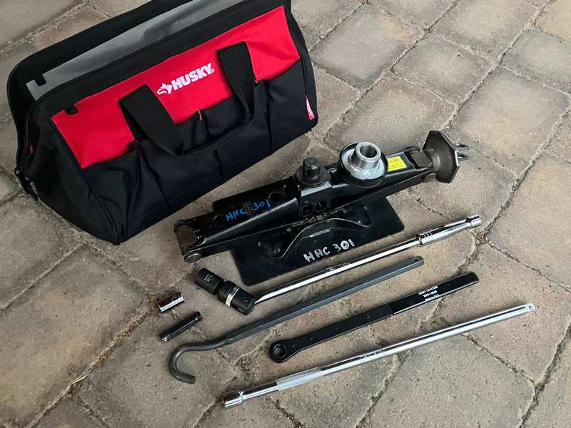

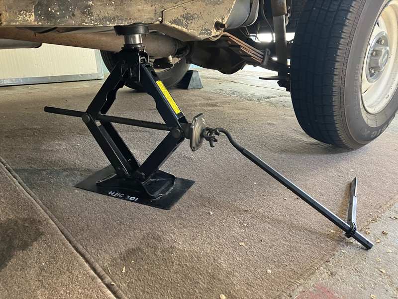

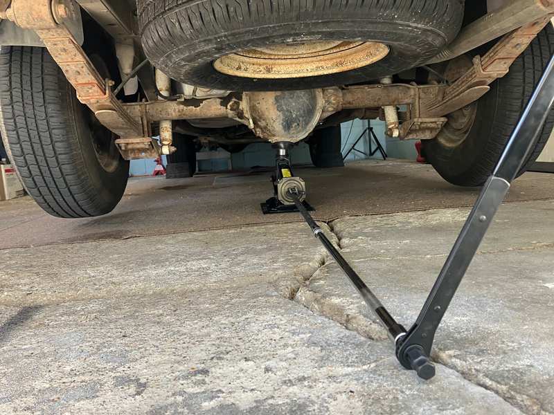

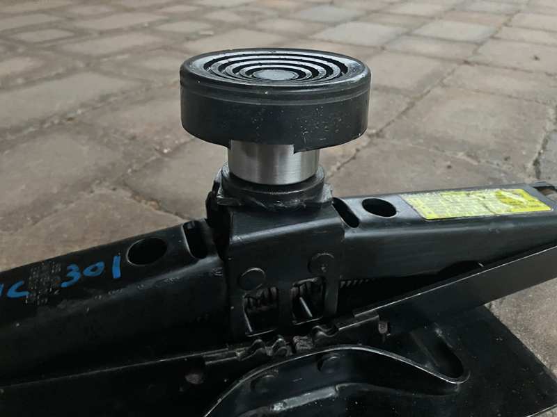

The process took some time, but I finally compiled all the tools to create an H1 scissor jack solution for my Jeep. Everything fits inside a 24" Husky bag.

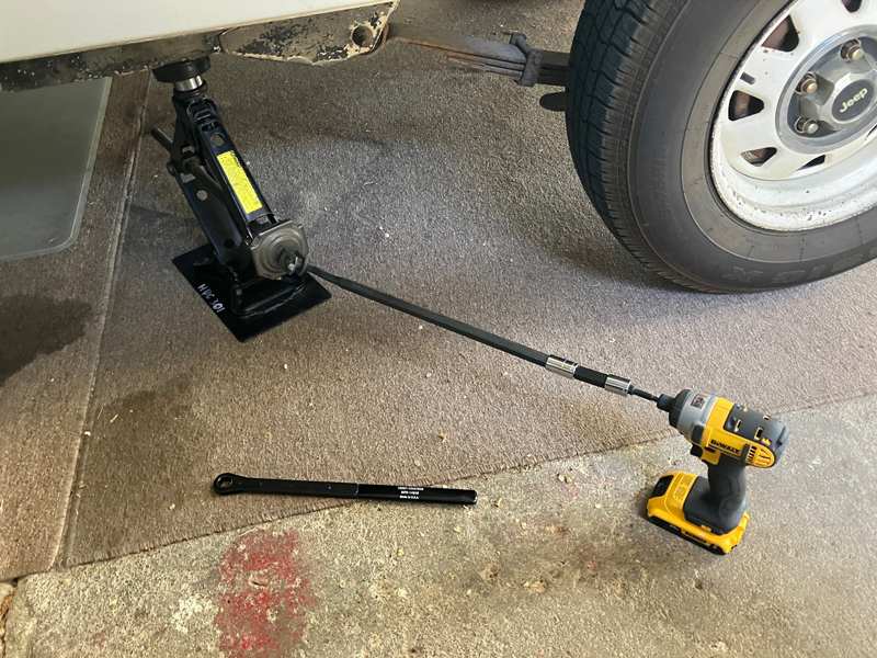

My goal was to create a tool kit that had flexibility without anything superfluous. This scissor jack functions great to accommodate a floor jack, or even as a very good alternative I've found out. It has great lifting height and the flat plate is very large to put some wood underneath if needed. Operation can be motorized as well.
I have this nestled behind the passenger seat in my MJ. Even though there is very little cab space, there is actually plenty of room for this back there. But before lifting the bag, I'd recommend removing all the tools first because it's rather heavy.

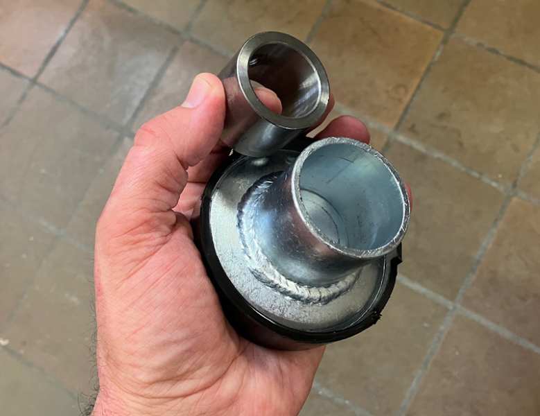

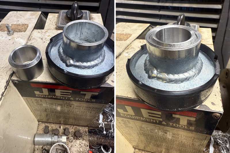

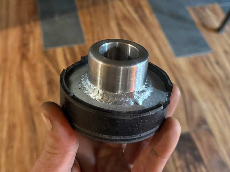

The saddle adapter was bought from 911 Motorsports. I had to source a spacer, however. The H1 scissor jack pin is 1-1/8", but the ID of the saddle adapter is 1.5". My friend at work lent his metalworking skills to make a finished piece. He did very nice lathe and welding work!
There is not a situation that this combination cannot handle.
Kit Includes:
• 5/8" Hook Drive
• 5/8" Wrench
• 20" 1/2" Drive Extension
• 1/2" Drive 5/8" Socket
• 1/2" Square to 5/8" Hex Drive Adapter
• 1/2" Drive 18" Ratcheting Breaker Bar w/ 13/16" Impact Socket

Hell yeah! That's an excellent adapter you made. This scissor jack is properly chunky where it counts. It sure comes in handy!

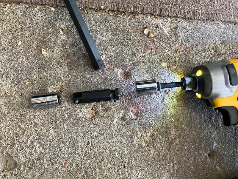

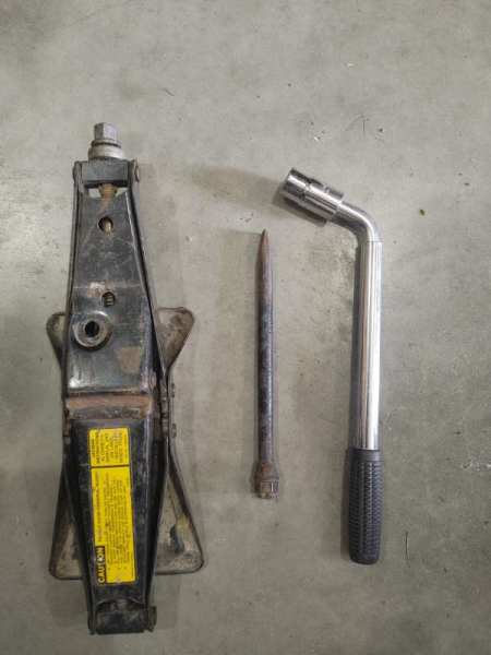

I'll have to get a pic of my jack and lug wrench setup. I think between your setup and mine we are getting close to perfection.  :roflmao:I have a scissor jack (I think from a xj) that I chose because it is a hex head drive not the hook like the h1.  I can only imagine the h1 jack is much more substantial.  I also have a custom made tool for lower the spare winch and a lug wrench with extendable handle and a double sided socket.  Between those and typically having my battery impact along there isnt much roadside\parking lot repair I can't handle.  And the battery impact isn't necessary, just saves a lot of hand cranking.   I'll try to remember a pic in the morning.
