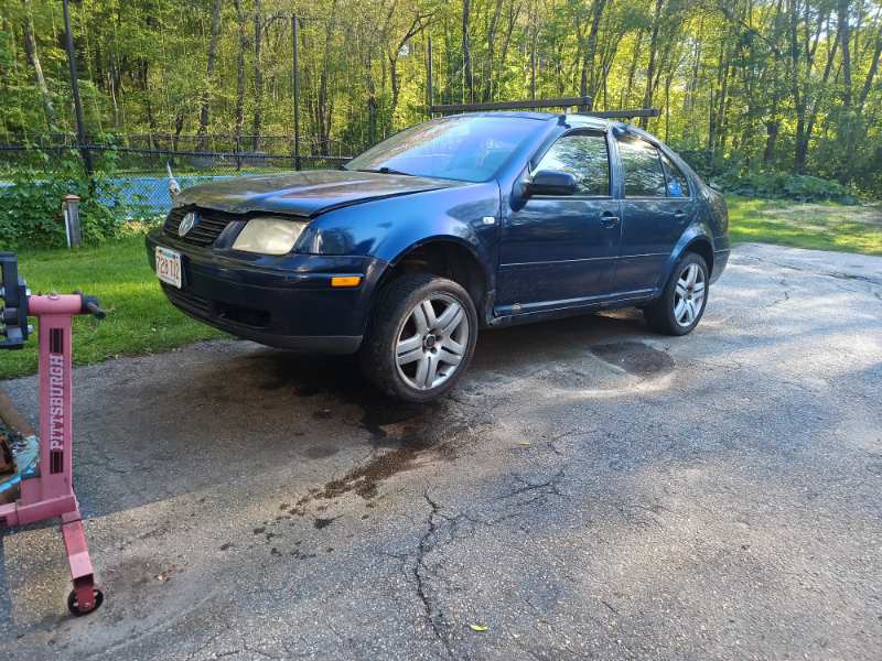

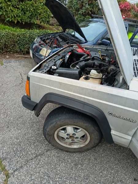

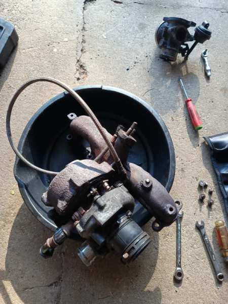

An update here is long overdue, and ill come back to the suspension situation later, but this week I got my brothers old jetta TDI running to investigate the engine swappability. Its been sitting for awhile and the turbo actuator is seized. We initially thought the turbo vanes were coked up, so I had the pleasure of removing the crusty old manifolds and cleaning everything.
All in all it has potential, so I'm gonna soup up the engine while its still in the jetta, then strip down the wiring to be stand-alone, and mate it to the ax15/np231 out of the '88. This will all be dropped into the donor '89 chassis.
For those familiar with that scene, its an '02 ALH engine getting .260 injector nozzles and a Burpod tune, keeping the stock turbo, for now, which should put the torque output somewhere around 230-240ft/lbs, which is about the same as the stock 4.0L, but with half the weight.
This is not going to be a quick process, but I will try to provide updates as often as things occur.
