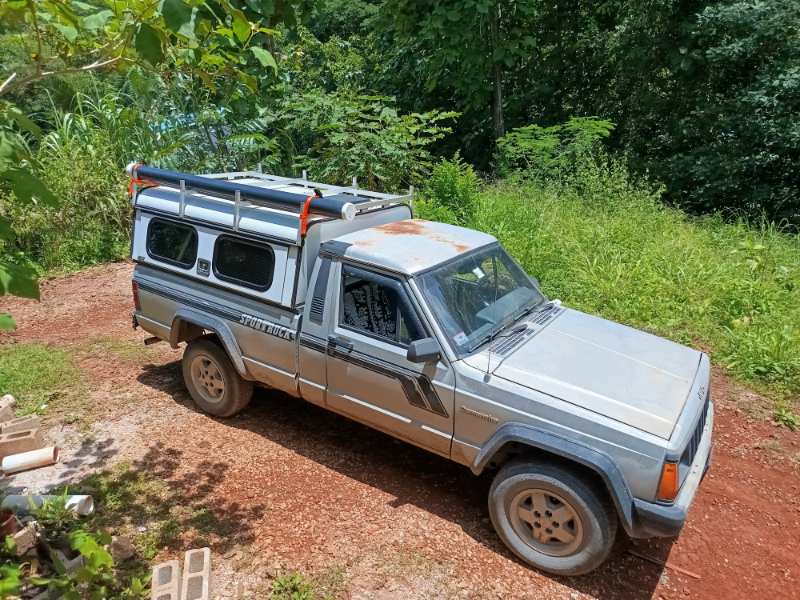

GonzoTheGreat Posted February 13, 2024 Author Share Posted February 13, 2024 On 2/1/2024 at 6:43 PM, coheed said: Love a contractors cap on an old truck. Looks great Thanks! I'm happy with how it turned out I had to narrow the bit between the taillights 3" and I screwed it onto some plastic 2x4s to meet the bed rail width. The cap is just a couple inches too wide to fit directly. Fitment was perfect. I've got about an eighth to a quarter inch clearance against each taillight. I also siliconed the 2x4s before screwing them on, and I ran rubber strips between the bed rails and the cap, so hopefully it's fairly water-tight. I've also had a significant sag to the drivers side since I got the truck. So I swapped in new leaf springs today, and that helped. I've got new coils to put in when tomorrow's snowmaggedon is over. I also put in a pair of shackles that are an inch longer than stock, because I had them lying around. It sits high in the rear, but I figure once I have new coils in, and the bed loaded up with all my tools and crap, it'll probably level out. I was planning on fighting every bushing bolt. I expected them to all be seized to the inner sleeves, but I was shocked to find that only one of them gave me trouble, and with a little heat, it popped right out! I'm not used to working on project vehicles with only 60k miles. This is nice. Link to comment Share on other sites More sharing options...

GonzoTheGreat Posted April 5, 2024 Author Share Posted April 5, 2024 I had some time to get into the door cards this week. The driver side door check was never functional, so I put one in from a later XJ with the rubber stopper. While I had one door open, I figured I’d open the passenger side too, and put in the pair of ~96 XJ vinyl vapor barriers I had been carrying around. it stopped the draft I was getting around the door handle, and maybe it’s a placebo effect, but I think it cut down on road noise. I also really didn’t love the look of the bed cap at first, but it’s kind of growing on me. Link to comment Share on other sites More sharing options...
