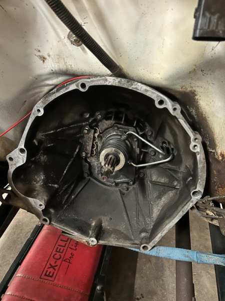

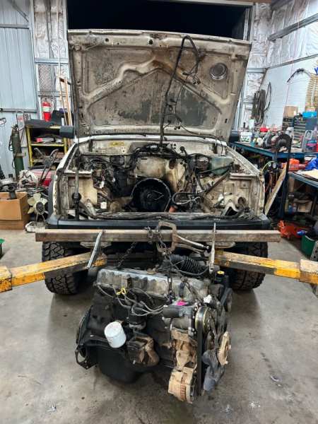

Warren99 Posted July 27, 2025 Author Share Posted July 27, 2025 Fast forward to now, here’s where I’m at f53e91e23d034f2997ce880070920e1c.mov But of course what would an engine swap be without running into a problem. I didn’t realize it but the adapter plate/flywheel and clutch kit I bought was actually made for an external slave cylinder ax15. I did some measurements, and the distance from the block of the 4.0 to the clutch fingers is about 7/8 of an inch from the distance from the new adapter plate and the new clutch fingers. So I think if I just make like a little spacer to sit behind the internal slave cylinder, it’ll all line up right. The measurements for the pilot bearing and spline engagement already check out so those should be fine. BUT, if anyone happens to have an external slave ax15 laying around, or just the bell housing and parts for it, let me know please. Because if this doesn’t work then I’ll have to just adapt over to an external slave setup which I’ve seen the parts going for $600-$700 Link to comment Share on other sites More sharing options...
