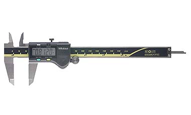

JeepcoMJ Posted December 13, 2007 Posted December 13, 2007 micrometer or something of the sort. outside caliper. either way you're gonna have to get a measuring tool to get it right.

feerocknok Posted December 13, 2007 Posted December 13, 2007 This is one I have to deal with all the time at work. Eagle's idea is pretty keen though! May have to suggest that to the people that call without a caliper.
Eagle Posted December 13, 2007 Posted December 13, 2007 LOL I have three dial calipers, two digital calipers, and a couple of micrometers. But front sway bars are usually dirty and messy, and I just don't see the point of measuring to three decimal places when the tolerance is an eighth of an inch. The open end wrenches are handy, easy to use, and easy to clean up after "measuring."
