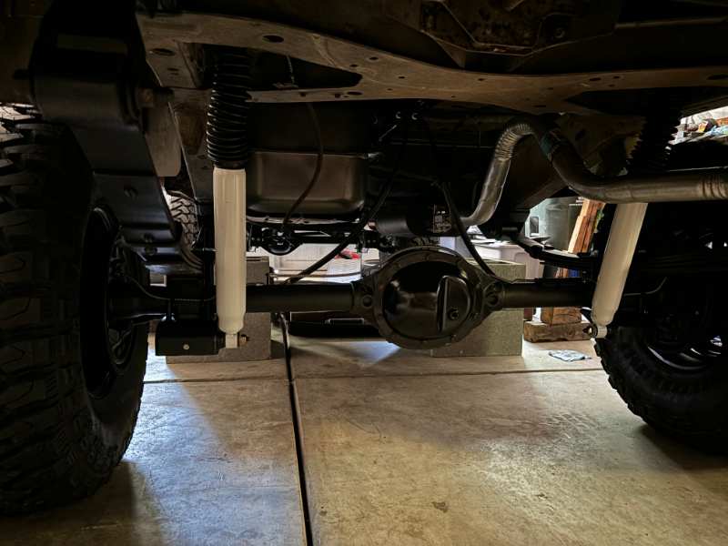

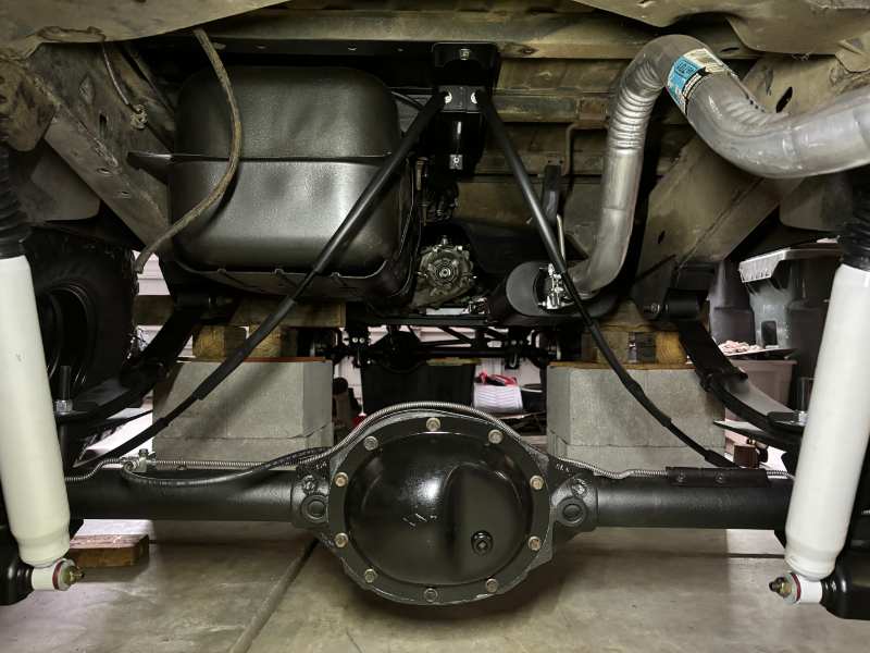

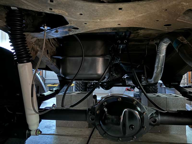

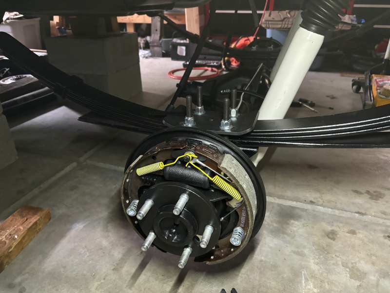

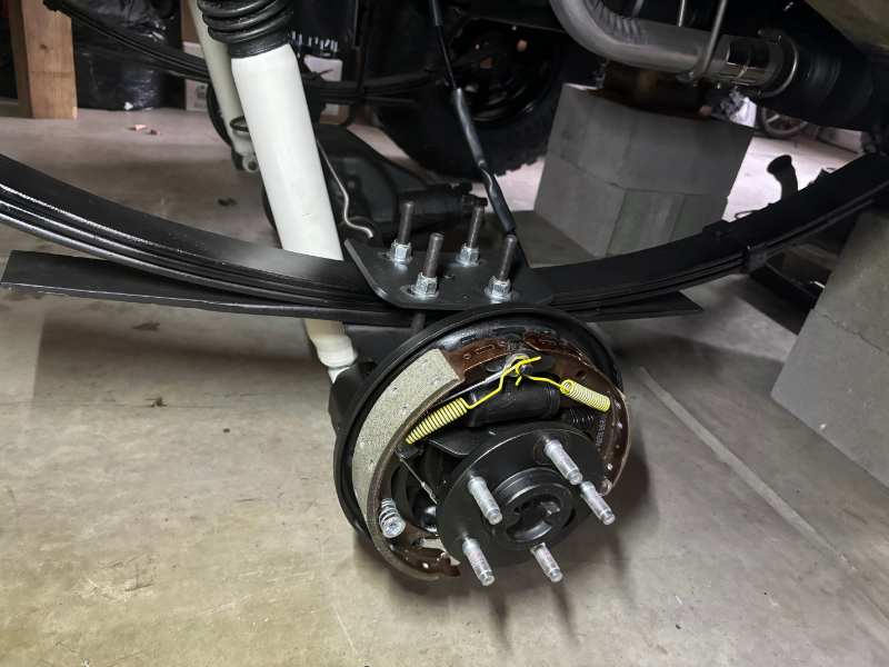

Had a little time to get the brakes together last night after work. Parking brake cables are stock length, and this is full droop. I had to route them under/ inboard of the leaf springs. I think I'll make a pair of looped brackets 3"-4" long where the original loops used to be. Need to adjust the shoes with the drums on and then set the parking brake adjustment. Then I'll get her on her feet and see what I have for rear ride height.

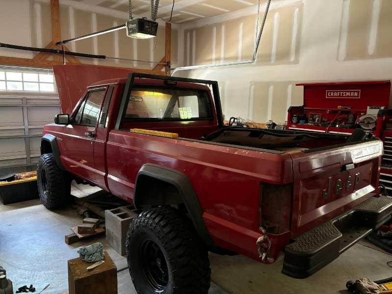

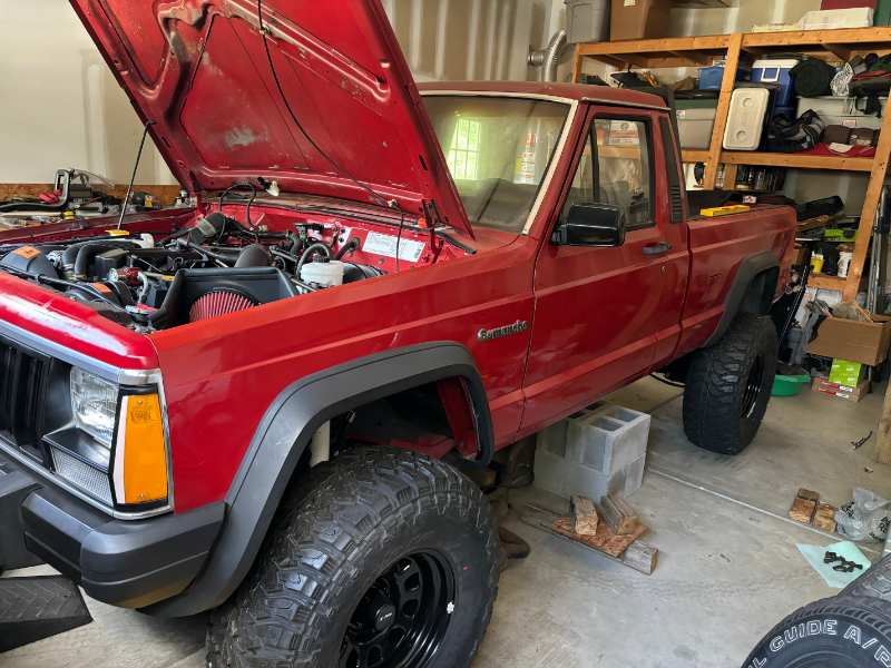

Got her on her feet today.
Rear height is 14.50" (+5.3" lift)
Front height is 13.25" (+5.5" lift)
Rake is 1.7" R > F
I'm going to add another .5" - .75" to the ACOS up front and let the leaf springs settle. I'd like to see about 1" of rake, max. Just my preference on stance.
Generally, I can't stand black wheels. They actually look really good on this truck though, especially with the black bumpers, grille, and headache rack. That thing looks huge with the 5.5ish inch lift, in a good way.
I always was hesitant on black wheels on anything too. But this one made sense and has a good aesthetic, I think. Much appreciated!

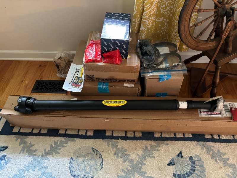

No pics but a quick update - SYE ordered, will be here Monday. Angle of the rear diff will require some work for a double cardan shaft. The shorter XJshackle will draw the rear down another degree or two but I can work a fair amount of rotation adjustment into the SOA with slight modification.

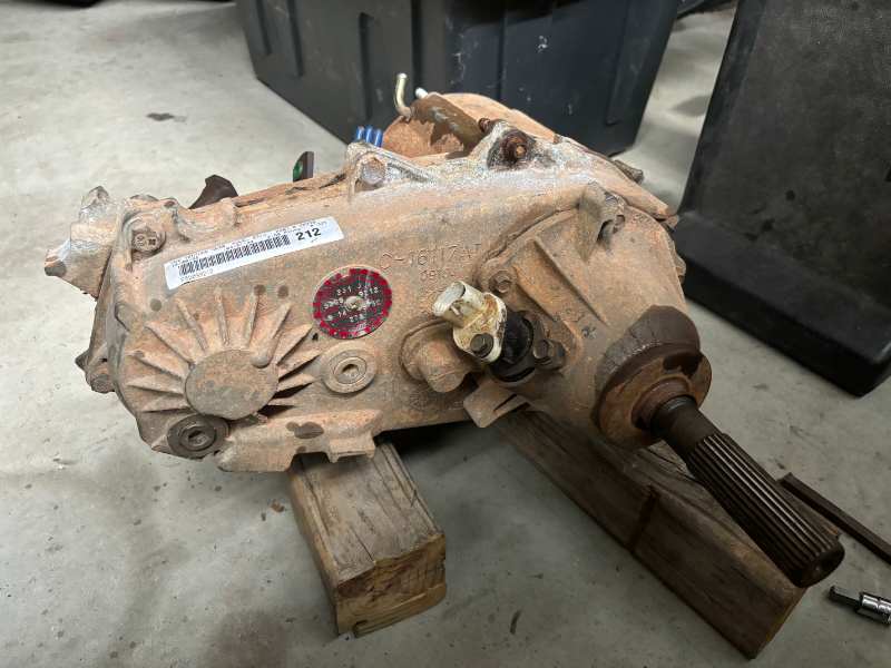

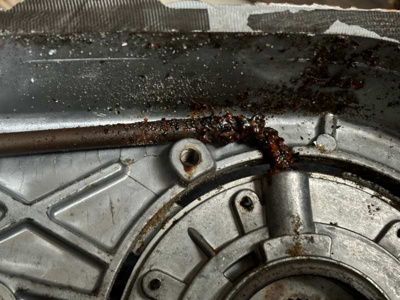

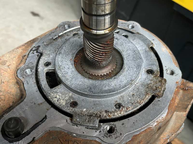

I have a 98 XJ 231 I bought super cheap from a NC4x4.com member back in 2022. Something's wrong inside, so I'd opted to use the 93 YJ's 231. I'll crack it open tomorrow. Front output won't move and it won't shift. Rear shaft is free. I'm going to try to cannibalize the shift rail, sector plate, rear drive sprocket and mode hub from the 98. The 98 shift rail won't need to be shortened for the SYE tail housing, and I won't have to mess with the caged needle bearings on the drive sprocket from the 93. And I'll have true neutral disconnect with the 98 sector plate.

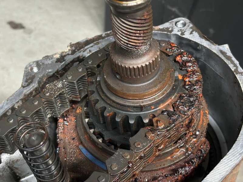

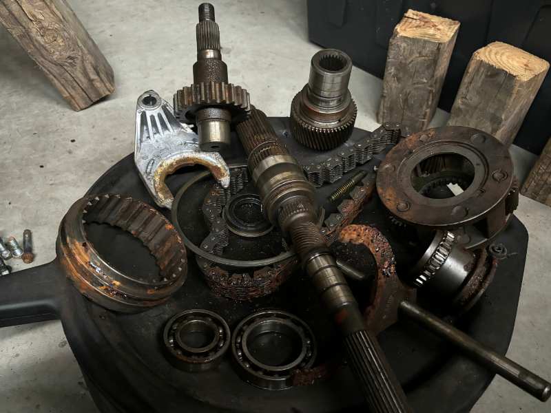

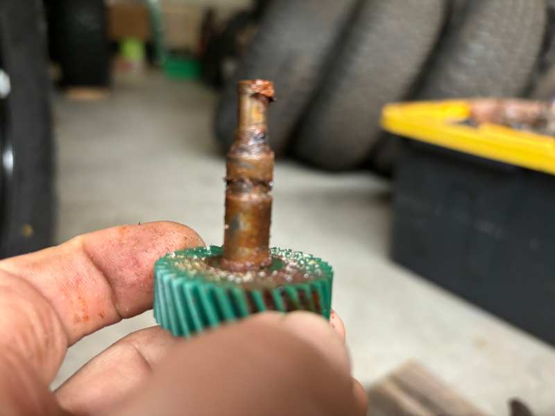

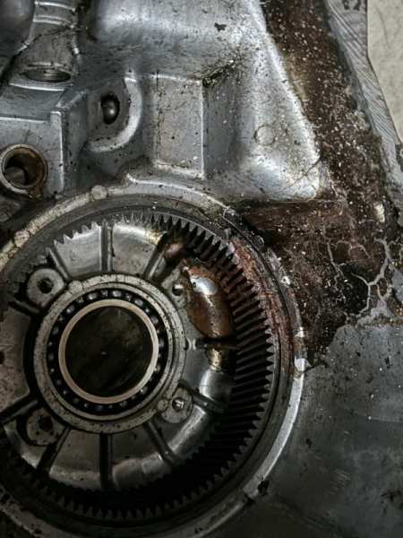

Transfer case carnage. This is the spare I wanted to rob parts from. I see why it's locked up. Destroyed by water. :sad:
Planetary and chain are trash. Sector plate is good, input surprisingly is good, front output and rear drive sprockets are salvageable, maybe the shift rail. I'm going to wire wheel everything that looks bad and see how much pitting there is and make final determinations on the parts I wanted from it.

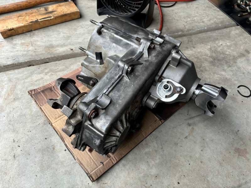

Slip yoke eliminated... I didn't need the mode fork/ rail after all. The YJ had the shorter rail. I thought about keeping the synchro but the caged roller bearings on the mode shift synchronizer were more than I could deal with without a press. CAD-equipped vehicles needed it to get the front output up to speed, later ones had the front output/ shaft already spinning so not needed. Swapped out the mode fork pads (partially destroyed, glad I did go through this case after all). The sector plate is swapped so I now have true neutral disconnect as well. The kit I got is from Dorman. Actually a VERY nice kit. Casting and machining on the tail housing is very impressive. I'm guessing the price of other kits is due to coming with a Spicer yoke. I know where a couple of those are if I want one later... I'd been researching and noticed that Rough Country and Advance Adapters use the same part number for their kits (50-7906), so it seems more than a couple outfits are selling the same thing that's sourced from India. Well, those folks have been casting and working metal a thousand years before western civilization existed, so I'm not losing any sleep lol.

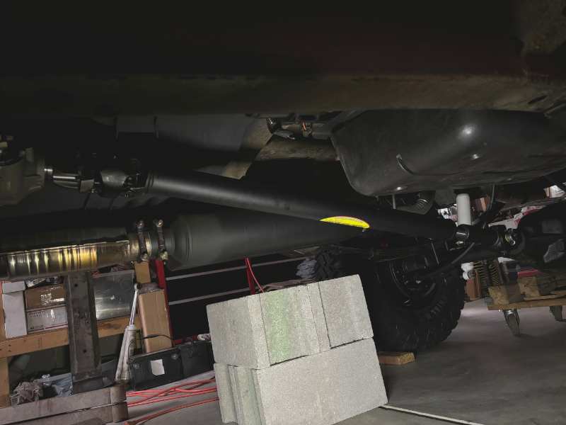

Should have posted earlier this week, but some more progress has been made. XJ shackles in (for now). Just short of another inch of drop in the rear. Rear ride height is 14.25" so that's 5.05" rear lift with leafs not yet broken in. Front is 13.875, so that's 6.125" lift. I can swap the MJ shackles back in when the rear springs settle. Installed the transfer case on Monday. Today I pulled apart and reassembled the rear suspension and made a shave to one small part of the SOA setup to get another 8* of upward pinion angle. Driveshaft measurement is 47.5" center to center of u-joints. Ordering a driveshaft from Tom Woods soon. :banana:

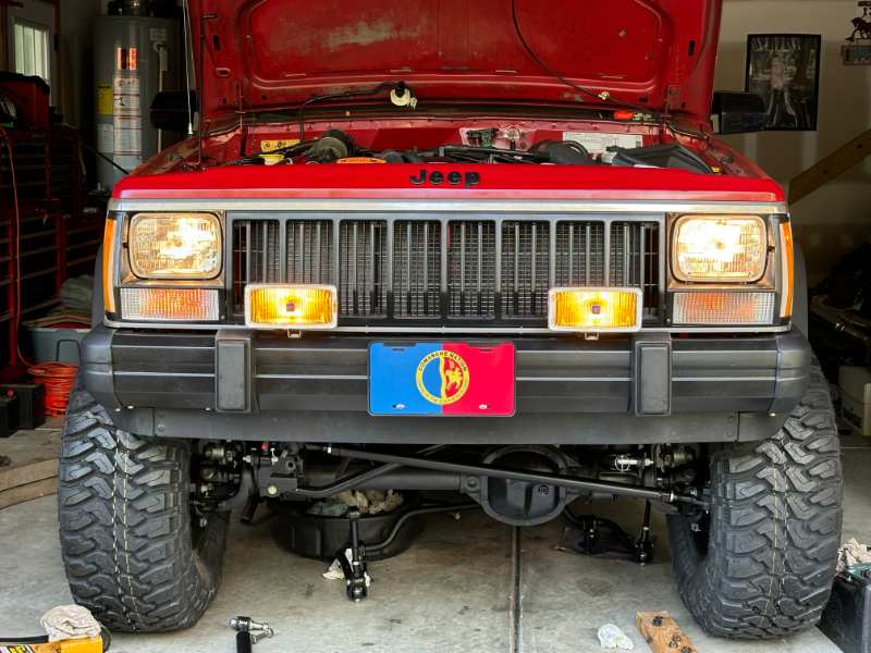

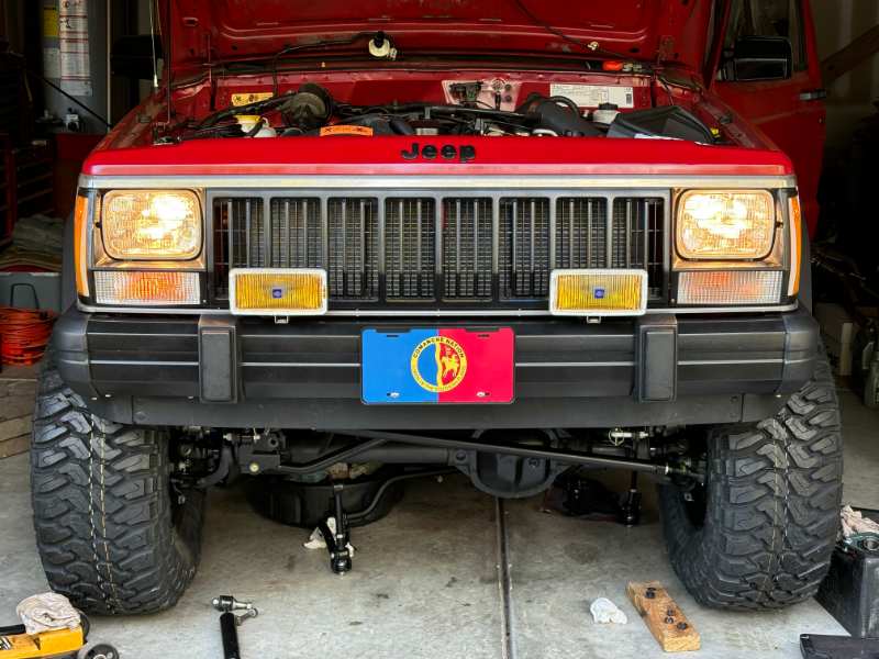

Still waiting on my local fab shop for something to cure my steering interference issue. In the meantime I went ahead and checked off another item on my wish list. Hella 550s, under $100. Wired in for factory style operation. Tapped the wires for C102 pins 6 and 10 on the engine control harness side since my lighting harness lacks all the fog light goods. Made 2 Y harnesses for the lights' power and ground and tucked them in neat with split loom. Hung the relay in the driver's side inner fender well close to where it would have been factory. Loving it...

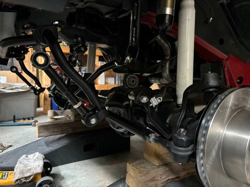

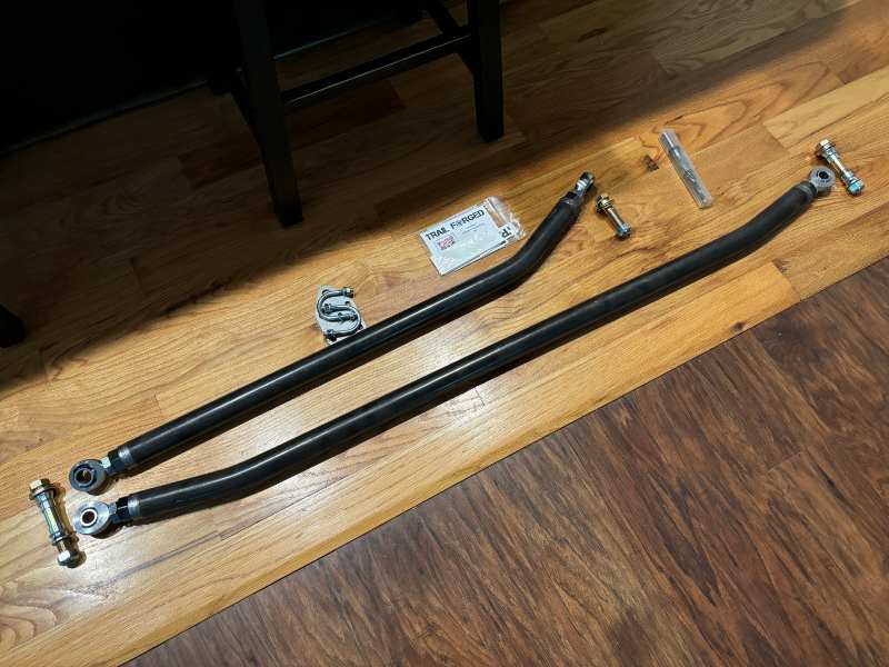

This was worth the wait. I was thinking that massaging the drag link's bends to gain steering clearance on the passenger side would be a solution. That works, but having to replicate that on a wear item on a big lift when a replacement is needed wasn't an attractive option, long term. This build has required a few things one would call a 'big ticket item' but aside from new tail lights from Key Parts (coming early November) and at some point a Dana 489 from ECGS, this is probably the last.
OMG this Trail Forged setup is BEEF. Steering clearance issue is solved. Their instruction setup pics have the steering damper on the tie rod with a factory track bar (?!). My TB interferes so I have it on the drag link instead. Mocked up with lengths set within a degree or two on the toe, nothing tightened up yet. I ordered mine bare steel for DE1634 coat instead of their powder coat (black not availalble). Next is to pull and paint and reinstall and check toe again and adjust as needed to get close enough to drive it to the alignment shop. Did some computer work on a friend of a friend's Hunter alignment machine so I'm invited for an "as much time as you need" alignment. :D

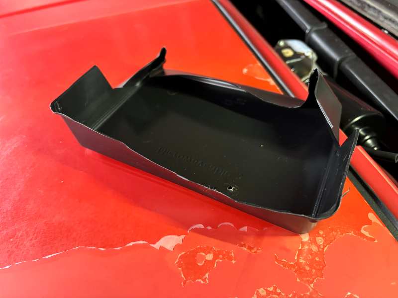

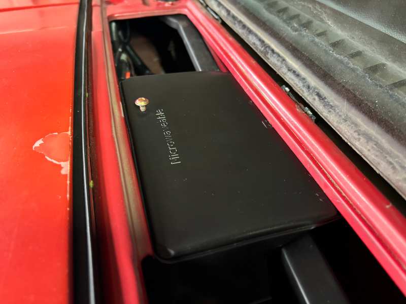

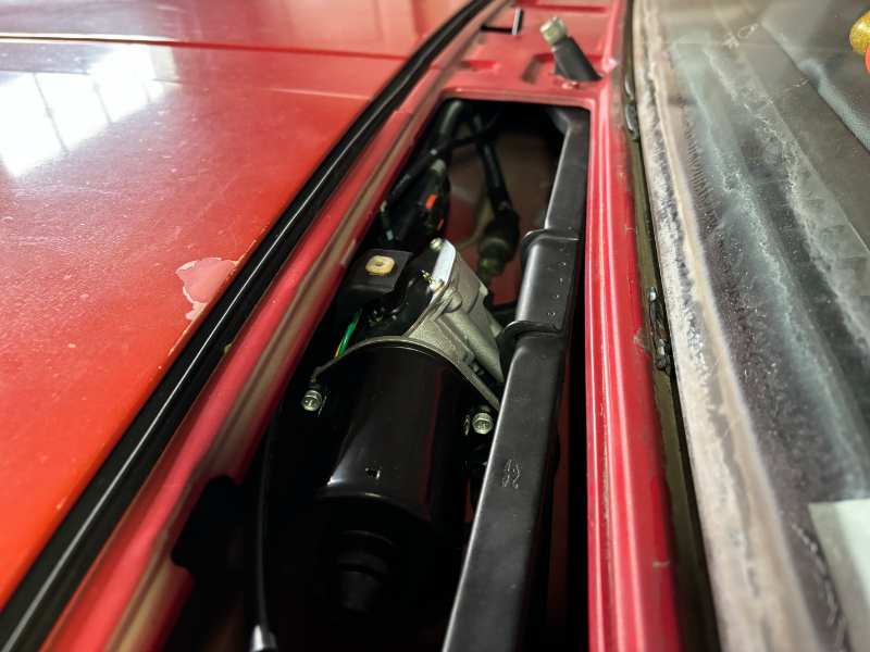

I went to the trouble of cleaning out, re-greasing and sealing the original wiper motor maybe 2 years ago. I jumpered it in high and low positions directly with a battery, and it's slow and noisy. Technically it works, but no sense using it and then replacing it soon out of frustration. I got the harness side wiper motor connector from a 2002 WJ- the colors are slightly different from some of the XJ examples posted elsewhere here but no big deal. The WAI WPM447 has the later connector and is $4 cheaper than the WPM438 with no connector. So I built an adapter to keep the harness side uncut and connect to the newer motor.
It's about a foot long, more than needed, but again, no big deal hiding inside the wiper cowl.

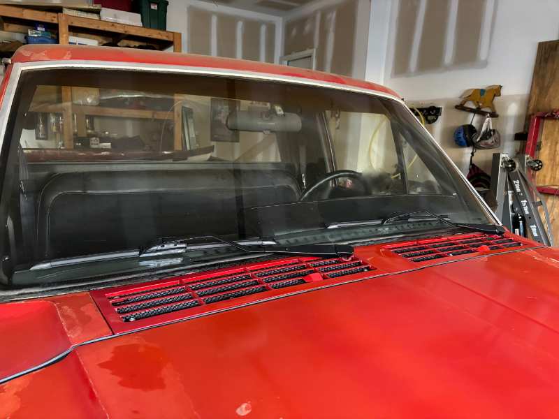

Finished up the wipers on Saturday. The harness adapter works with no issues. I was wondering what I was going to do about not having the rubber jacket around the motor and I had a thought pretty far outside the box. That's a microwaveable meal tray trimmed for flexibility and fitment is more than acceptable lol. I spent parts of 2 days getting all the scale and peeling clear coat off the cowl cover with a .002" feeler gauge and soft brass brush. Then wet sanded the lines between base and old clear. Next, some dish soap and 1200 grit on the areas of base that had been exposed to remove oxidation. I also touched up a few spots with a very small brush - sprayed Rustoleum Colonial Red in the cap and dipped the brush in it. Finally, I cleared the whole thing with Upol/ Raptor diamond coat 1k. I'm impressed with it, dries very hard and very fast and has very decent UV protection. Maybe one day I'll fork out 8-10k for a real paint job but in the meantime I'm just trying to keep it red and protected from peel and rust.
New later arms...

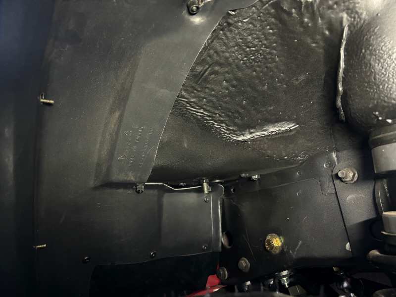

Also from Saturday - got one of the new fender liners in. Fitment is... decent but by no means perfect. A couple of the holes aren't quite right and require a little trimming. I think I can do a better job on the other side. New rubber flaps up front from Detroit Muscle Technologies.

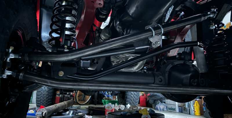

Trail Forged setup with 'high lift' drag link. I swapped the drag link out due to the heim joint angles being steeper than I felt comfortable with. Much better angles now. The drag link isn't nearly as close to the oil pan as it looks in the first pic.
