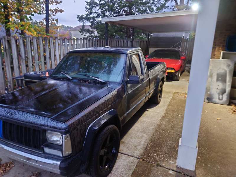

October 2022 - I sold this car for about a $6000 loss. I had slowly fallen out of love with the project and the damage to the roof just haunted me for my lack of skill, equipment, and lack of funds. On top of that, space was at a premium with me having three other vehicles, my brother and mom having one each, a 5x10 utility trailer, and the occasional project car coming through for me to fix and flip. There's enough room to fit 5 cars in the driveway but that blocks my riding mower from going through the gate into the backyard so normally it maxes out at 4.
I had also managed to find an OEM bumper cover and dash panel for my Trans Am so it started to get some love. It took shelter under the carport from that point on. I suppose I'll make a thread on her now.
