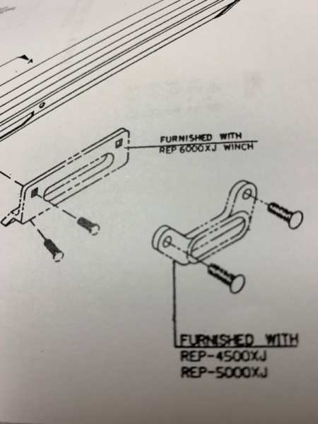

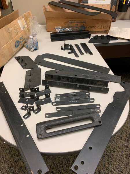

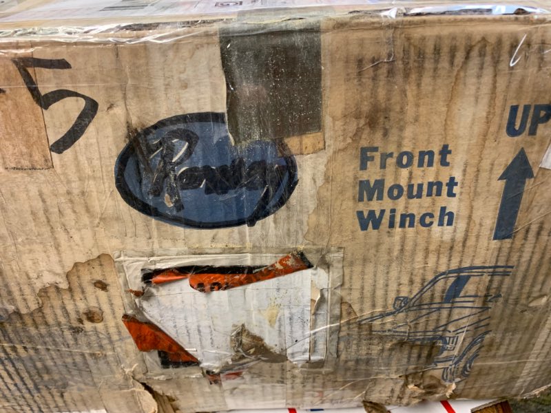

Red Mistress Posted September 18, 2025 Share Posted September 18, 2025 I’ve got pics in my 91 Eliminator thread, but thought this good place add info for these rare XJ kits. Link to comment Share on other sites More sharing options...

Red Mistress Posted September 19, 2025 Share Posted September 19, 2025 XJ Hawse fairlead would be hard to reproduce, as it fits curve of factory bumper. And it's visually the coolest part of the kit. Link to comment Share on other sites More sharing options...

DesertRat1991 Posted September 20, 2025 Share Posted September 20, 2025 On 11/25/2019 at 12:49 AM, strictlyxjs said: Sure ill grab some this week. I had it mounted on my 2000 xj for a few year and removed it when i got into an accident. The winch setup didnt get damaged but i decided to put it in storage for safe keeping. Never seen pictures install pics before. Very interesting to see that the winch mounts "feet back" which would put the bolts under tension during a pull. These days, that is generally accepted as the worst way to mount a winch. Between this, the tiny winch capacity and the plastic "gap filler" pieces you can start to see how there was a tremendous opportunity for sturdier aftermarket solutions. Link to comment Share on other sites More sharing options...
