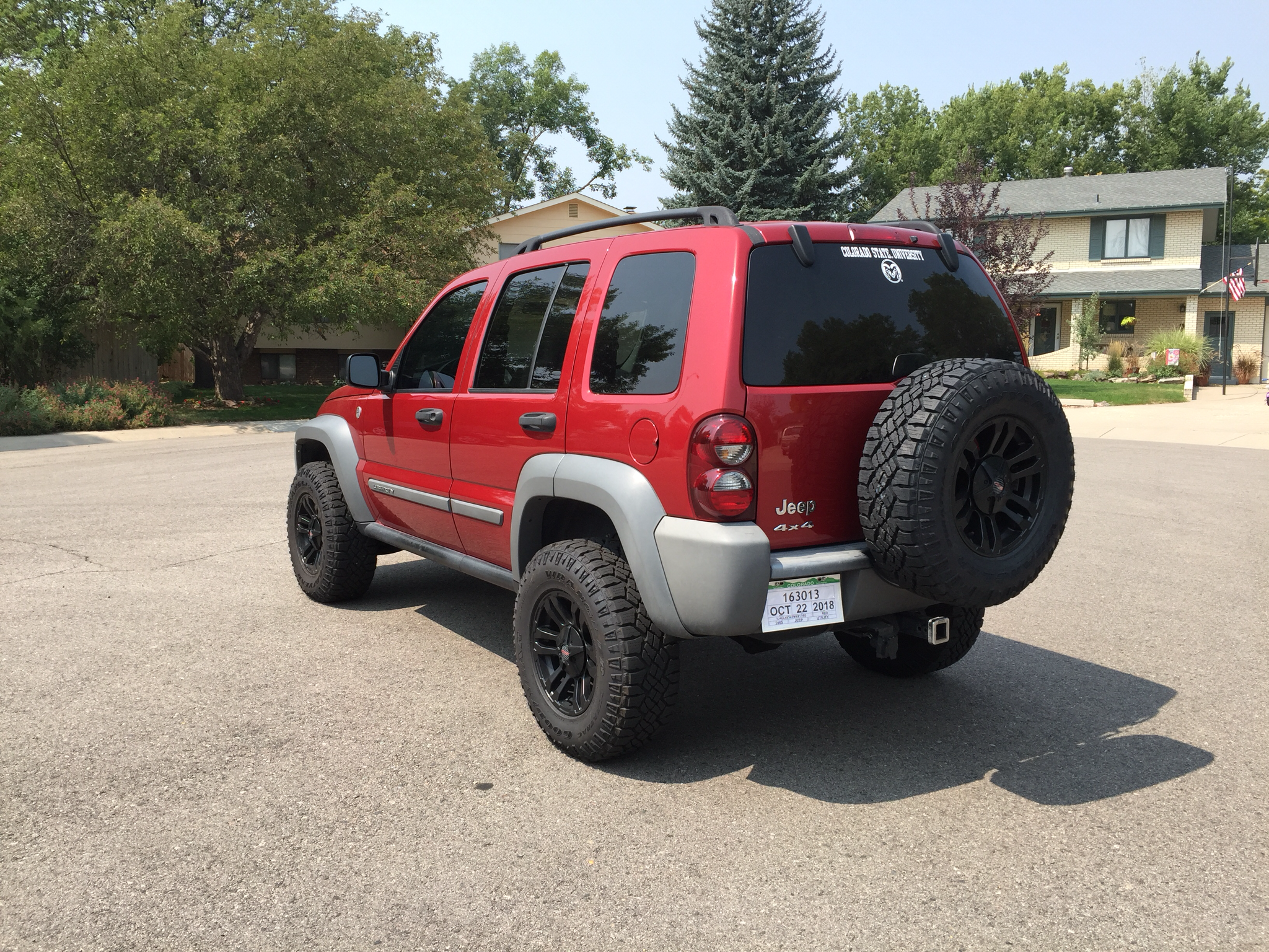

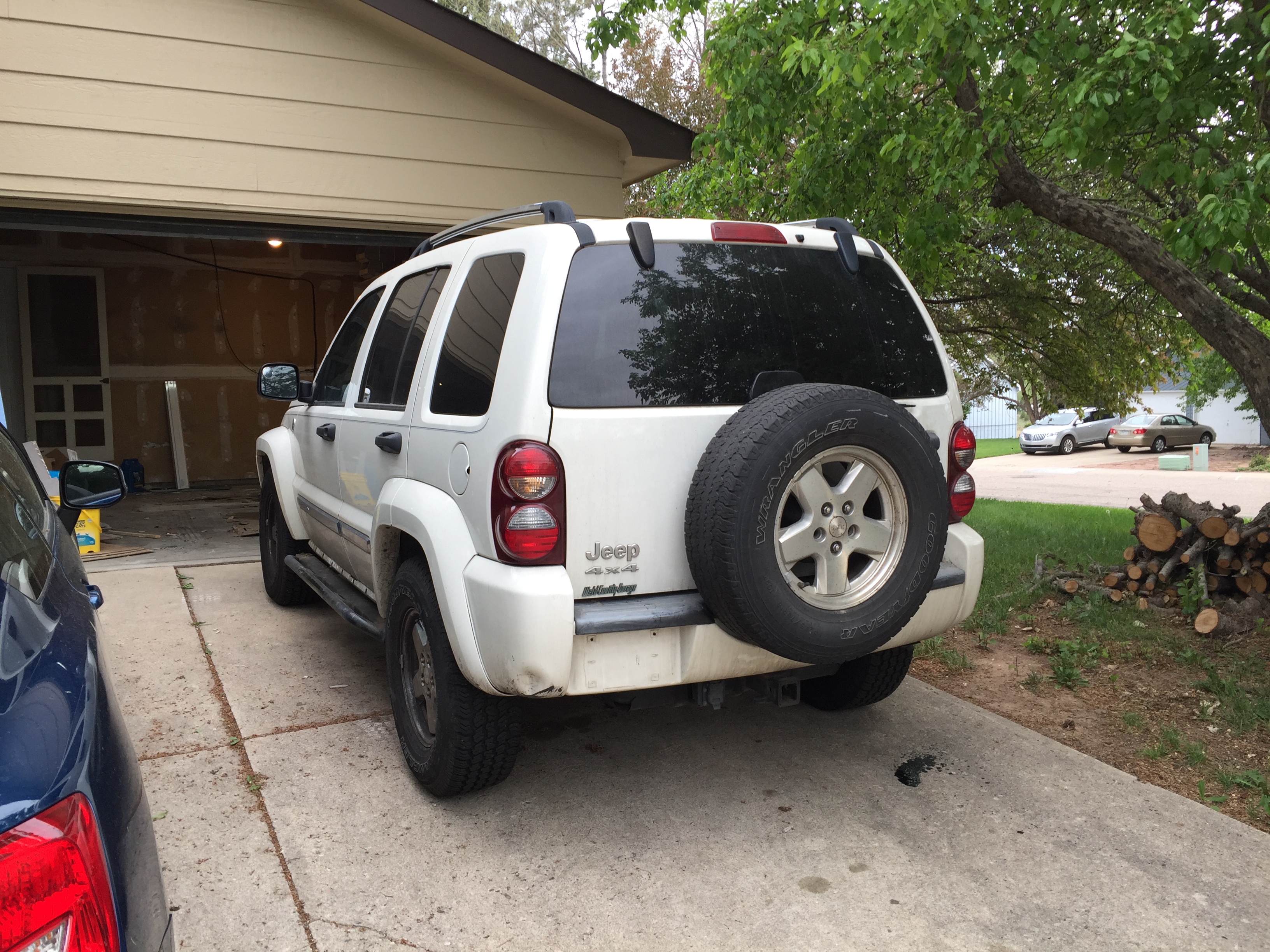

2005 KJ CRD, 153k miles. 2.5" OME lift, 265/70/16 good year duratracs on some black wheels. Very clean, I like the color, somehow missing the front skid?????? and I got it with the stock wheels with almost new Michelin tires.

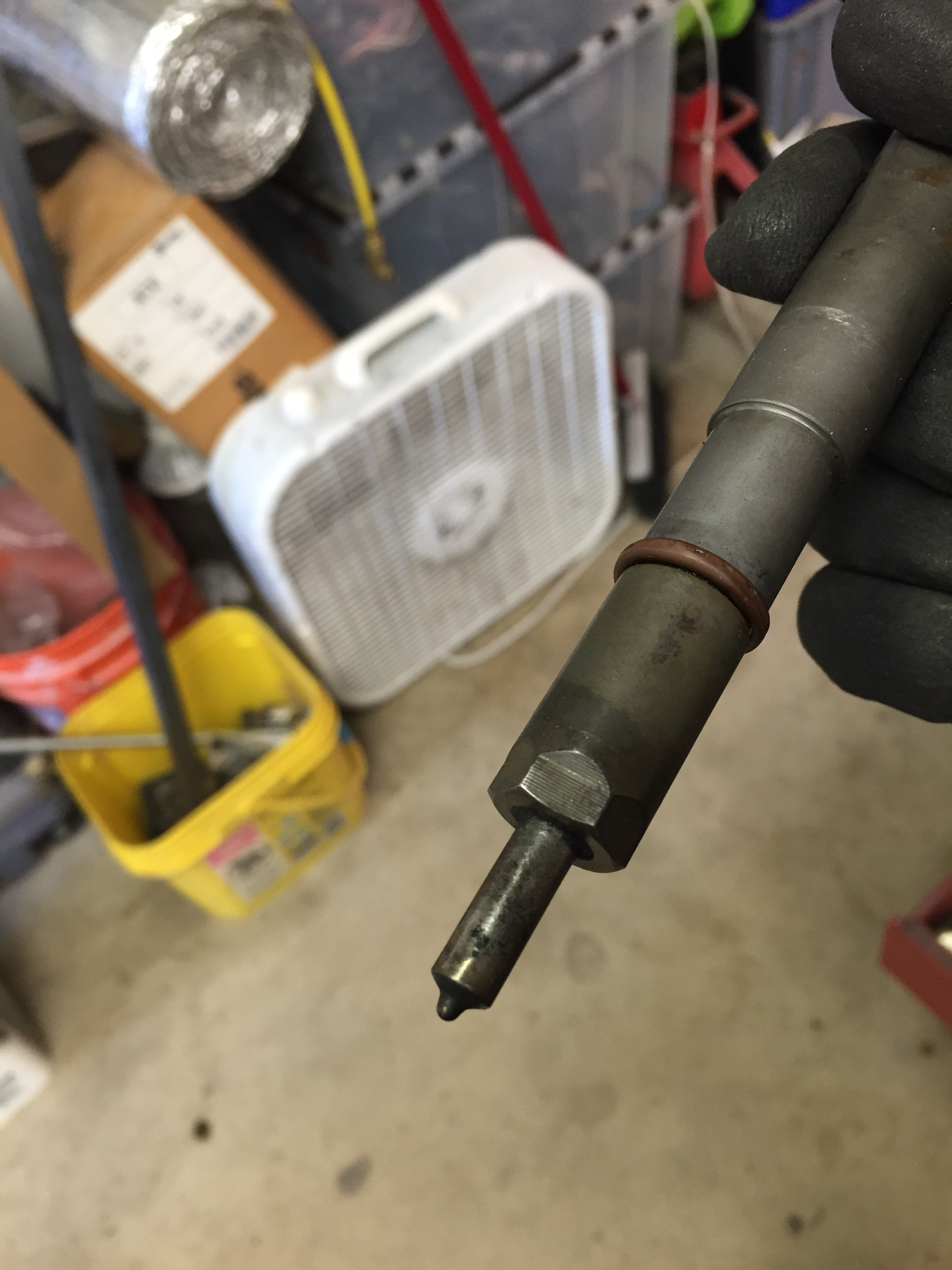

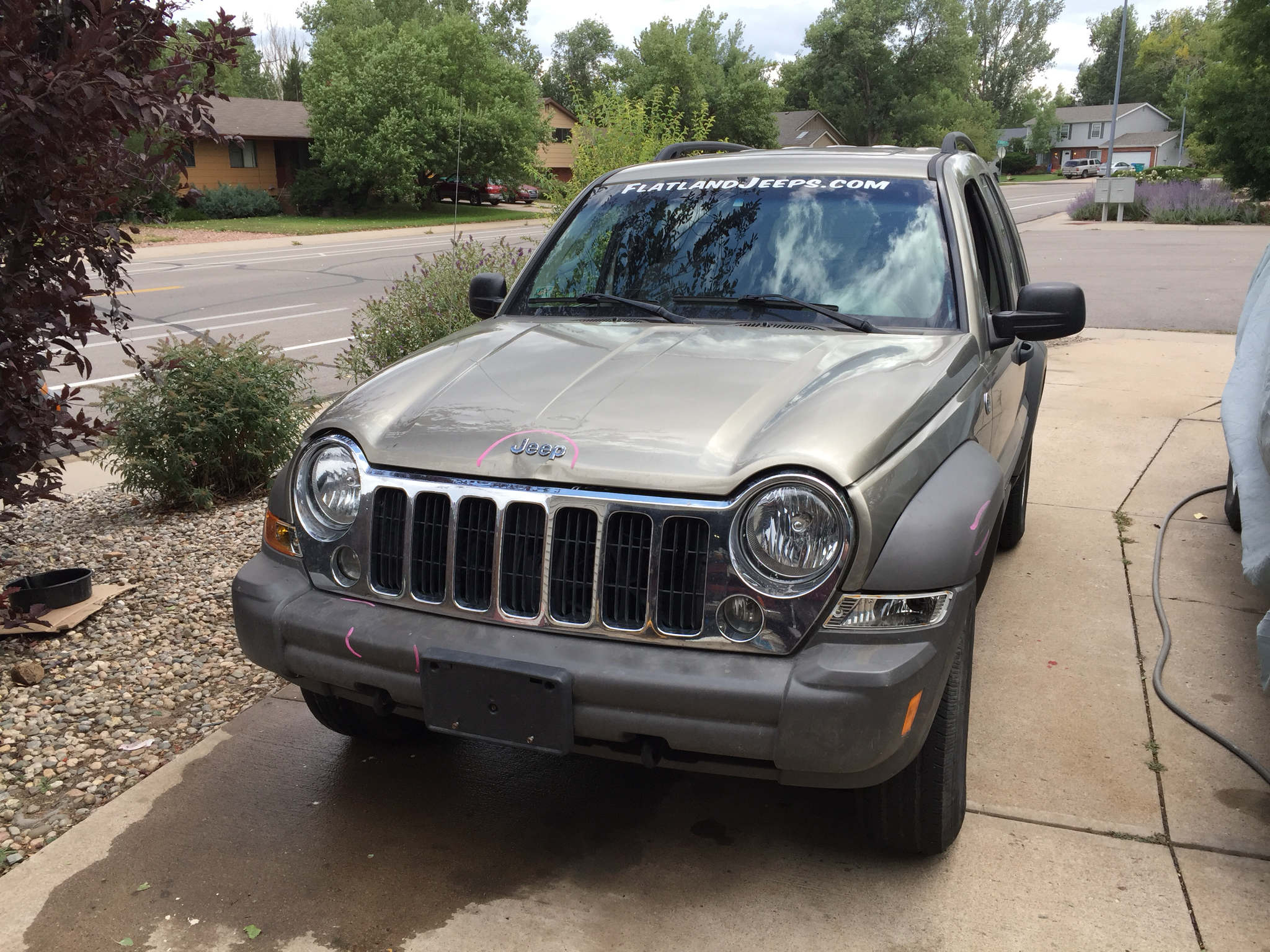

Got to troubleshooting, not running on cyl #2, swapped injectors with MJ, still not running, swapped injectors with #1, still not firing, checked wiring continuity - good. Swapped ECUs, no change.
So it seems its fuel, lots of diesel around, but its not igniting, next up is a compression test.

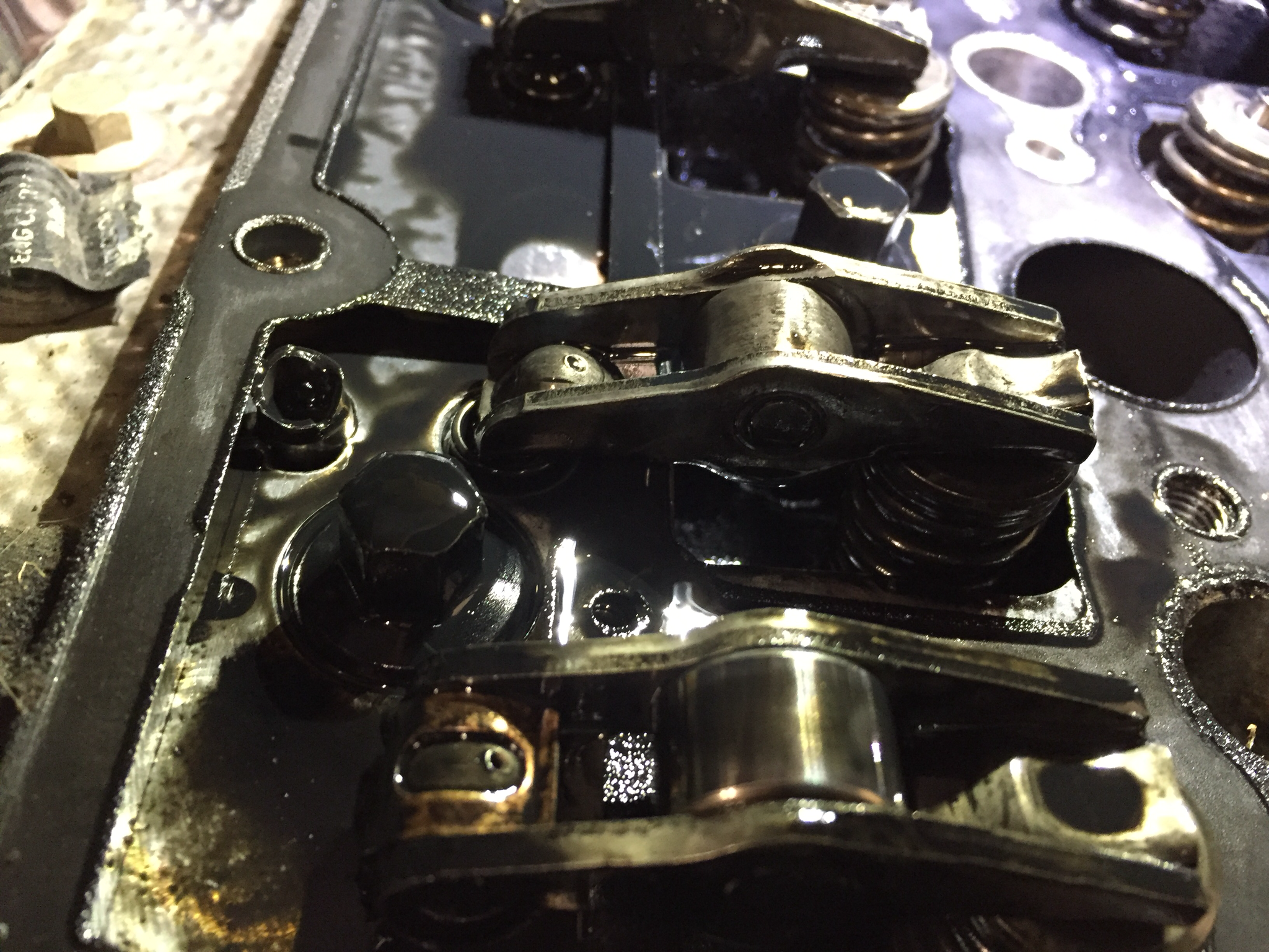

Possible, however the next most likey issue is a bad rocker or two. The rockers are a designed failure point, since this is an interference engine if the belt slips or breaks the valves hit the pistons and the rockers break. However with heavy EGR use the bearings in the rocker rollers tend to wear out and collapse, sometimes spectacularly. This can cause an engine to actually backfire out the intake in very bad manner.
I am thinking this engine has some bad rockers on #2 cylinder. In which case it will get new ARP head studs, rockers, and a timing belt job, as well as a ECU tune to delete the EGR - should be bullet proof for the next 100k untill it need a belt, and for the rest of its life with those engine mods.

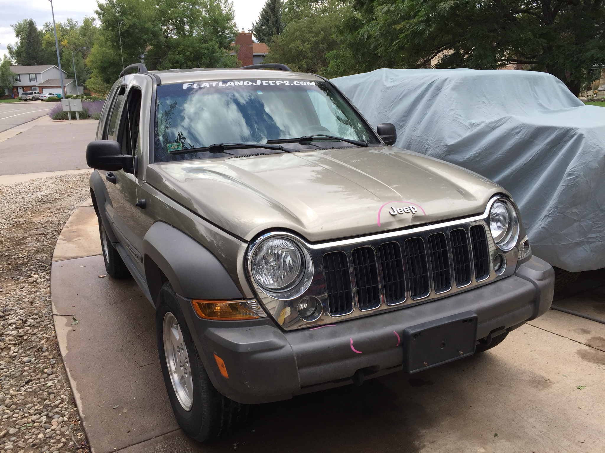

I just picked this up Wednesday. Decently clean. A few dents and a little bit of rocker rust. It's got the 3.7L in it with 203,000 miles and a blow head gasket. It's been wrecked on the front drivers side (can tell by new headlight and fender flare and good dent) something in the front end is wore out cuz the tires are wore bad.
Gonna change head gasket and check heads and check front end and drive it around.
I got it mainly for mock up for bumpers and sliders for a set for Pete on here. But his is the later body style, like your red one. Of course...

Crap I typed up a reply this morning but must have forgot to submit.
The frames are the same, grill, bumper etc are different, if you look at the ARB bumper for the KJ it was designed for the 2002, it will fit the 05+ plus, but it blocks the fogs and there is an odd gap to the flares.
The sides are the same, but the 05+ has a plastic cover over the rockers, where the 2002 just as the metal rocker.
I have a set of rock rails and the clearance with the plastic rocker covers can be an issue.

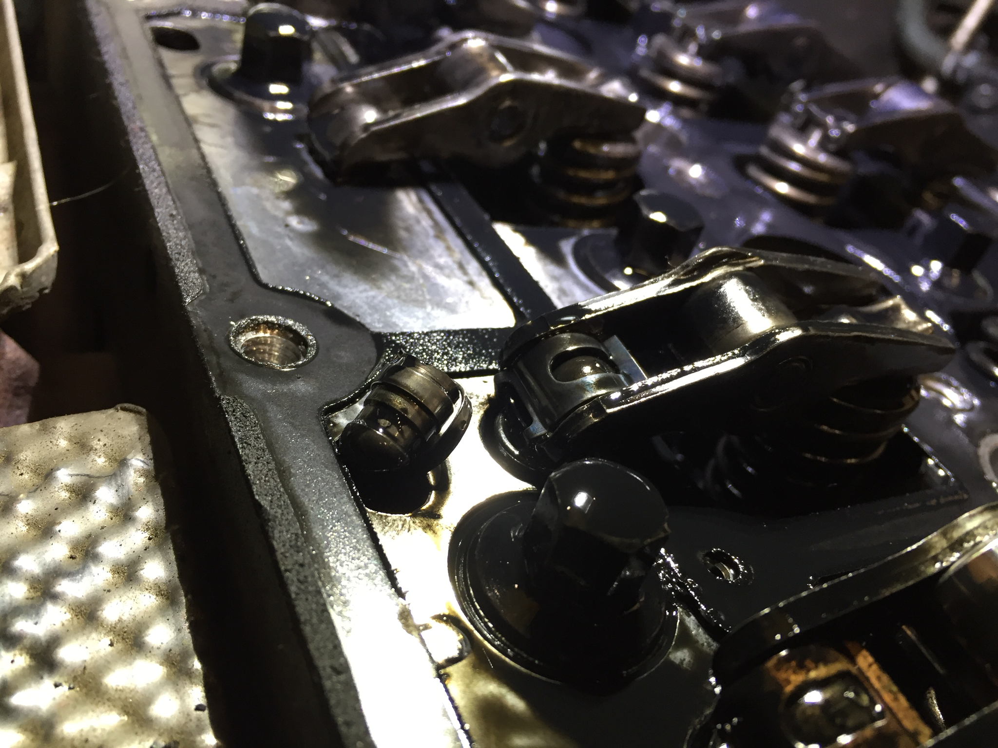

Pulled the intake off, looks like a really messed up set of rockers, this is what happens when you used the oil Jeep recommended(mobile 0-40) instead of a good diesel 15-40(like the engine manufacturer recommended), and have EGR active. EGR is basically the death of these things. My Jeep with 155k, same miles as this one, had ZERO rocker wear with the EGR off and 15-40 Delo diesel oil.

I got the rockers off and head cleaned up a bit, looks like on #2 cylinder, which was the problem cylinder, there is a valve that is missing a keeper. I can see one keeper, but the keeper cap isn't sitting right and the top of the valve has worn. I need to make some sort leverage bar with a U shaped end to compress the spring so I can get the keeper out. If the valve end looks good where the keeper rings are I can replace the keeper(s) and cap with spares I have here. It the valve end looks damaged I will need to pull the head to replace the valve.

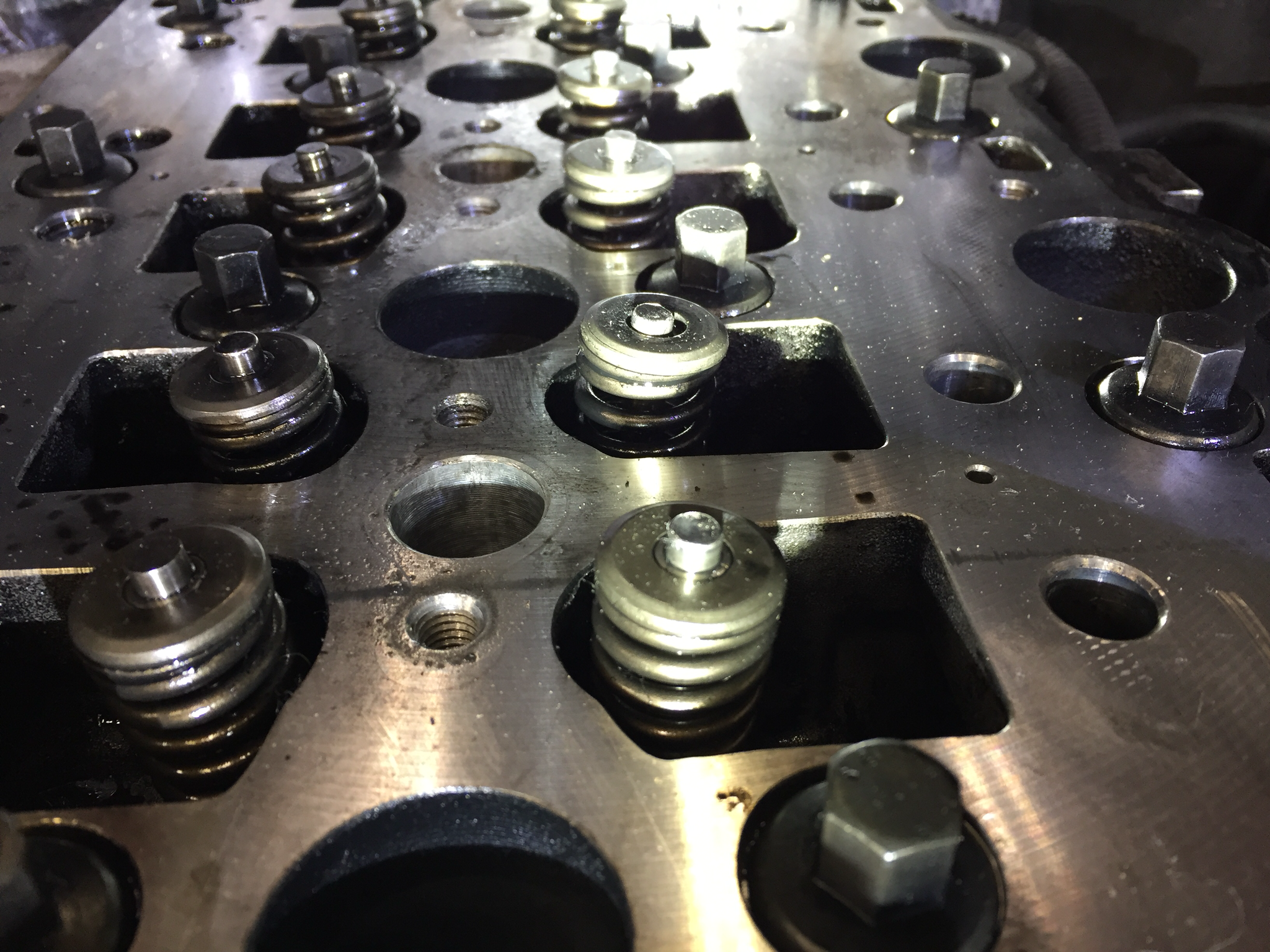

After  that I got back into working on the red one, I got a spring compressor  setup and got the old keeper out. Turns out half the keeper was missing  and the other half split in half, making 1/4s. I replaced it with 2  spare keepers and a spring retainer. The grooves in the valve for the  keeper looked perfect, so I don't feel the need to replace the valve.

Got Ruby emissions tested and plated, loaded an 811 stage one tune, and reinstalled the stock wheels for the ~3000 or so highway miles it will see between CO to CA to CO.
Got a few pics before I took the big wheels off. Next time it is back in CO I will work on the pinch seams since they eat into the tires, and hopefully get a few other things like the rock rails installed, LED foglights added, steering wheel radio buttons, and roof rack cross bars.
