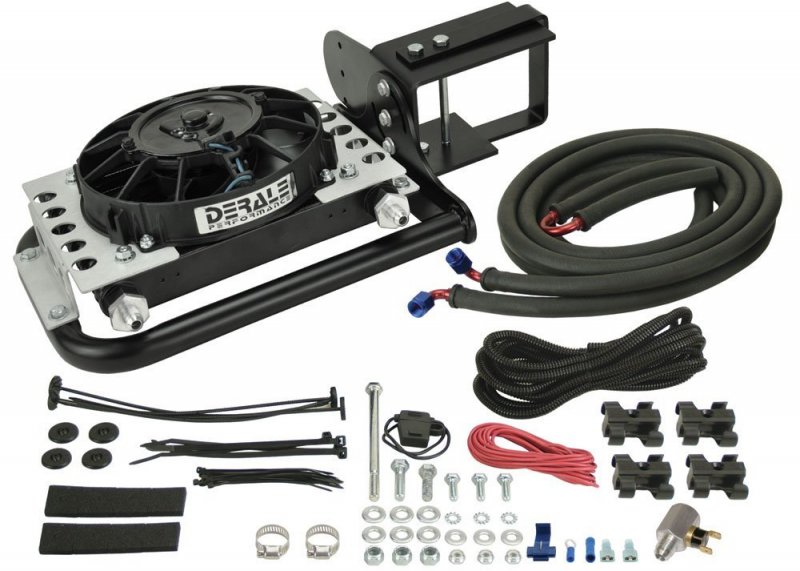

HOrnbrod Posted February 26, 2018 Share Posted February 26, 2018 Plumbed up the new cooler in series with the factory cooler and bypassed the radiator cooler. Been driving around a couple of days and the tranny never goes above 165* now. Before the norm was ~190* - 210*. Engine temps are unchanged at 200* - 210*. We'll see how it is when it gets real cold here, like below freezing. But that might not be until next fall. Link to comment Share on other sites More sharing options...
