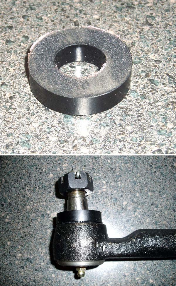

DirtyComanche Posted January 2, 2007 Share Posted January 2, 2007 I've got the dreaded Ford inverted-T draglink and trackbar and so there's plenty of dead space in the steering and I'm not sure if I've got any bumpsteer. :roll: Take some 13/16th machine washers and put them between the TRE and steering knuckle, below the dust boot. It'll stop the tie-rod from rolling and remove the vaugeness. And bumpsteer is really more where you hold the wheel straight and hit a bump, and even though the wheel is still straight the tires turn due to the suspension travel. Basically, if you hit a speedbump and your truck pulls a lane change - you've got bumpsteer. Link to comment Share on other sites More sharing options...
CWLONGSHOT Posted January 2, 2007 Share Posted January 2, 2007 I've got the dreaded Ford inverted-T draglink and trackbar and so there's plenty of dead space in the steering and I'm not sure if I've got any bumpsteer. :roll: Take some 13/16th machine washers and put them between the TRE and steering knuckle, below the dust boot. It'll stop the tie-rod from rolling and remove the vaugeness. And bumpsteer is really more where you hold the wheel straight and hit a bump, and even though the wheel is still straight the tires turn due to the suspension travel. Basically, if you hit a speedbump and your truck pulls a lane change - you've got bumpsteer. this is a good tip, but a factroy part is avalible to help eliminate the TRE roll. its from a Jeep "J" series steering setup. I have them on the TJ with the JCR steering setup. JCR haden't herd of them either but couldnt find a reliable source so they are haveing them made fom poly and sold on thier site. they work quite well. As far as a rubber bushing wearing faster if over flexed, you are correct. But a properly set up track bar only goes up and down, it dosen't get twisted anywhere even near what a CA bushing does. Which is what I think you are refering to. CW Link to comment Share on other sites More sharing options...
DirtyComanche Posted January 2, 2007 Share Posted January 2, 2007 Actually, that funky bushing thing is on all of the FSJs. Unfortunatly, I could not get one and didn't feel like arguing about it in the parts store. The washers worked quite well for being something I have on hand. Other than one you pull the tie-rod off you have a handful of greasy washers to put somewhere. Link to comment Share on other sites More sharing options...
