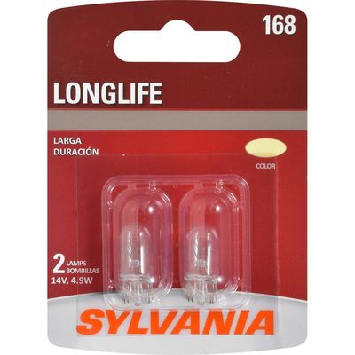

Oizarod115 Posted November 27, 2010 Posted November 27, 2010 try a 3 or 5watt tag bulb from any parts store. fold the little metal tabs down off the base of the bulb, plug them into the injector harness from that cylinder and start the truck, you should see the bulb flicker on-off if the bulb doesnt light (it may be very faint/hard to see in bright daylight) check and make sure it has good connection at the plug and that the bulb works when given 12v... if you determine the injector harness is not giving signal then check to see whats going on with wiring
