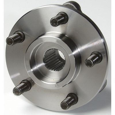

mvusse Posted October 24, 2010 Posted October 24, 2010 The separate bearings and races are for a 2wd axle. 4wd MJs (as well as xj, tj, yj, zj, jk, wj and probably others) all use a unit bearing, which is the "complete hub assembly". In later years (89? 90? 91?) the 2wd axles were changed to the 4wd unit bearing with a dummy shaft in it (a stub shaft with a flat back side instead of ears for a u joint).
Eagle Posted November 1, 2010 Posted November 1, 2010 The separate bearings and races are for a 2wd axle. 4wd MJs (as well as xj, tj, yj, zj, jk, wj and probably others) all use a unit bearing, which is the "complete hub assembly". The early hub units for the 4WD vehicles WERE serviceable. Last I knew, Quadratec still sold the individual parts. But by the time you bought the inner and out bearings, the two seals required, and I think there was one other part needed ... you were within a couple of bucks of buying a complete hub/bearing unit. And rebuilding the hubs requires a 12-ton hydraulic shop press. But, technically, the guy at O'Reilly's was correct. The later hubs (1990 and newer) are not rebuildable.
mvusse Posted November 1, 2010 Posted November 1, 2010 Yes, you will have to replace the unit bearing as a whole. They are not supposed to be serviceable or greasable. They cost anywhere from $90 to $130 depending on year and come with only a one year warranty. Depending on what style it may or may be be possible to take it apart without ruing it so you could grease it, but as Eagle said, it takes a hydraulic press with some special attachments.
Eagle Posted November 1, 2010 Posted November 1, 2010 Yes, you will have to replace the unit bearing as a whole. They are not supposed to be serviceable or greasable. http://www.quadratec.com/advisor/jeep_o ... _brake.php See parts # 16 thru 20. For 1984 to 1989 only.
Eagle Posted November 1, 2010 Posted November 1, 2010 This is what my 87 used when it was stock: Yes ... and those parts in my post immediately above yours are the parts to rebuild that hub.
