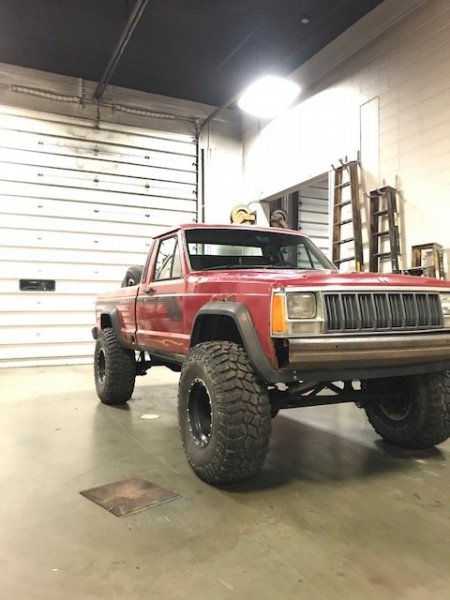

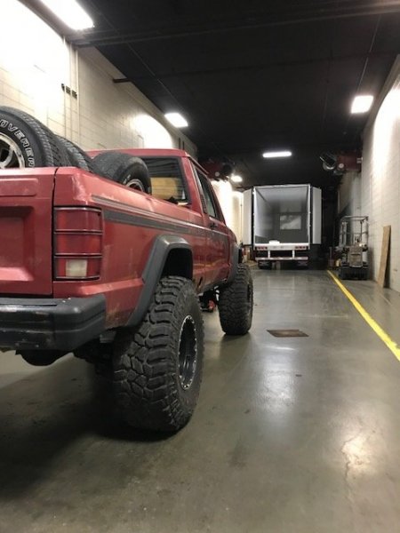

  3. UPDATE So as you can tell from the pictures I got the front end kit on and ended up snatching up a set of Cooper Discoverer 35x12.5 tires. It sits awesome but the front fenders are coming off, it rubs like you can’t imagine. Had to do a 35 point turn just to get into a parking spot. And I haven’t even given it the garage alignment yet so even moving it 50 feet into the shop my tires are screaming at me. I also backed the truck up and put it in park to check ball joints. And yeah, they will be replaced very very soon. The truck was looking like a riced out civic. During the install I took the air cleaner off to get to the driver side shock nut. And went to park it without the filter on. And it started running seriously rough. And smoking really bad. Smells really ritch. I’m imagining a vacuum issue. And upon re-installing the filter and leaving the battery cable off for a couple hours the rough running persisted and it’s to the point where it’s almost un-driveable. I pulled one of the plugs and it looks like crap. So I went ahead and bought spark plugs, wires, distributor cap, and a rotor hoping it’s gonna solve my rough running issue. I still need to temporarily mount some front shocks so I can at least drive the thing. So after the plugs and wires. I’m going to give it a garage alignment and make some shock brackets. Phew, wish me luck
