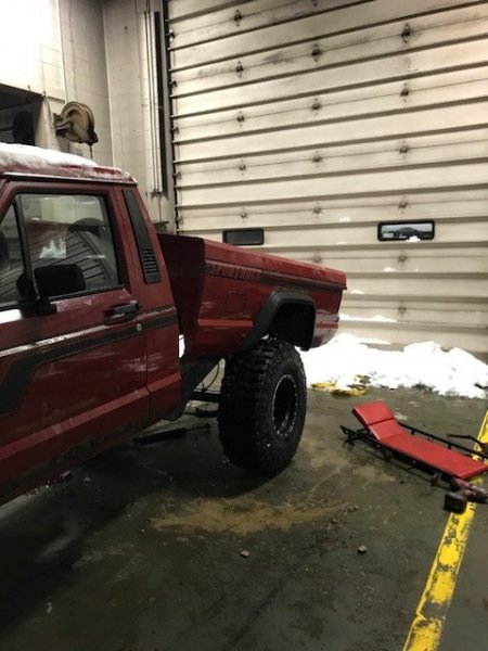

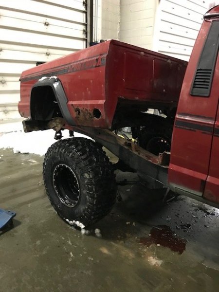

  3. Well. Long time no posts. Or progress for that matter. I found out it looks pretty dumb with the front bumper on after I got the front clip on. Oh well. I’ll go a little more in detail of what’s been going on once I get some time to write. But for now here’s some pictures.

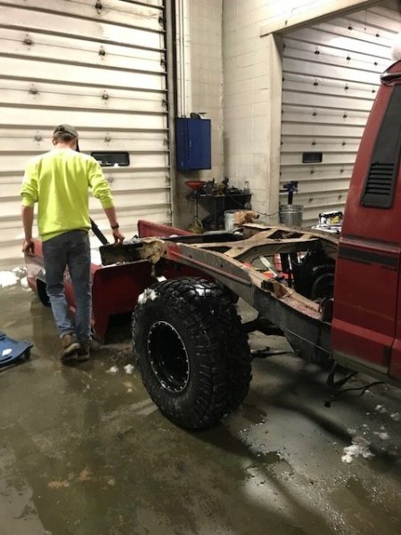

  4. Here’s some more from this evening

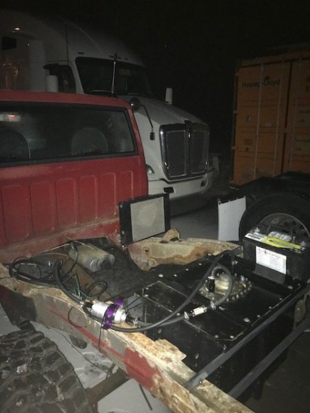

  9. Some progress pictures. Got the bed off. Got the fuel cell temporarily mounted. Got 1 cross brace halfway welded. Trans cooler is temporarily mounted. Fuel pump temporarily mounted. And I finished welding up one of the seat brackets this evening.
