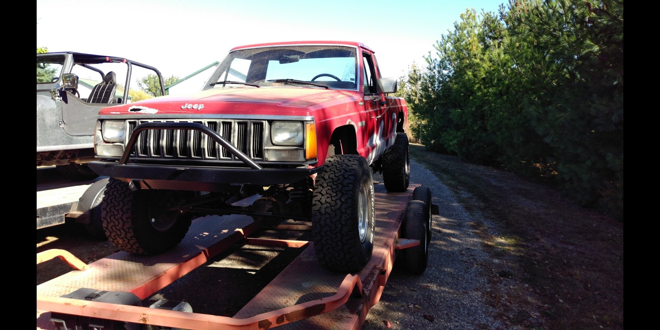

  13. After building on this thing for a couple of years I figured it's time I start a build thread on it. Stage 1 of the build: Picked up this little red beast November of 2016, had some bald 33s and a Rusty's lift on it, I cleaned it up fixed some of the problems from the previous owner and started using it. It started life as a 2.5L/5spd/4wd short bed sportruck, and ended up as it looks in the first two pictures. I built the front bumper myself, welded the rear end, and put a set of 33in bfgs and 15x10s on it, trimmed the fenders and was making plans for a heart transplant to give it a little more pep in the sand dunes. October of 2017 my ex girlfriend flopped it on it's roof playing in the field out back, caved the roof in and bent both doors and the side of the cab. I decided then that since it was already damaged and probably wouldn't be straight ever again to drop a SBC/th350 combo in it and cage it, but wasn't sure what to do about axles yet. So I got to work and got the roof 80% straightened out, pulled the windshield and the rest of the interior. Sold the stock motor, trans, tcase and wiring harness, and everything I could out of the interior, and the tailgate as well. Continued in the next post.
