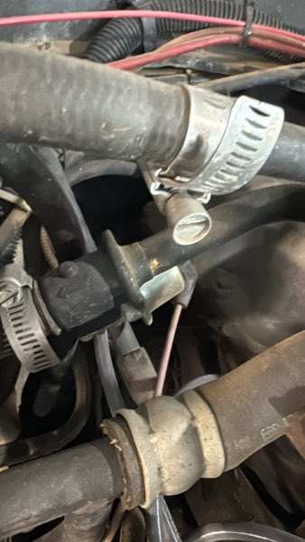

Ok this will be a long one. Tried doing all I could before I made a post. My heater is stuck on defrost. Cannot change it. I see the two lines coming out of firewall. I traced them down. One goes to a diaphragm on the coolant line. Looks fine. Connections seem fine as I can visually and feel. The other line goes to vaccum ball. Ball seems fine. And the rubber line has vaccum coming from intake. And I have vaccum by the relays at the connection where the firewall line is extended to the ball. What do I look for now? From what I can tell, I have vaccum coming from the ball, to the firewall. I do not have vaccum in the red vaccum line going to that coolant line diaphragm. Don’t know $#!& about Vaccum but doing my best. Thanks. It’s a 1987 with the renix
