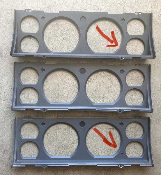

TheNerfsmith Posted 3 hours ago Posted 3 hours ago Did Jeep change the style of lens for the sport gauges with the tach and the full set of readouts from 89 to whenever they changed to the new interior?
Eagle_SX4 Posted 2 hours ago Posted 2 hours ago Yes, the change was between Renix and HO. The change was the trip reset button moved outside of the speedometer for the HO.
fiatslug87 Posted 1 hour ago Posted 1 hour ago There are at least three types of gauge surrounds with matching lenses and a lens without the trip reset hole. The top one has a small cut out in the speedometer the bottom is HO.
