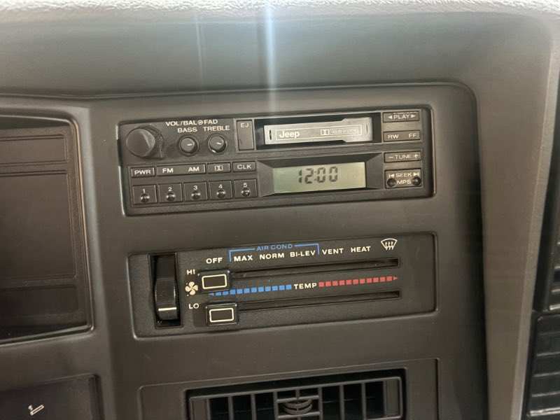

90BlackMJ Posted July 17 Posted July 17 Hey guys, I’m in the process of putting my Comanche back together from restoration and upon testing the radio, I get nothing. The radio is a unit I bought from Jeremy (Minuit) so I think it should be good. All 4 speakers are brand new from crutchfield. I get power and can scan through channels, but no sound. Any help is appreciated! Would like to troubleshoot this before I get too far back together with the interior. thanks.

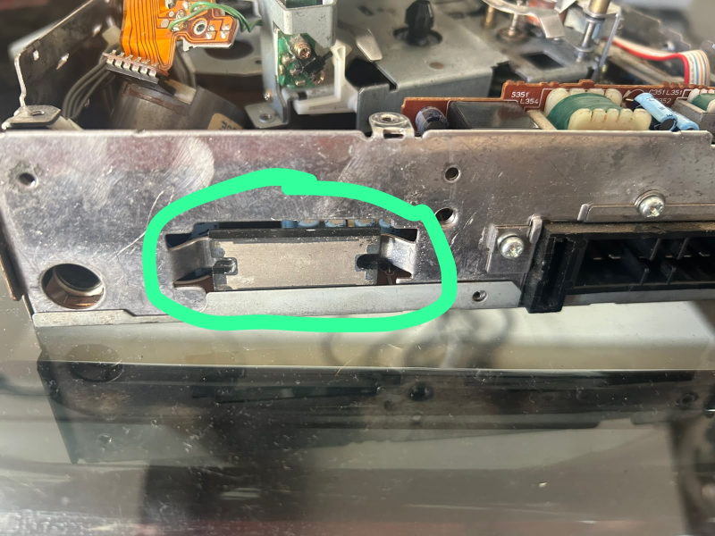

MagicJames Posted July 18 Posted July 18 You said your speakers are new and that it's all wired correctly. So if you have completely no sound, not even static, then its pointing towards the power amplifier. But you said you got the radio back from Jeremy so it should be good. I put a photo of the amplifer below circled in green, its behind the heatsink cover at the back. So if you want you can test it with a multimeter But first, I hate to go condemning the amplifier straight away, so check with one individual speaker buy placing a AA battery between negative and positive ends, it should crackle loudly when you connect it to a power source. Then make sure volume is all the way up, even try a casstette if you can. If it's still dead silence, then pull the heatsink at the back and test the amplifier chip, its a few small screws but they're different lengths so make sure you remember where each goes. If the chip doesn't look burnt, then put a multimeter negative probe on the ground and the positive probe on the output pin. Our radios take a 17 pin motorolla chip, we don't want this to show the full 12V, it should be about half so around 6V is good. I tried to take a picture for you but its hard holding the probes and the phone at the same time. If you get 12V at the chip speaker pins then the chip is closed and shorting the full battery power straight to your speakers. 0V means the chip is blown open. In both cases the chip is bad. I don't have the exact pin lay out for the chip on hand, its in my notes and i can get it for you. But I know pins 9 and 14 should be 12v main power and speaker pins should be about half that at 6v. I think pins 11/12 and 15/16 are the 4 speaker pins but i could be wrong. i hope this helps

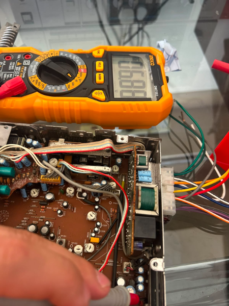

90BlackMJ Posted July 18 Author Posted July 18 This baby looks brand new in here. checking on the pin u have pictured to ground I have 5.48v and checking on the speaker pins on that chip I have the same. I'm not sure what the speaker outputs are supposed to read where the body harness plugs in, BUT checking between FEED and RETURN between each speaker I get ZERO.
MagicJames Posted July 21 Posted July 21 Sorry for the late reply. When you test the terminals at the speakers, the difference across them when sound is playing will be zero. When music is playing, the two speaker wires move in opposite directions, so as the feed rises, the return falls. To test the speaker, put the negative probe on the radio ground itself and you should get 4/5V at each speaker from the positive probe. As for the amplifier chip, i can't seem to find my diagram, but i went and tested a good radio I had for you to compare with. Below are the results at each pin. The circuit board itself is labelled for pin 1 and pin 17 so you know what direction to go in.
