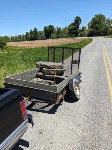

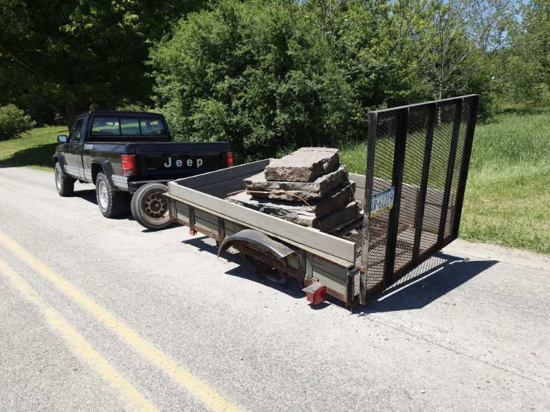

Picked up a few too many large rocks at the local landscaping place over the weekend.  Taking it careful home at 25 mph on the back roads, it felt like a tire blew on the trailer, I looked in the mirror and saw a wheel bouncing into the weeds.  Wheel broke off the axle at the factory weld.20260530_132022591.JPG.5ee0d9be53dc2cc85b848bfeb01b2fba.JPG
Drug the trailer about 40ft when it happened.

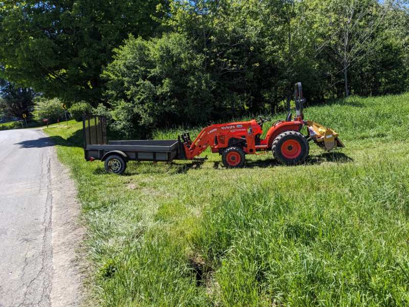

Luckily some friends lived nearby with a heavy duty trailer and a coworker happened to come up the road shortly after it all happened and offered his tractor with forks.IMG_20260531_174500.jpg.ce0b9336d0c9fc647ee4e4f7bb73a5ec.jpg

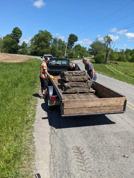

We wheeled the trailer on one wheel 500ft up the road to a friend of a friend of the guy that lent us the tractor.IMG_20260531_174455.jpg.e4a426b96fa8e6f51e7277039be22836.jpg

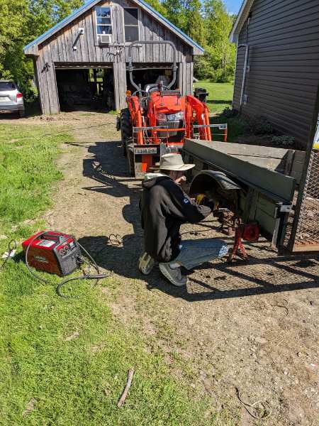

Guy was kind enough to let us leave things in his driveway for while so we could run and get all the welding equipment to put the wheel back on.

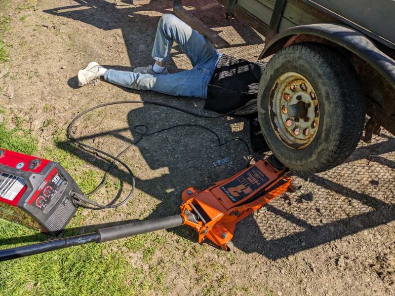

Trailer was safely mounted on jack stands for the repair.IMG_20260531_174448.jpg.97f939bffc99d0af936713a91b315118.jpg
