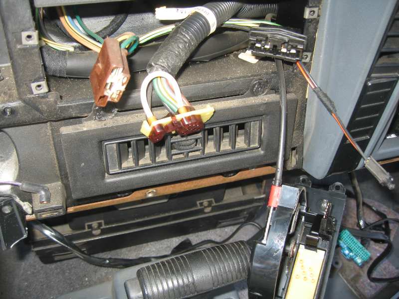

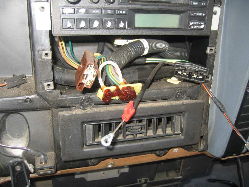

Gjeep Posted April 20 Share Posted April 20 What you have has the proper factory ends to it? And the retainer clip maybe 2" from one ends attaching point to the HVAC dash controller? I've never seen a solid factory wire on MJ/XJ, mine were always braided both with and without AC. Only reason I'd see the cable coming loose -- assuming it's factory -- is that retaining clip I'm talking about is broken or gone. In the early years, the retaining clip into the controller was black plastic but in 95/96 it was red. These pics are from a 95 XJ I was disassembling. That retaining clip on the cable is critical to keep the cable from falling off. There is also a retaining clip on the other end of the cable as well. These HVAC cables look to be available on eBay for $50. Link to comment Share on other sites More sharing options...
