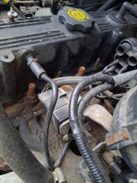

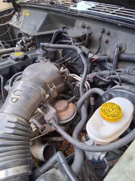

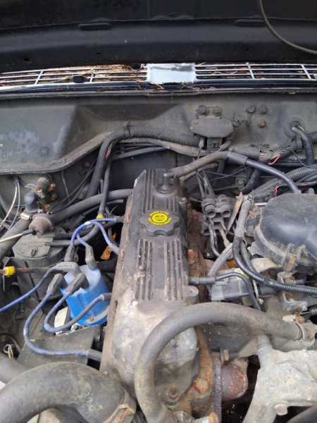

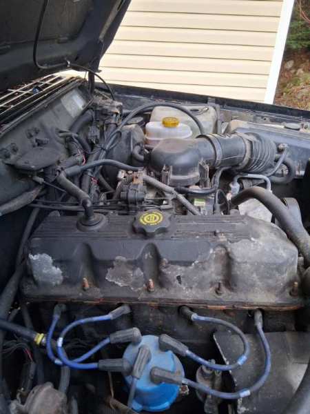

OldSch88L Posted May 11 Posted May 11 Hey buddy!!! I haven't been here in a couple of years since I moved and bought my first house, which has been getting all my attention... Anywho, I got back here today trying to find an old post I saw a while back about TJ clutch master cylinders and stumbled upon your post while trying to catch up on what's new here... So here's some pics for ya! It's a shame because I think the original composite valve cover looked better IMO, but at least my engine block stays dry now... The hoses are kinda just thrown together to make it work for the time being, because they looked tired and already planned to re-do them all anyways with new stuff. Hope this helps!!!
eaglescout526 Posted May 11 Author Posted May 11 40 minutes ago, OldSch88L said: Hey buddy!!! I haven't been here in a couple of years since I moved and bought my first house, which has been getting all my attention... Anywho, I got back here today trying to find an old post I saw a while back about TJ clutch master cylinders and stumbled upon your post while trying to catch up on what's new here... So here's some pics for ya! It's a shame because I think the original composite valve cover looked better IMO, but at least my engine block stays dry now... The hoses are kinda just thrown together to make it work for the time being, because they looked tired and already planned to re-do them all anyways with new stuff. Hope this helps!!! It does also you’re firing order is wrong.
OldSch88L Posted May 11 Posted May 11 10 minutes ago, eaglescout526 said: It does also you’re firing order is wrong. 11 minutes ago, eaglescout526 said: It does also you’re firing order is wrong. How'd you figure that? It's 1-3-4-2 isn't it?
eaglescout526 Posted May 11 Author Posted May 11 15 minutes ago, OldSch88L said: How'd you figure that? It's 1-3-4-2 isn't it? Oh shoot! I had to look again. My bad. The blue wires, 4 and 3 looked like they were wired wrong and threw me off.
OldSch88L Posted May 11 Posted May 11 15 minutes ago, eaglescout526 said: Oh shoot! I had to look again. My bad. The blue wires, 4 and 3 looked like they were wired wrong and threw me off. I almost wanted you to be right, because maybe it would've had explained it's lack of "oomph"!!!
eaglescout526 Posted May 11 Author Posted May 11 19 minutes ago, OldSch88L said: I almost wanted you to be right, because maybe it would've had explained it's lack of "oomph"!!! Lol!! My next question would’ve been if you have been lacking power lately. But I appreciate the pics, I’ll update that thread with your pics.
