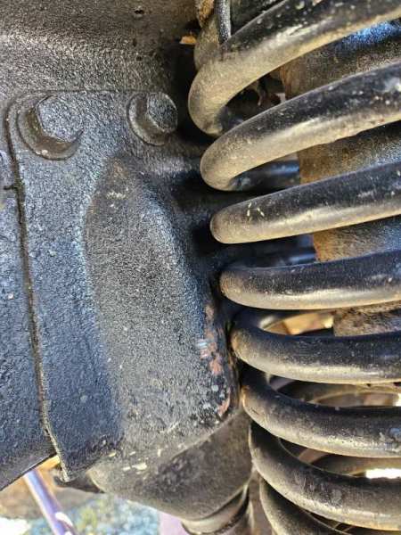

TheMaddTitan13 Posted April 8 Posted April 8 My 89 mj (i belive) has the cad dana 30(upgraded to cromely shafts and spartan locker, deleated cad) and I have a dana 35 in the rear. 1st question, is the cad dana 30 wider than the dana 35? Ive been trying to center my front axle and it seems like my front end is about 2 in wider than the rear. ( also my coil rubs on driver side even after centering, any tips to avoid that? Its the trackbar mount that it rubs on.) 2nd question, when I lift my rear and rotate one wheel, the other wheel rotates backwards. That indicates open differential, but everytime I spin tires both rear tires spin, on asphalt and offroad, is it possible it has the limited slip in the rear? Did comanche even offer lsd? (I havent poped the rear face off yet)
Pete M Posted April 8 Posted April 8 the axles are the same width, but the MJ has a wide butt and the bed is wider than the body at the front. got any pics of where the tire is rubbing? is it touching during flexing? turning? yes, the dana 35 could be had with a limited slip. anyone know if it's possible that a lunchbox locker would do that?
TheMaddTitan13 Posted April 8 Author Posted April 8 14 minutes ago, Pete M said: the axles are the same width, but the MJ has a wide butt and the bed is wider than the body at the front. got any pics of where the tire is rubbing? is it touching during flexing? turning? yes, the dana 35 could be had with a limited slip. anyone know if it's possible that a lunchbox locker would do that? The tire rub the control arm just alittle when fully flexed and turning. The spring rub is what concerns me.

Pete M Posted April 9 Posted April 9 10 hours ago, TheMaddTitan13 said: The tire rub the control arm just alittle when fully flexed and turning. The spring rub is what concerns me. what's the caster set to? was that photo taken when flexing? if so, can you snap a pic of that area when the truck is static?
