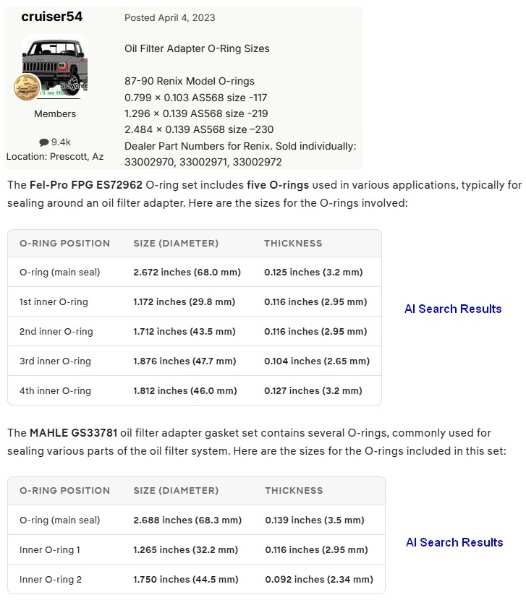

AnotherOldJeepGuy Posted March 3 Share Posted March 3 A little more digging.. I am not sure how to do apples-to-apples here, but assuming cruiser's infor is accurate and it probably is, it doesn't really look like either of these kits that claim to be correct are actually correct. At least not exactly correct. I have no idea how much play is allowed in these sizes for a fit that seals and wears correctly. And of course I am assuming here my web search was accurate for the comparison. Link to comment Share on other sites More sharing options...
hgeranium Posted March 3 Author Share Posted March 3 Just now, AnotherOldJeepGuy said: A little more digging.. I am not sure how to do apples-to-apples here, but assuming cruiser's infor is accurate and it probably is, it doesn't really look like either of these kits that claim to be correct are actually correct. At least not exactly correct. I have no idea how much play is allowed in these sizes for a fit that seals and wears correctly. And of course I am assuming here my web search was accurate for the comparison. Yeah I guess that’s what people were talking about having varying luck with them. How hard could it possibly be, fel-pro? Instead of making kits for each application (Renix and HO) they cut costs and make an all in one kit that fits neither of them lmao. Are you still going to try the kit? My o ring assortment comes in today so I will keep you posted this evening on my luck with that Link to comment Share on other sites More sharing options...
AnotherOldJeepGuy Posted March 3 Share Posted March 3 I ordered the Felpro kit cause I am on first name basis with my local Napa, and it was in stock. But when I go to pick up later today I am taking Cruisers list with me to ask if they can match them up. The Mahle was not listed at Napa, and was only listed as special order at O'Reilly so not ordering that at the moment. I am also going to email the local Jeep dealer with the Mopar numbers and see what they say. Link to comment Share on other sites More sharing options...
hgeranium Posted March 3 Author Share Posted March 3 5 minutes ago, AnotherOldJeepGuy said: I ordered the Felpro kit cause I am on first name basis with my local Napa, and it was in stock. But when I go to pick up later today I am taking Cruisers list with me to ask if they can match them up. The Mahle was not listed at Napa, and was only listed as special order at O'Reilly so not ordering that at the moment. I am also going to email the local Jeep dealer with the Mopar numbers and see what they say. Nice. It’ll be good to get an official answer for science! And for the good of 4.0 owners everywhere Link to comment Share on other sites More sharing options...

AnotherOldJeepGuy Posted March 3 Share Posted March 3 For what it's worth, well about $25, this kit on ebay has at least one review noting a perfect fit if your attaching bolt is not the torx version. I believe mine is not the torx version. If the other resources fail, I'll give this a shot. I have some luxury to leave the jeep disabled if needed for a short time since I have a second vehicle. Saw lots of this same part number for a little less. Link to comment Share on other sites More sharing options...
hgeranium Posted March 3 Author Share Posted March 3 2 hours ago, AnotherOldJeepGuy said: For what it's worth, well about $25, this kit on ebay has at least one review noting a perfect fit if your attaching bolt is not the torx version. I believe mine is not the torx version. If the other resources fail, I'll give this a shot. I have some luxury to leave the jeep disabled if needed for a short time since I have a second vehicle. Saw lots of this same part number for a little less. That’s interesting! I never would’ve thought it would be different based on what bolt you had, but I guess it makes sense that they’re separate parts with slightly different o rings. Link to comment Share on other sites More sharing options...
