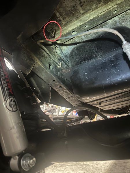

Ricky8227 Posted February 26 Share Posted February 26 I’m previous owner swapped a 8.8 in. And I notice this brake line is cut and slowly dripping.. brakes work but where was this line suppose to go? And how should I fix it? Link to comment Share on other sites More sharing options...
Pete M Posted February 26 Share Posted February 26 did they swap in a regular prop valve up front? Link to comment Share on other sites More sharing options...
Eagle_SX4 Posted February 26 Share Posted February 26 One of those lines is the emergency bypass line for the rear brakes. Originally there was a weight biased proportioning valve bolted under the bed. With a rod down to the axle to adjust the rear brakes based on weight in the bed. There are several ways to remove and bypass the valve. Some put a plug in the distribution block for the emergency bypass line. (easiest option). Others like me have replaced the distribution block with an adjustable proportioning block. (requires new hard brake lines front to back) Link to comment Share on other sites More sharing options...

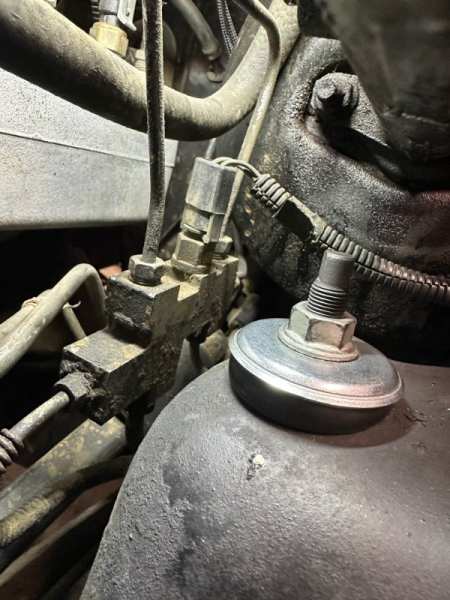

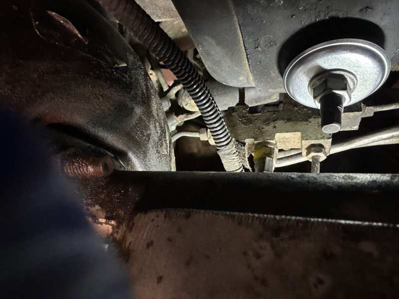

Pete M Posted February 26 Share Posted February 26 snap us a couple pics of the part under the hood that looks like a proportioning valve. if you still have the original combo valve, then you'll need to plug the bypass line output. if you have an XJ prop valve swapped in, then there's nothing to plug and that line that's dripping likely leads no where and it's just dripping the fluid that's trapped inside. how well does the truck stop if you step hard on the brakes? Link to comment Share on other sites More sharing options...
Ricky8227 Posted February 27 Author Share Posted February 27 14 hours ago, Pete M said: snap us a couple pics of the part under the hood that looks like a proportioning valve. if you still have the original combo valve, then you'll need to plug the bypass line output. if you have an XJ prop valve swapped in, then there's nothing to plug and that line that's dripping likely leads no where and it's just dripping the fluid that's trapped inside. how well does the truck stop if you step hard on the brakes? Link to comment Share on other sites More sharing options...
Ricky8227 Posted February 27 Author Share Posted February 27 Just now, Ricky8227 said: Sorry don’t why it posted the second pic upside down Link to comment Share on other sites More sharing options...
Eagle_SX4 Posted February 27 Share Posted February 27 It looks like both rear brake lines are still hooked up to the distribution block so you will need to delete the emergency bypass line. It is most likely the one that was cut and is leaking. However with that being said whoever swapped the axle in didn't do a great job by only cutting the line. I would trace your brake line all the way to the back and make sure the proper one is hooked up to the forward most port on the distribution block. Also it looks like your leaf spring is bent in this photo. Near the front eyelet. On 2/25/2026 at 7:08 PM, Ricky8227 said: Link to comment Share on other sites More sharing options...
AZJeff Posted February 27 Share Posted February 27 As someone who has deleted the load valve assembly, I will make an important comment about the current state of the brake tubing in the OP’s first photo: There is a LONG section of tubing that hangs out, unsupported, from where it is clipped to the “frame” rail until it joins the flexible hose the goes down to the axle housing. Leaving this tubing to flop around unsupported is inviting a fatigue failure cracking off the tube at some point. Ideally, some sort of bracket should be employed to attach the tube to the chassis right at the junction Of the flex hose and the tube. This is way the factory did it. Link to comment Share on other sites More sharing options...

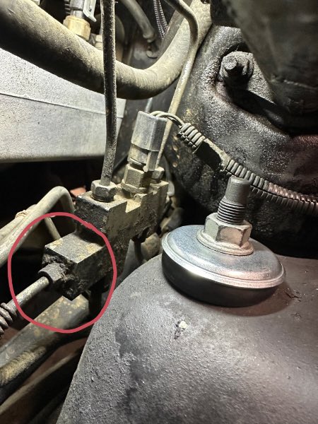

Ricky8227 Posted February 27 Author Share Posted February 27 10 hours ago, Eagle_SX4 said: It looks like both rear brake lines are still hooked up to the distribution block so you will need to delete the emergency bypass line. It is most likely the one that was cut and is leaking. However with that being said whoever swapped the axle in didn't do a great job by only cutting the line. I would trace your brake line all the way to the back and make sure the proper one is hooked up to the forward most port on the distribution block. Also it looks like your leaf spring is bent in this photo. Near the front eyelet. So the main brake line in the back should be hooked up to this part that circled? Link to comment Share on other sites More sharing options...
Eagle_SX4 Posted February 27 Share Posted February 27 Yes, and the port on the front port on the bottom needs to get plugged. Link to comment Share on other sites More sharing options...
