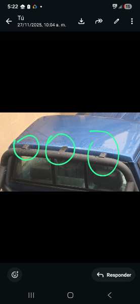

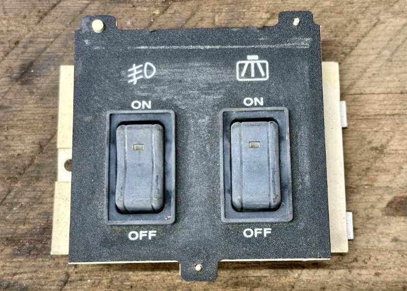

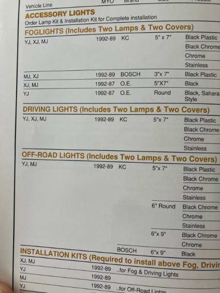

Carlos30 Posted 11 hours ago Share Posted 11 hours ago Hi i have seen many opinions of which brand and size were the original fog lights of jeep comanche and i have seen that they have very diferent information, some say they were diferent brand used in the bottom front defense than the one used in the roll bar. Some one say the brand of the lights on the roll bar were " ROL" other says "KC" and some others "marchall" They were trucks from factory with both fog lights? In bottom front and roll bar? Which were the original switches? I have seen the swithes only have two dashes one for turning cargo and one for fog light so if they have the two fog lamps options how they turn it on? With the same dash? Please excuse my lack of knowledge, I hope my question was clear. Thank you. Link to comment Share on other sites More sharing options...
Eagle_SX4 Posted 9 hours ago Share Posted 9 hours ago The switch was on the right side of the steering column. Link to comment Share on other sites More sharing options...

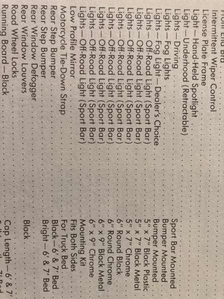

fiatslug87 Posted 6 hours ago Share Posted 6 hours ago Brand depends on the year. In general the AMC years were Marchals for rectangular ones and I think KC for round. Chrysler years had several including ROL which is not listed in their ‘92 catalog. Pics of the ‘88 and ‘92 catalogs, respectively. Link to comment Share on other sites More sharing options...
