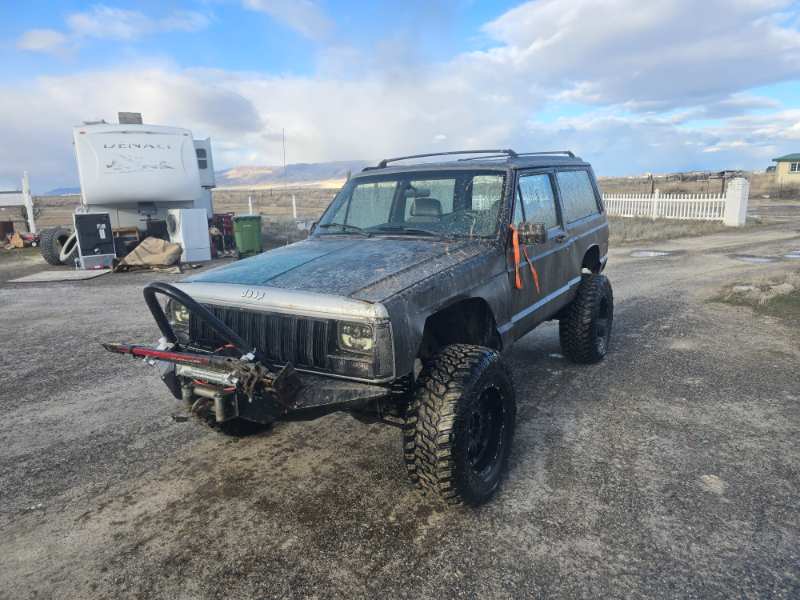

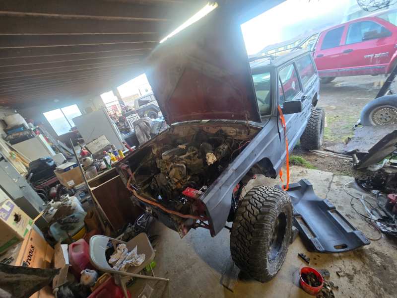

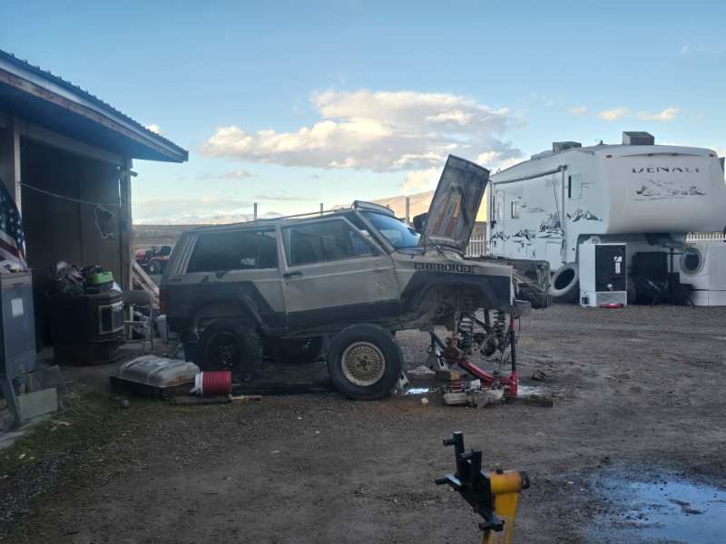

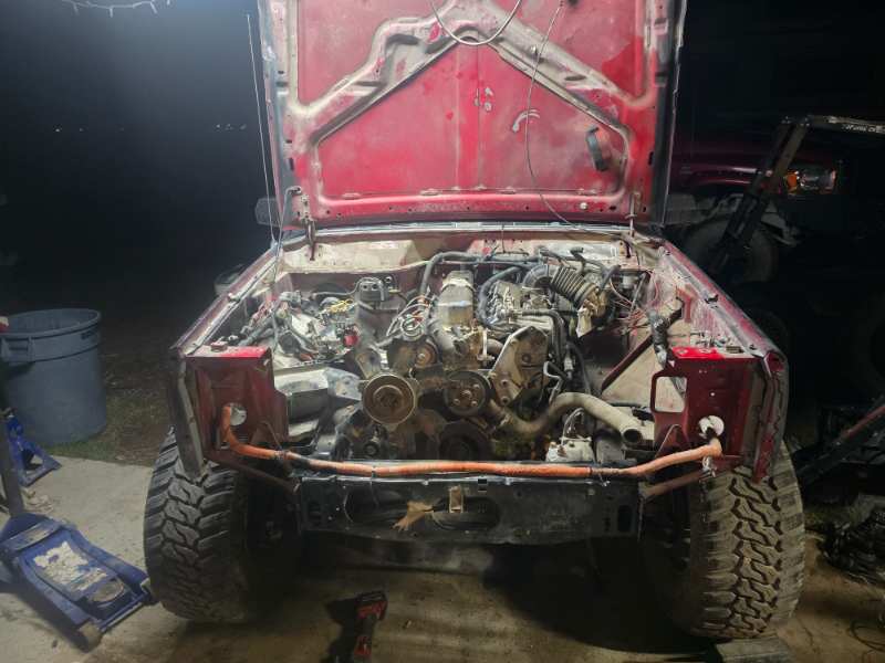

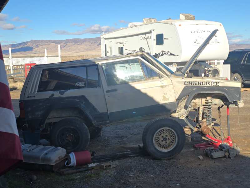

Rebel87 Posted January 23 Share Posted January 23 So my 87 2 door renix xj got totalled, buckled the firewall and the unibody in multiple spots. I had a 94 2 door sitting so it has now become my new build, the previous owner hacked up the engine harness. I almost had the 87 running perfect so i figured swap everything to the 94, using the renix ecm and engine harness connected to the 94 fuse block at the firewall. Its been an adventure thus far, had to drill some holes and rewire some connectors. First 2 pics are the 87 last 2 are the 94. Link to comment Share on other sites More sharing options...

Rebel87 Posted February 7 Author Share Posted February 7 So far making the 94 fuse box wiring and the 87 engine harness at the c100 connector match up has been tedious but it finally done, actually to be honest there werent too many wires that had to be switched 🤯, the hardest part was finding pinouts for the c100 connector for both years to compare the wire paths. Link to comment Share on other sites More sharing options...
