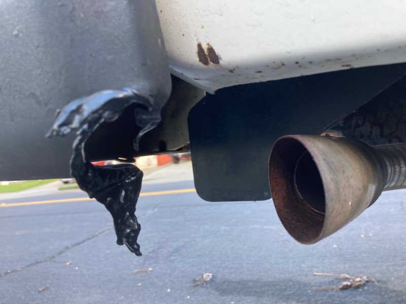

fiatslug87 Posted January 7 Posted January 7 When your exhaust tip rattles loose and points towards the bumper end cap.  I’ll be replacing this one with one from the Happy Camper.
llhat Posted January 7 Posted January 7 increase extension of tip out of body line....  just increase distance... those end caps are not 'that' plentiful to melt away
fiatslug87 Posted January 7 Author Posted January 7 I like it tucked in, I will either replace the set screws with sheet metal screws that actually penetrate the tail pipe so it can’t rotate or get a better tip, probably the latter.

fiatslug87 Posted January 22 Author Posted January 22 14 minutes ago, hgeranium said: That's some high quality pipeage It’s just a cheap $20 tip with integrated clamp, it will probably rust within the year. I just want the exhaust gases away from the end cap, I only have two more replacements.Â
