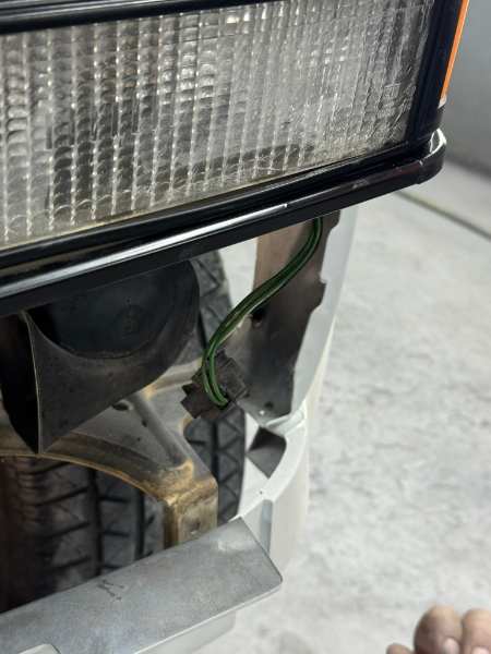

JimiGibbs Posted Thursday at 01:38 AM Share Posted Thursday at 01:38 AM Drivers side front below the headlights..... Is it an extra plug from the harness for fog lights? Link to comment Share on other sites More sharing options...
Ωhm Posted Thursday at 12:16 PM Share Posted Thursday at 12:16 PM Is it possible you have a XJ Wagoneer Front Lighting Harness (FL) installed? Is there another connector, similar to this, on the other side? Wagoneer’s have dual beams, per side, for headlamps. Link to comment Share on other sites More sharing options...
87MJTIM Posted Thursday at 12:48 PM Share Posted Thursday at 12:48 PM headlight harness upgrade? With the upgrade, the passenger side factory plug goes unused. Link to comment Share on other sites More sharing options...
JimiGibbs Posted Thursday at 01:02 PM Author Share Posted Thursday at 01:02 PM 45 minutes ago, Ωhm said: Is it possible you have a XJ Wagoneer Front Lighting Harness (FL) installed? Is there another connector, similar to this, on the other side? Wagoneer’s have dual beams, per side, for headlamps. It's possible.... I'll have to do some checking when I get it back from the painter. THANKS Link to comment Share on other sites More sharing options...
